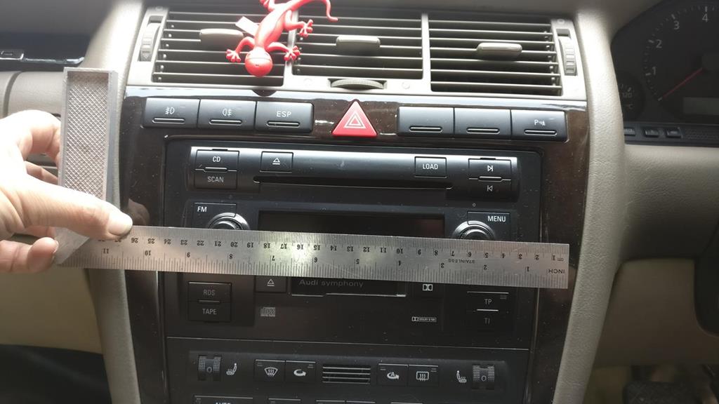

Its an impressive piece of kit, but unfortunately far too tall for the D2 dash at 262wx181h, and would obscure all of the upper switches and the top of the hvac controls
Even if the top switches were relocated you'd still lose seat heaters, windscreen demist and recirculate from the hvac.
Something similar with an 8" screen would probably be doable. As you noticed though, the Kenwood seems to be the only one with a proper volume button which is so annoying. Also, none of the other vendors of these floating screen units appear to be inclined to show dimensions of the actual panel so its hard to determine what would and wouldn't work.

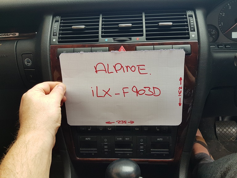

Well then I thought the Alpine iLX-903:
https://www.alpine.co.uk/p/Products/...View/ilx-f903d
might be worth a compromise. No control knob for volume but I found in the manual that you can change the button colour background and turn the white backlighting off, though whether the button background colour is an 'Audi red' remains to be seen.
Im just getting 'hung up' on the floating dash design.
Its a shame the vertical adjustment isnt motorised eh MJ?

Also a fairly impressive machine, although a shame it doesn't have a high definition screen like the Kenwood. Given the amazing displays available for phones and tablets I remain disappointed that most of the car audio manufacturers are still using 480p
At least the Alpine has a mute button to make up for no volume knob, although are they actually buttons? "touch-responsive hard-keys" implies they're just sensors, not actual switches.
Floating displays are a reasonable way to get more real estate than a simple double-din, but most of them seem to assume there is nothing else important around the head unit and no one seems interested in a wide-format version, which is the one dimension in which we have plenty of room
