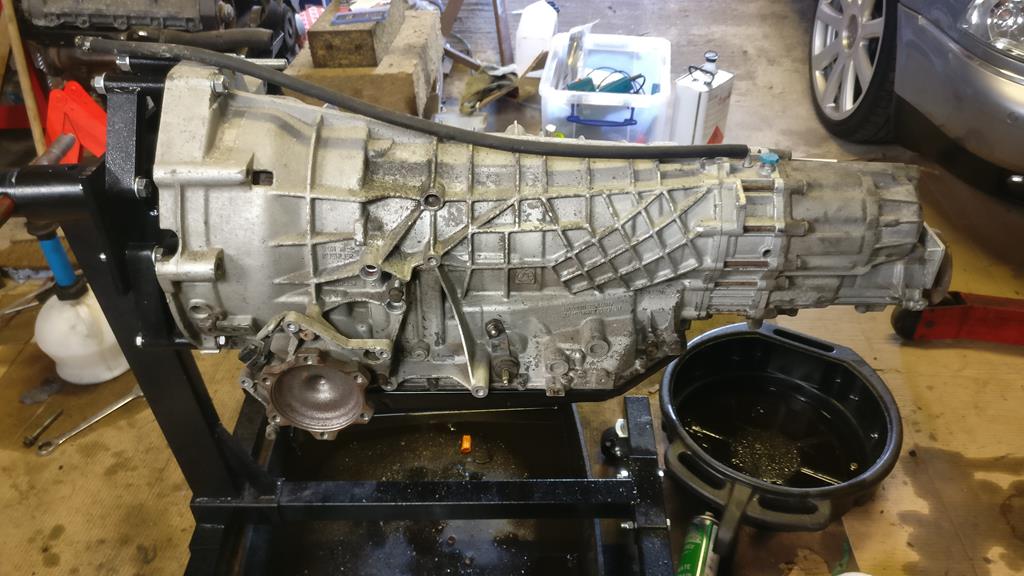

Remember how the Murple's mangled gearbox was missing its sump magnets?
I found one of them stuck to the torsen diff
I've dismantled the tail section of the dead gearbox to fit the casing to the PF's gearbox in order to solve the broken brackets, so this bit will get cleaned up and swapped over.

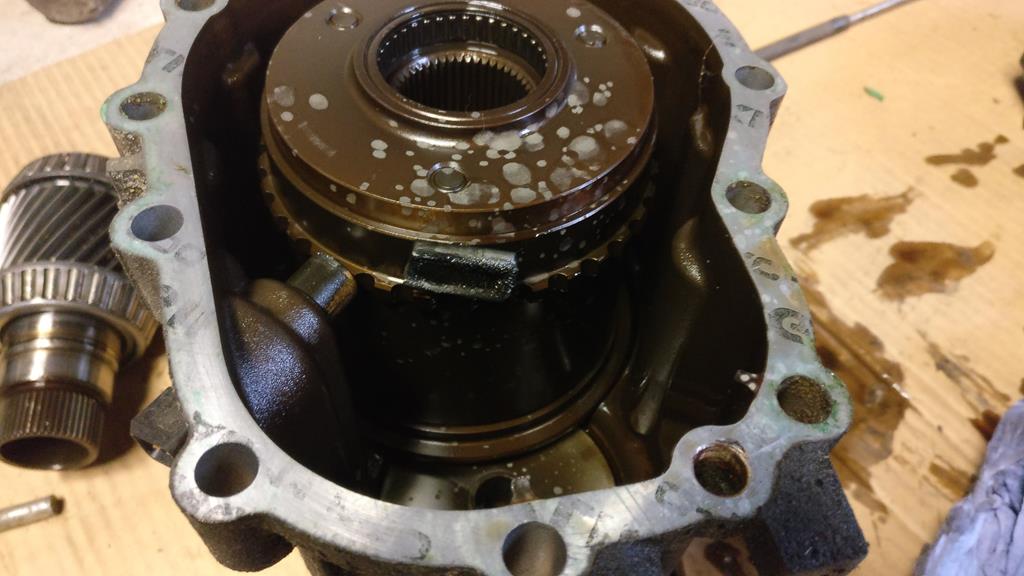

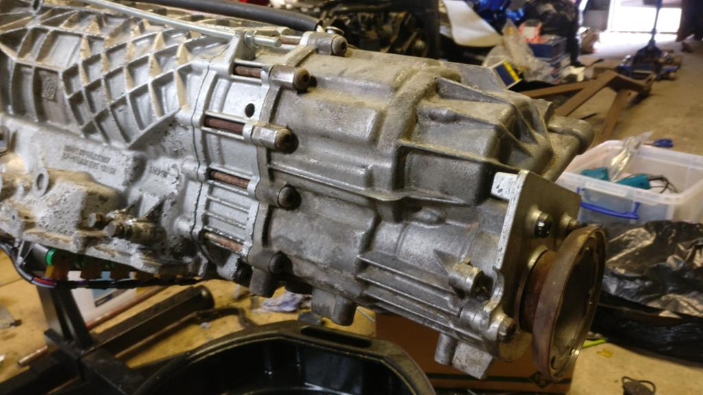

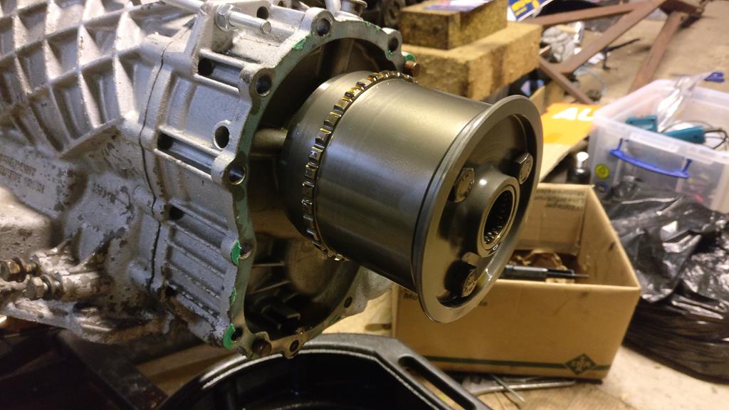

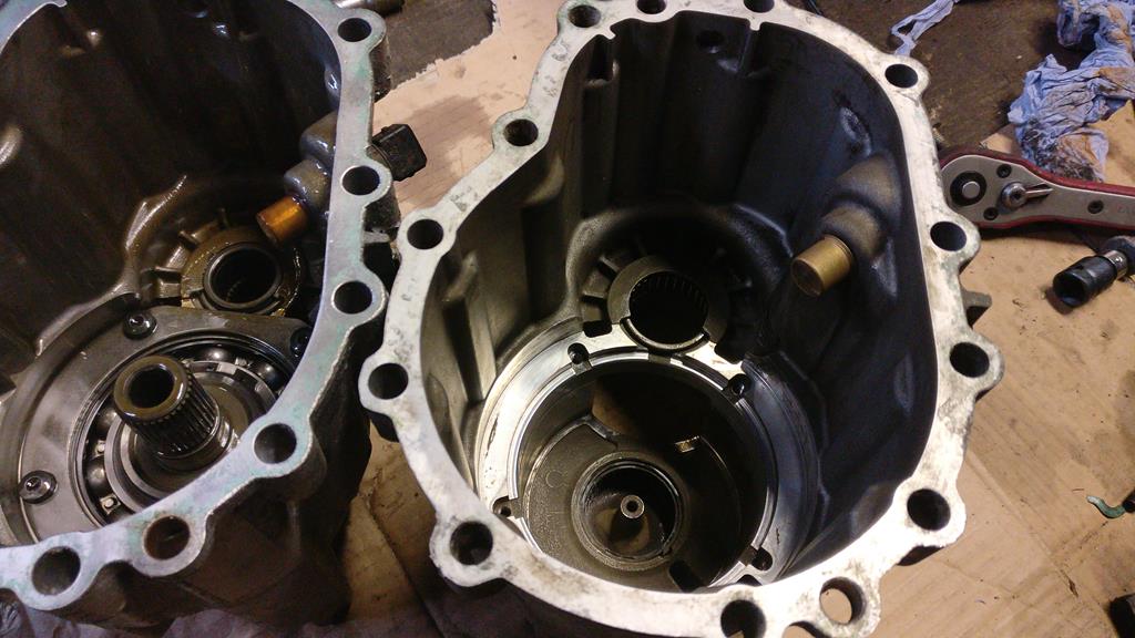

Further investigation has revealed that there is a slot in the casing for a magnet in the rear diff housing so I suspect that the magnet fell out of the slot while I've been moving around the dismantled bits of the gearbox, and it stuck to the nearest steel thing which was the torsen diff. The three from the ATF sump are still missing.
Certainly whoever 'rebuilt' the murple gearbox never bothered opening the rear casing or replacing the bearings as they are very loose.
The torsen housing coming off the PF box:
Nice clean torsen. You can see the slot for the magnet directly at the bottom of the casing. The magnet is still in place in this one.

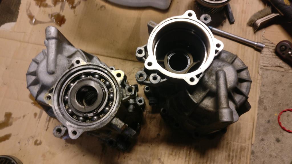

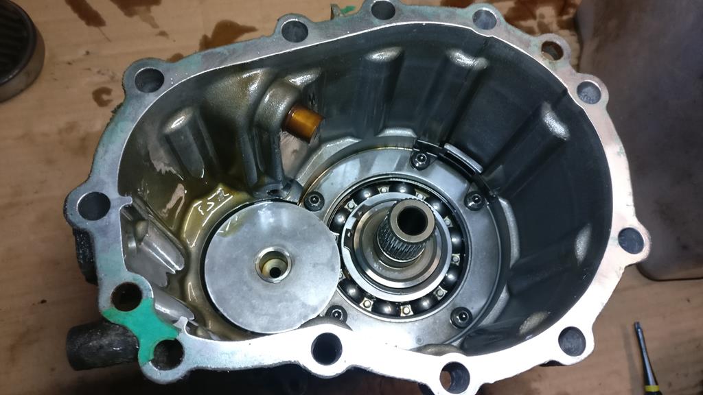

PF end housing on the left, murple housing on the right. You can see the two bosses on the right hand one which have been broken off the left hand one.

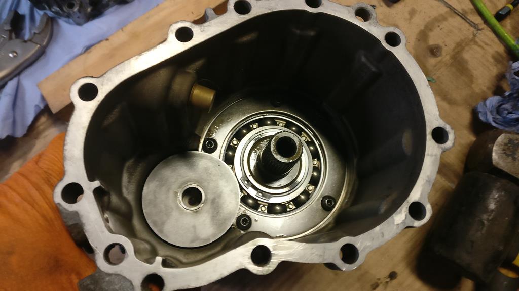

320k mile never-opened casing with bearings and spur gears removed.
100k mile probably-opened casing with the bearings still in place. These will all be swapped in to the murple's casing and reassembled.

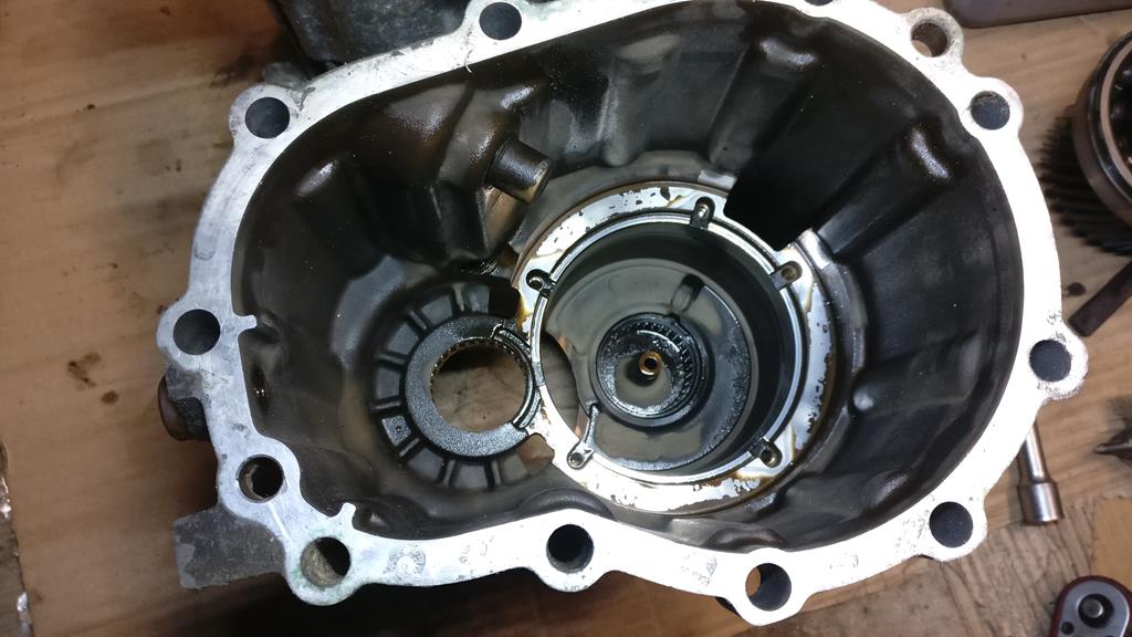

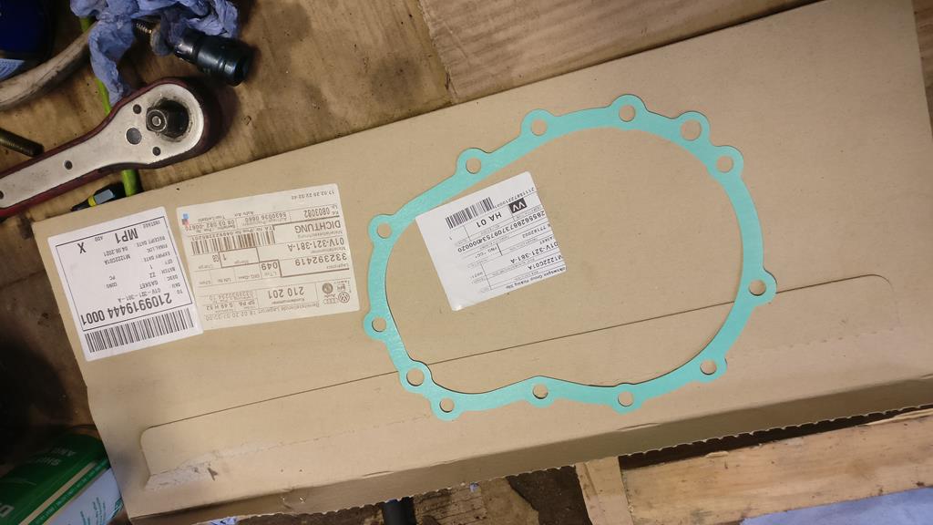

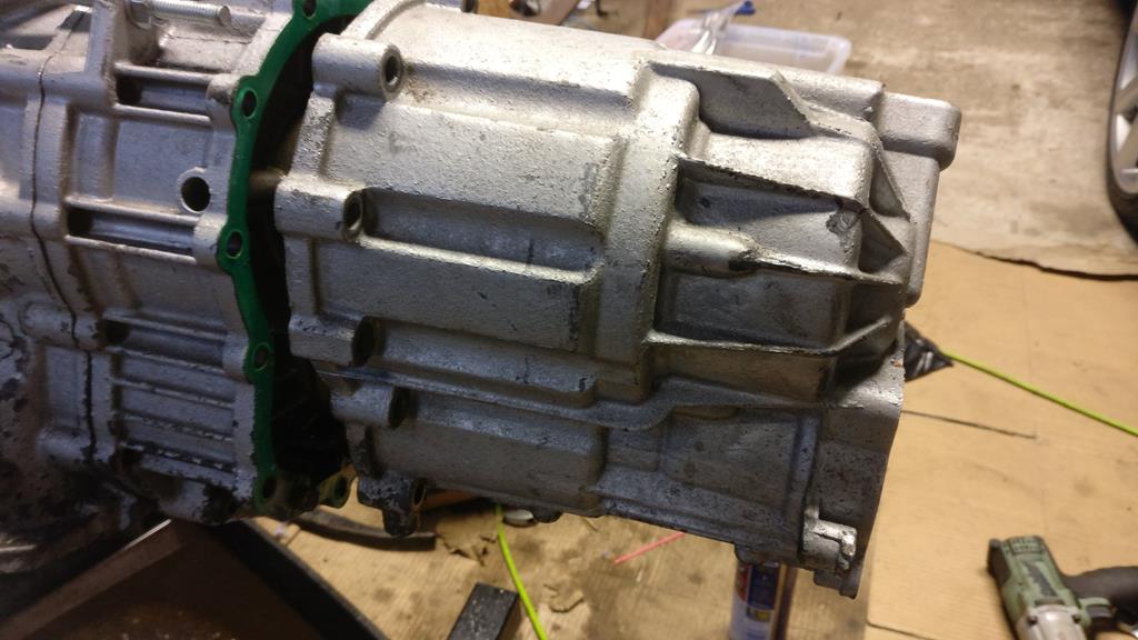

Cleaned up the torsen housing
Swapped the bearings and spur gears over
New gasket - amazingly, this was in stock at Milton Keynes so came overnight

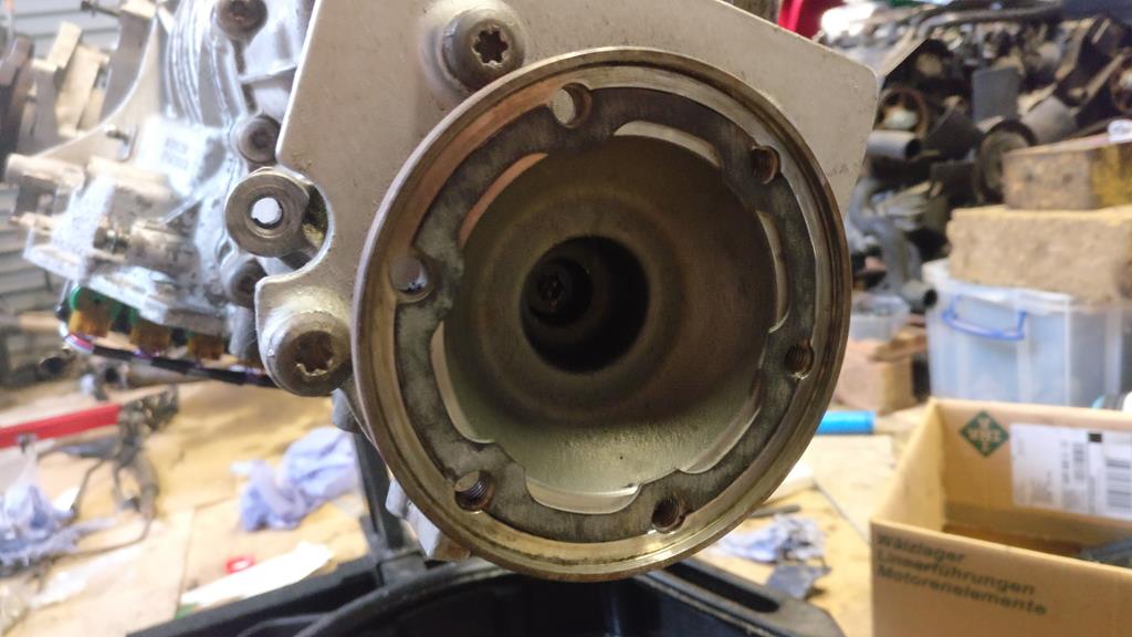

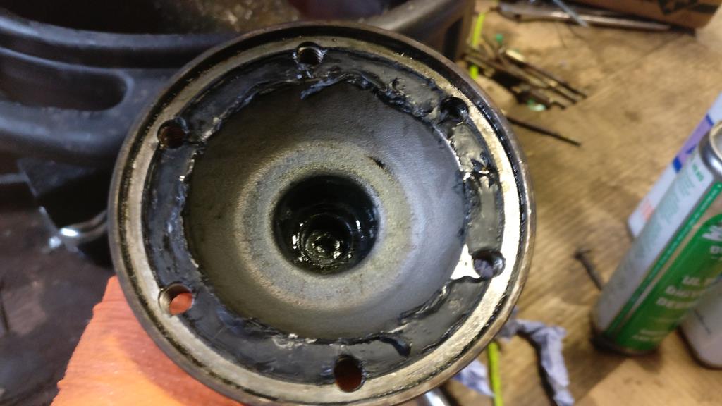

The output flange should have a rubber gasket. Bizarrely, whoever put this gearbox back in used silicone sealant instead
Thats better
Torsen housing back together

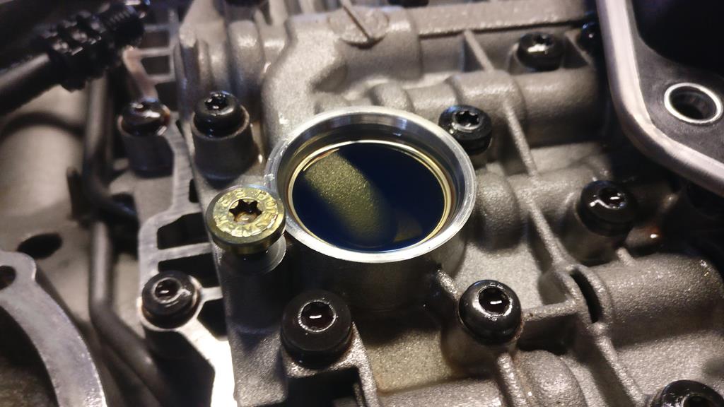

Flipped it over and primed the oil pump with new Mannol AG52 oil. I did the filter as well but forgot to get a pic.

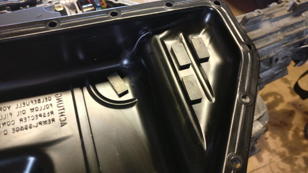

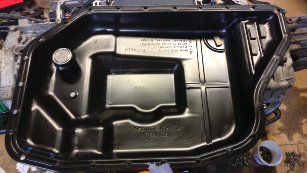

Nearly-new sump
Where the magnets should be
Sump back on and oily bits finished

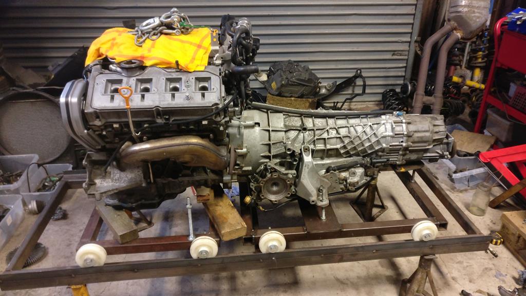

Engine and gearbox reattached at last. I don't have engine mounting brackets for the 32V so the engine is sitting on carefully calibrated lumps of carbon-foam composite

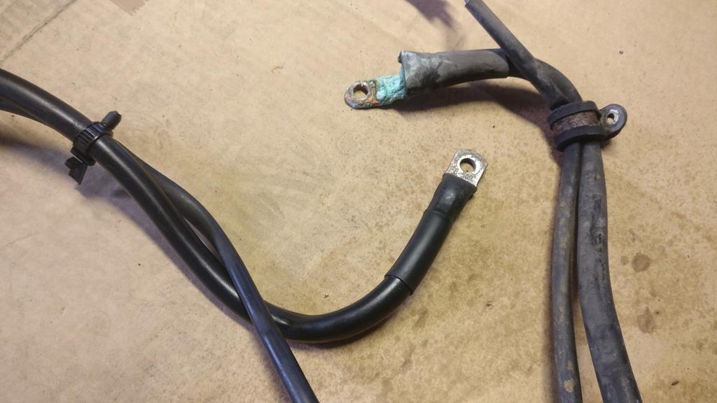

Replacement starter cable compared to the original

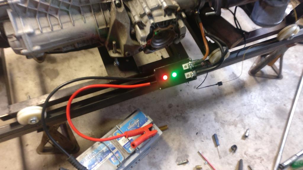

Once the starter was back on I filled the engine with oil and spun it over with the magic box until it got oil pressure

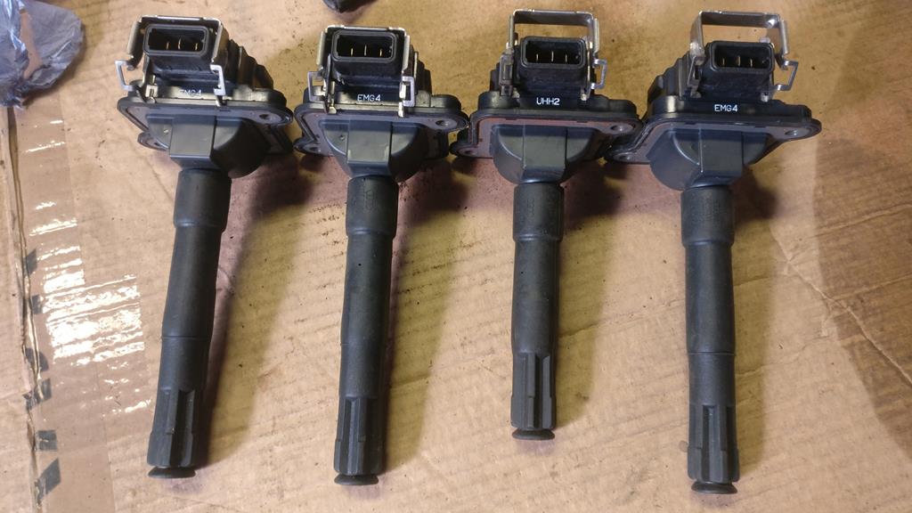

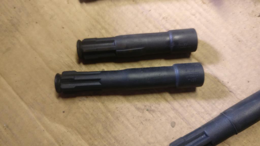

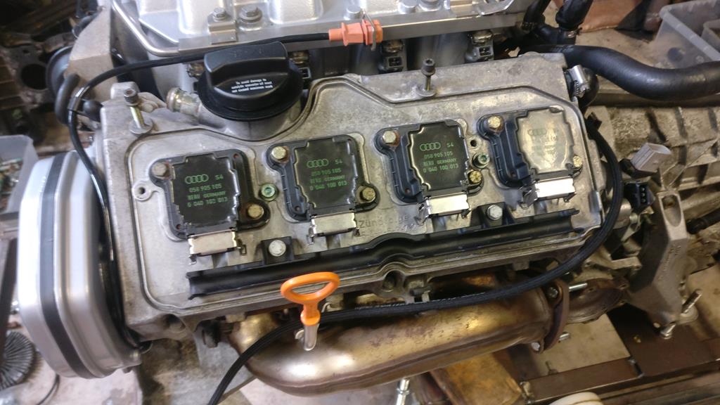

One of these is not like the others The short coil is the right part number but from a different batch to the others so it has been replaced at some point, but had the wrong spark plug connector attached to it. Surprisingly the engine seemed to run fine, even though this coil wasn't touching the plug
Luckily I have a box of spare coil packs so replaced the short one with the correct part
Spark plugs and coil packs back in.
