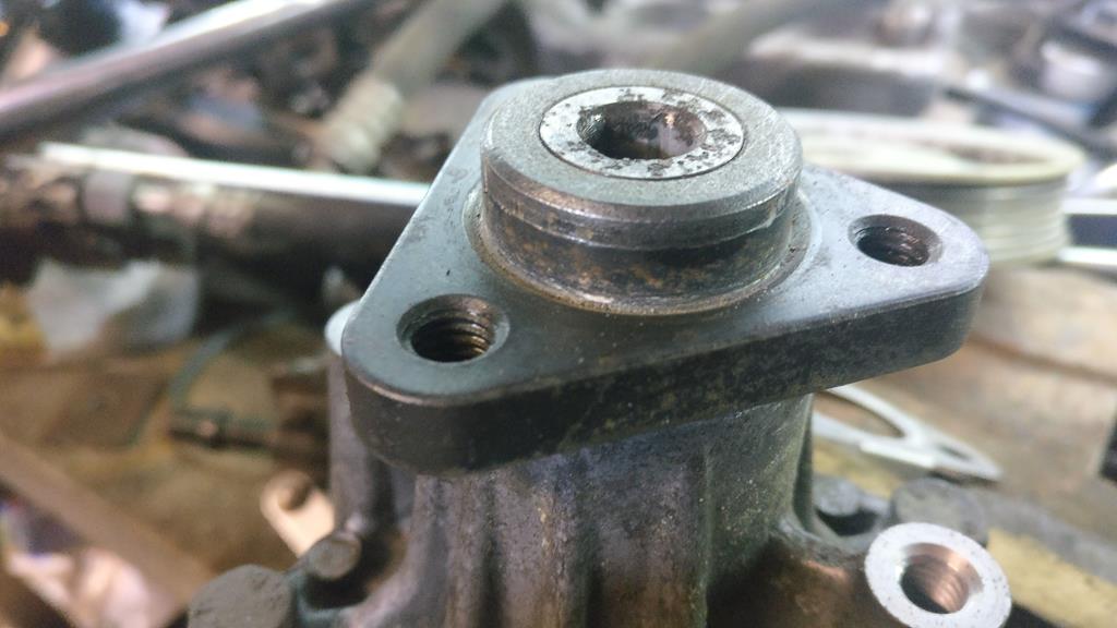

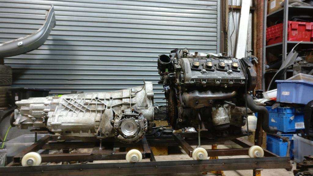

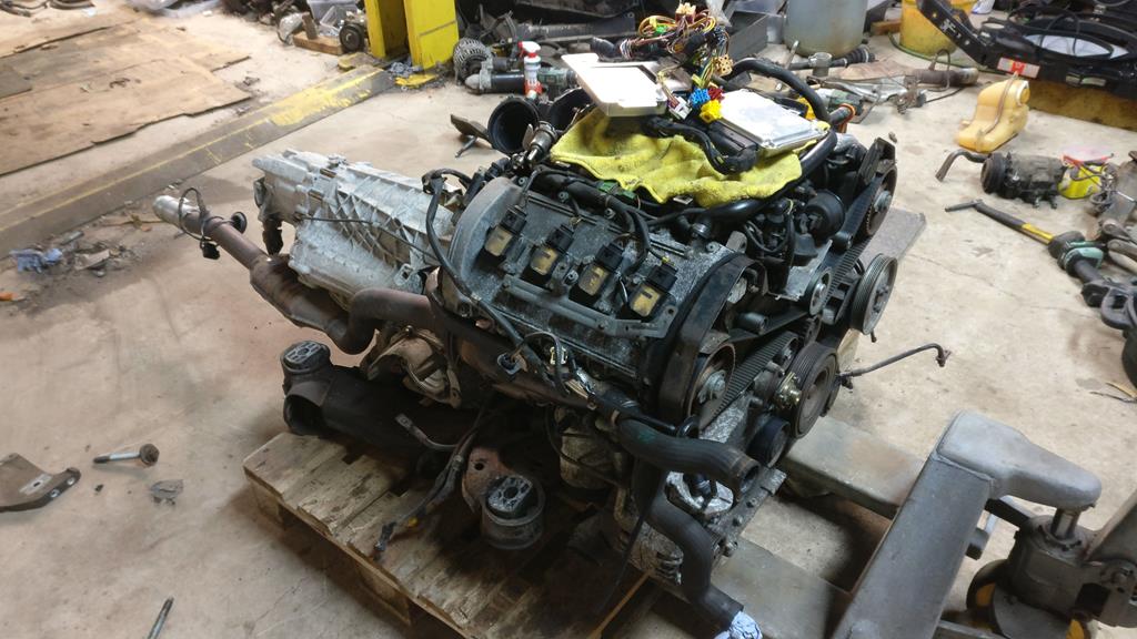

Engine out:
Started stripping everything off. The power steering pump will sit in evaporust for a while to hopefully allow the pulley to be removed from the hub
On the separating table
Easy as that

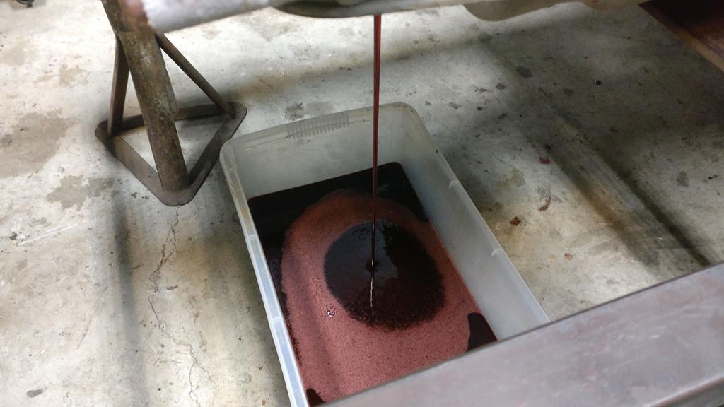

Red atf Not that the 5HP cares, given that the murple did 20k on diff oil Still, I'll put the proper stuff in it.

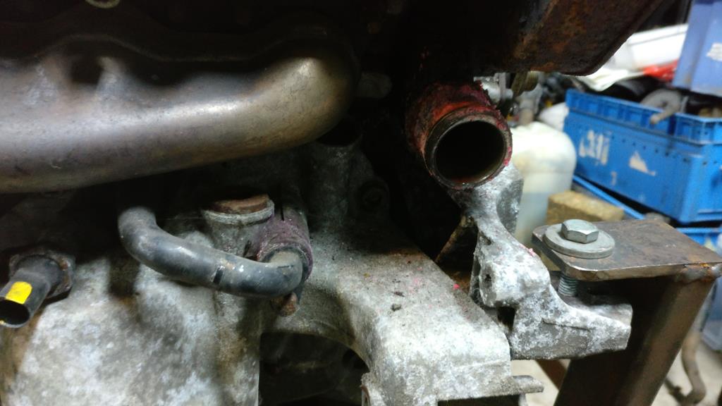

There's some crust around most of the coolant connections so all of these will get cleaned and the hoses & o-rings replaced.
I left the engine and gearbox to drain overnight. They'll go on stands and start coming apart tomorrow

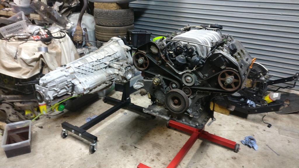

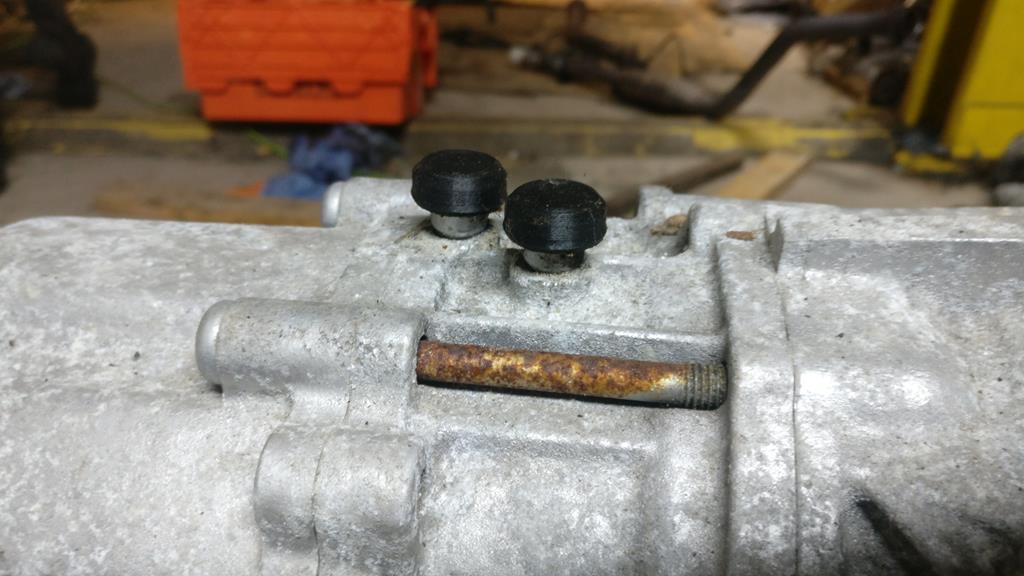

Getting the gearbox ready for its service. As it has been 'recently' refurbished, I don't plan on draining the diffs - the oil in them is nice and clean. However, if I flip it over to do the sump and filter all the oil will dribble out of the vents. That is solved with some 3d printed polyurethane bungs

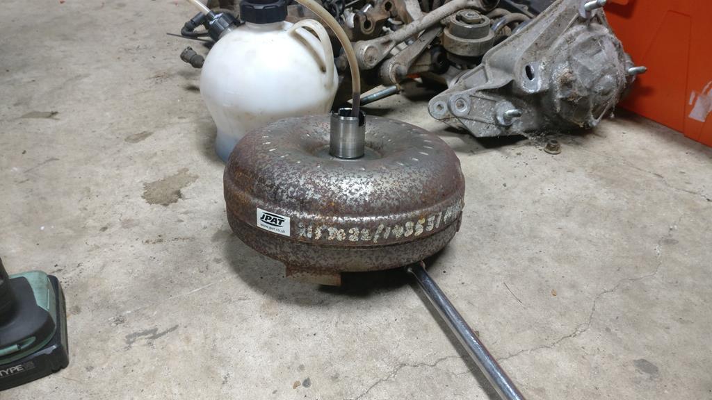

The torque converter was rebuilt by JP Automatics in Bristol, which is a good sign

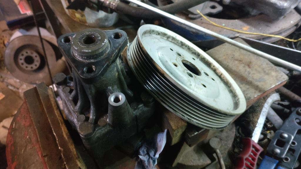

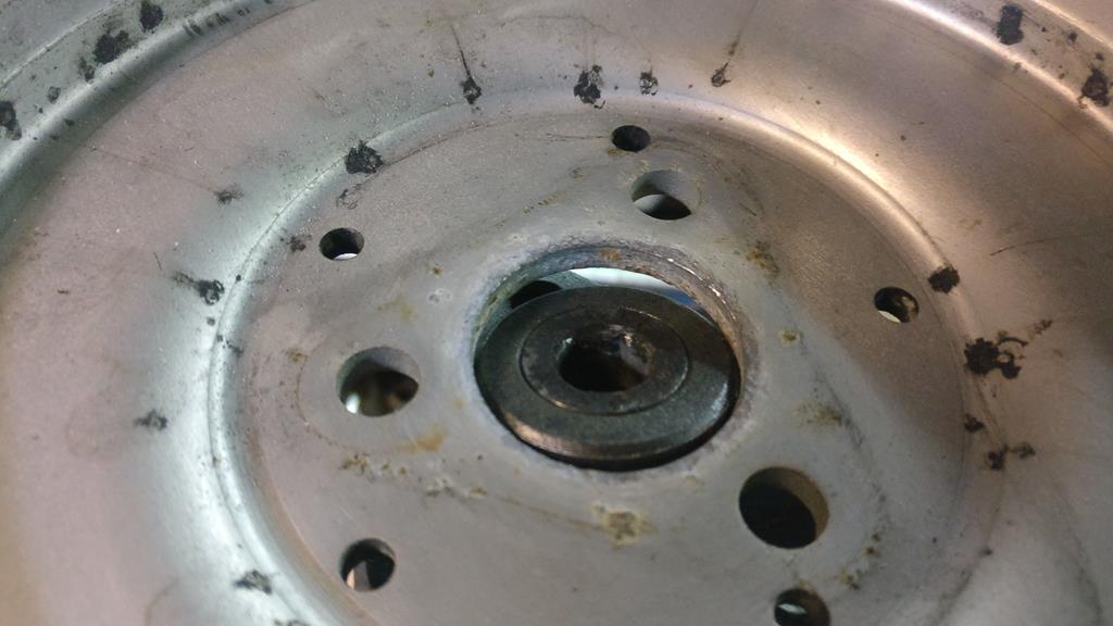

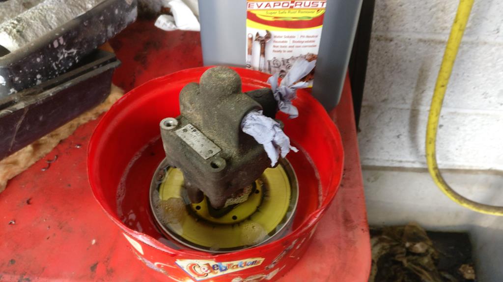

After sitting in Evaporust overnight, the power steering pump relinquished the pulley with a little help from the bearing puller and the mapp torch
The hub cleaned up nicely
A little corrosion on the pulley is easily dealt with

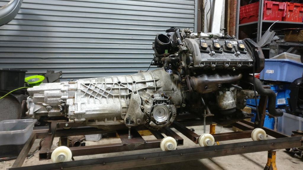

Engine and gearbox ready for shenanigans
