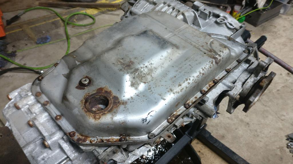

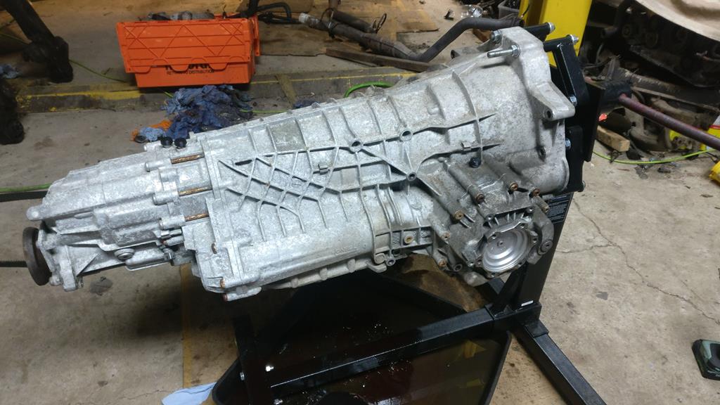

Gearbox... Why do people feel the need to sandblast these things? The end user is never going to see it, so why waste time trying to make it look 'new'? The end result is always that the steel parts just go rusty so it looks worse than ever

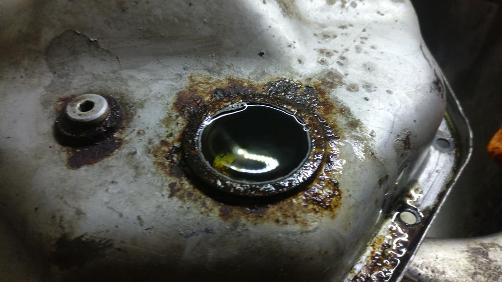

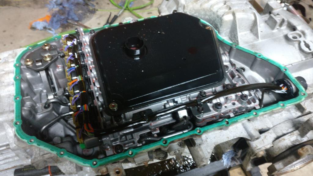

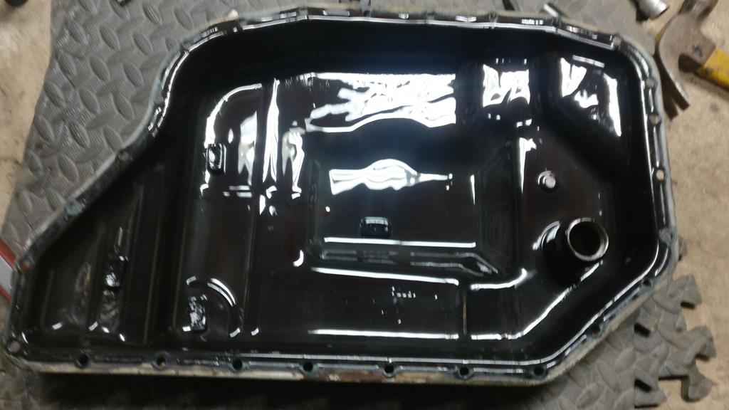

At least the pan is clean inside. This will go off to get powdercoated.
Nice and clean inside, albeit the wrong colour

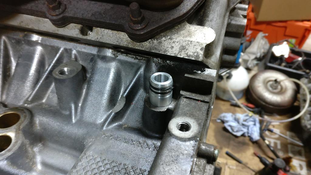

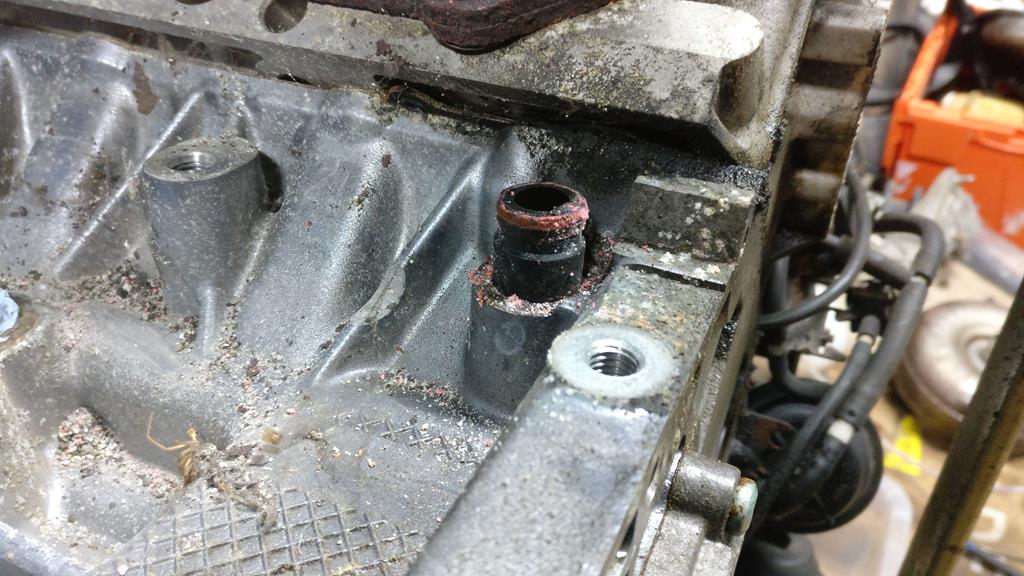

I've filled the sump plug / fill tower with evaporust to clean this area up before it gets sandblasted, since trying to blast in here will be very difficult
Left to drain overnight. I won't be able to get all the red atf out, but I'll get enough

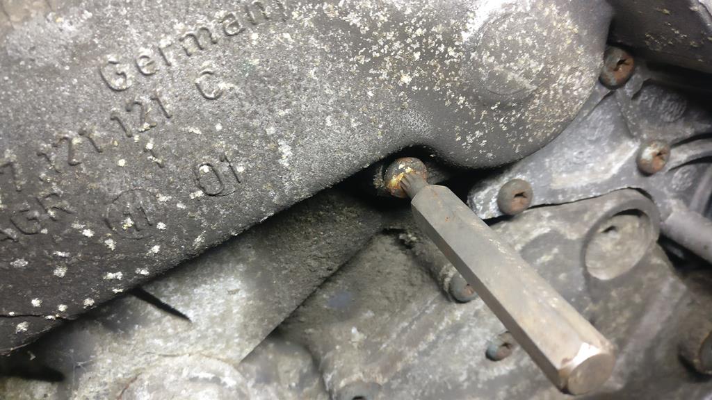

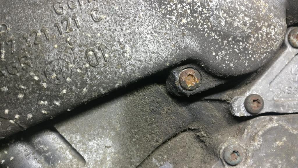

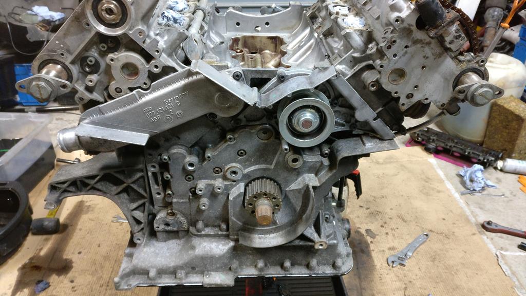

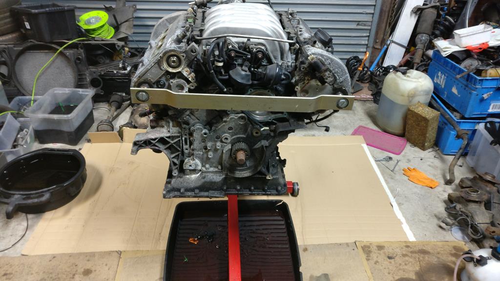

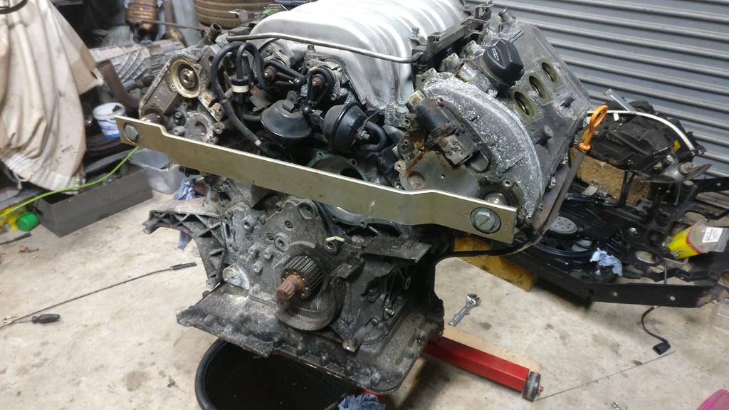

On to stripping the engine. Talking of stripping, the first thermostat bolt stripped as soon as I touched it
Luckily an M6 spline hammered in to it cracked it loose. These will all be replaced anyway
This engine is remarkably dry, which is nice. A little weep from the usual upper gaskets, but nothing from the crank or sump.
Most stuff removed. I'll flip it over and get the manifold and sump off tomorrow

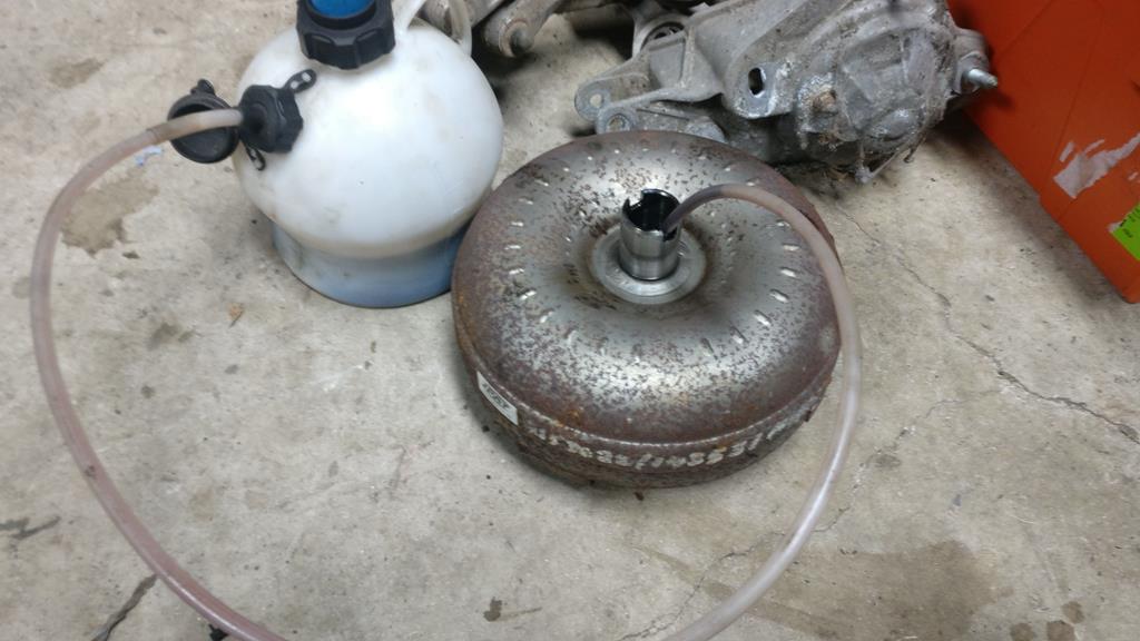

Each time I pass the converter I give a few pumps on the oil extractor, to get as much of the red atf out of this as I can too

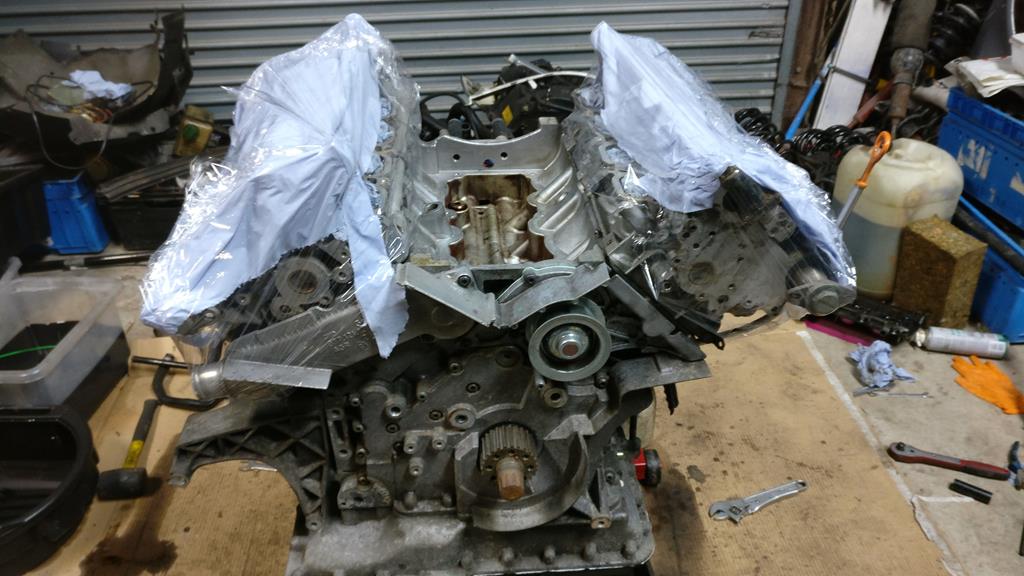

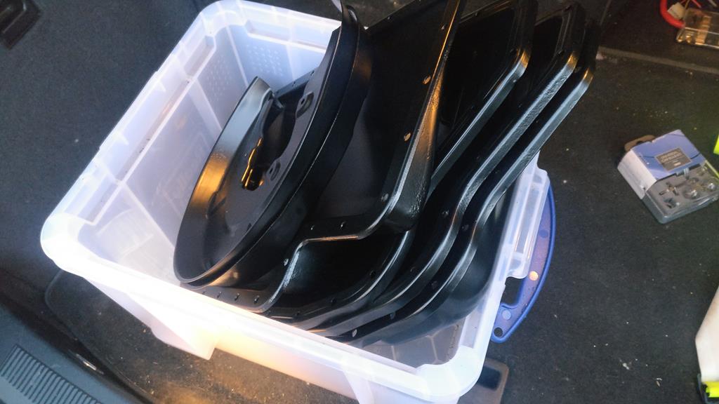

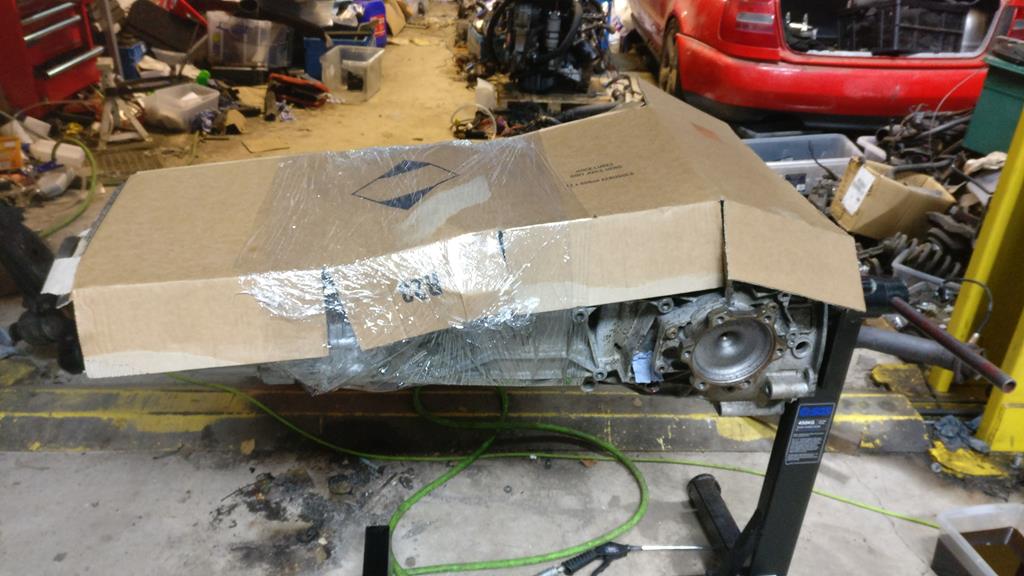

The gearbox sump needs powdercoating before, so I wrapped it up in cardboard and pallet wrap to stop schmutz getting in. Kersteman garage would probably just put this back in the car and send it
Cardboard down ready for cleaning the engine

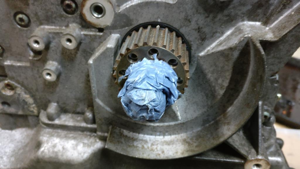

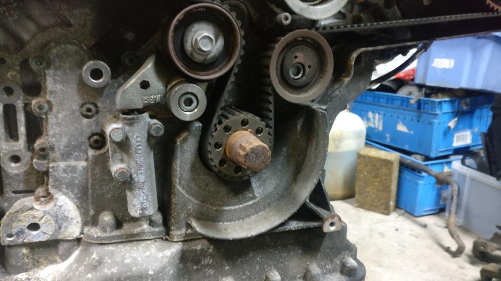

After cleaning the front of the engine I wrapped the crank sprocket bolt in blue roll and soaked it in Evaporust to clean it up as bit as it was quite rusty. This worked perfectly, but I didn't get an after pic
The sprocket isn't coming off as the seal is fine so no reason to disturb it. This is a very dry engine really.

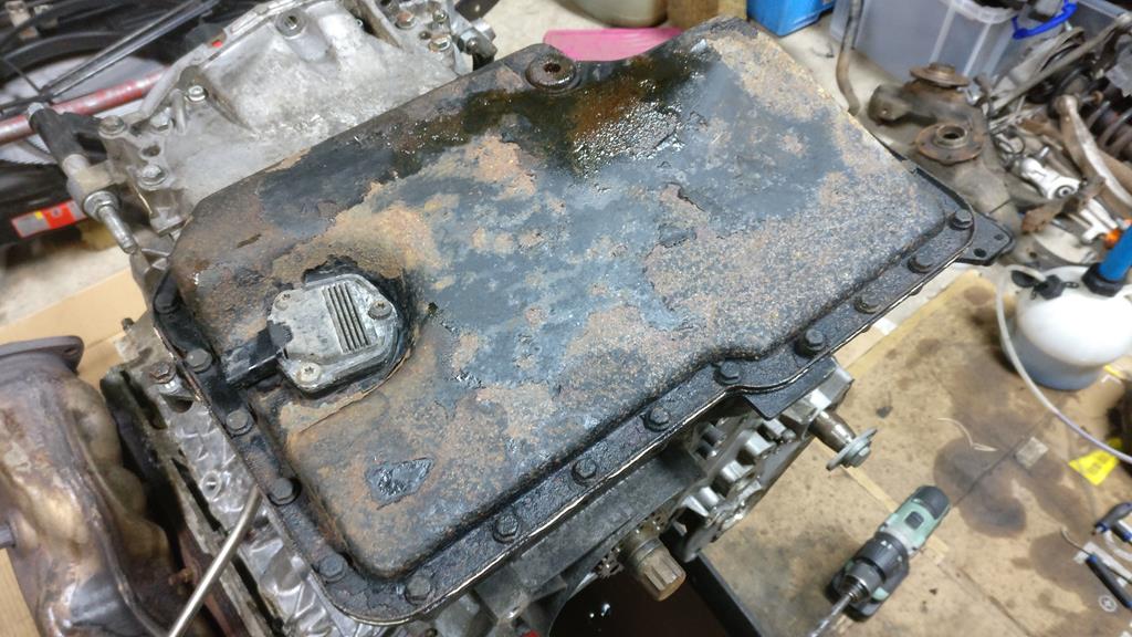

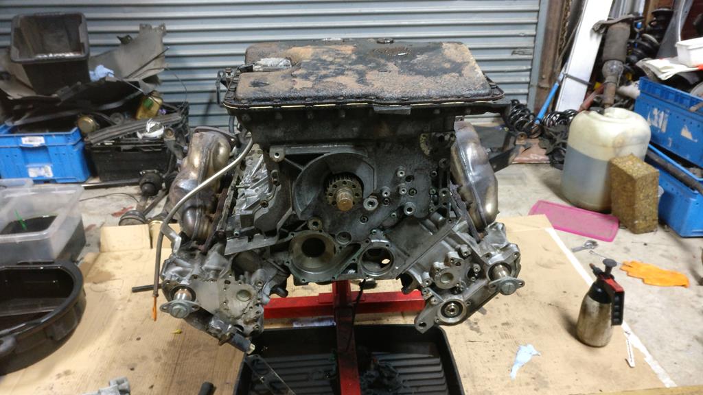

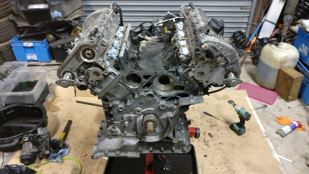

Flip it over to drop the manifold off underneath so no grit goes down the inlet ports, and then pop the sump off

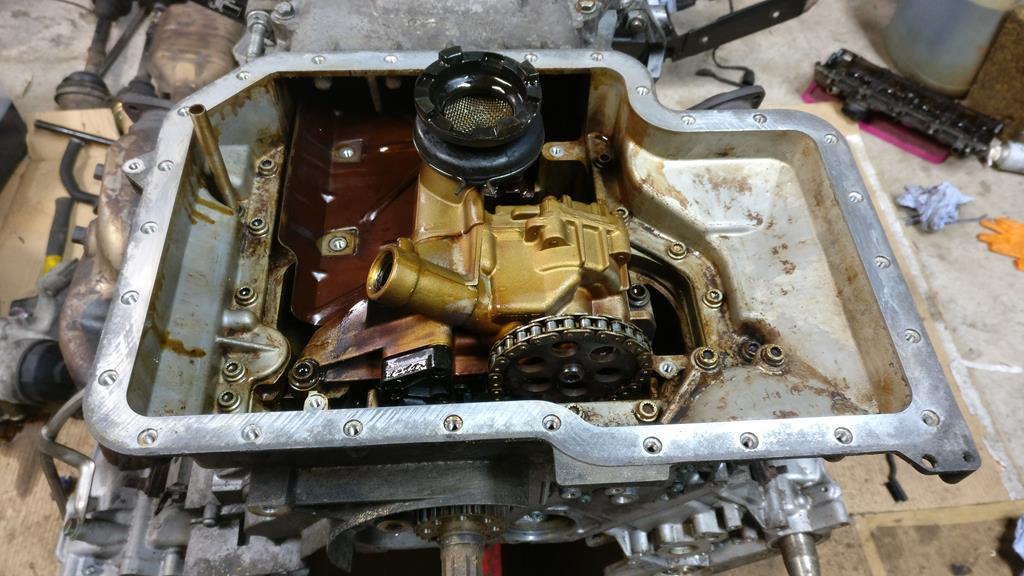

This is pretty crusty so will also go for powder-coat

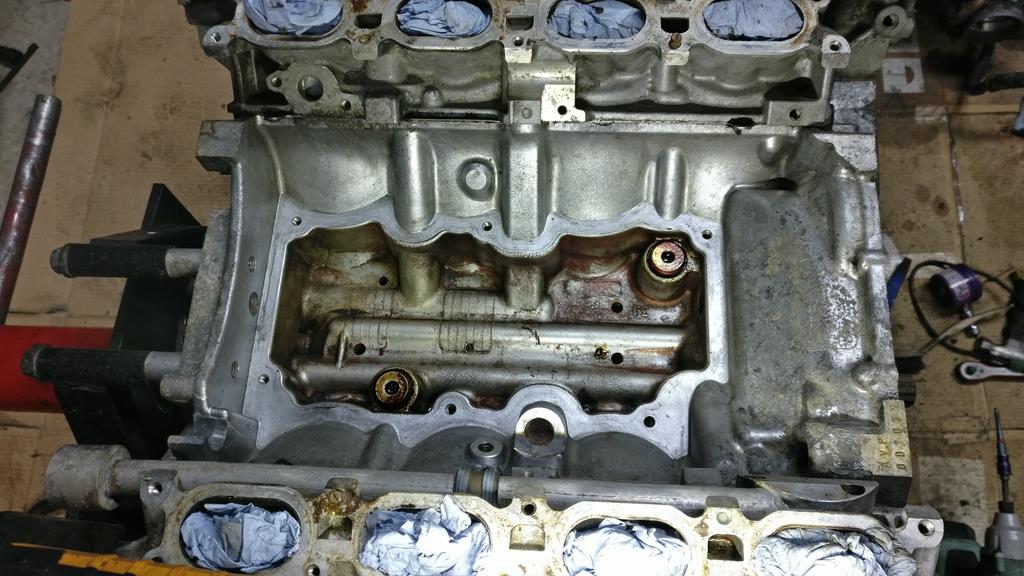

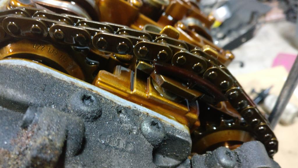

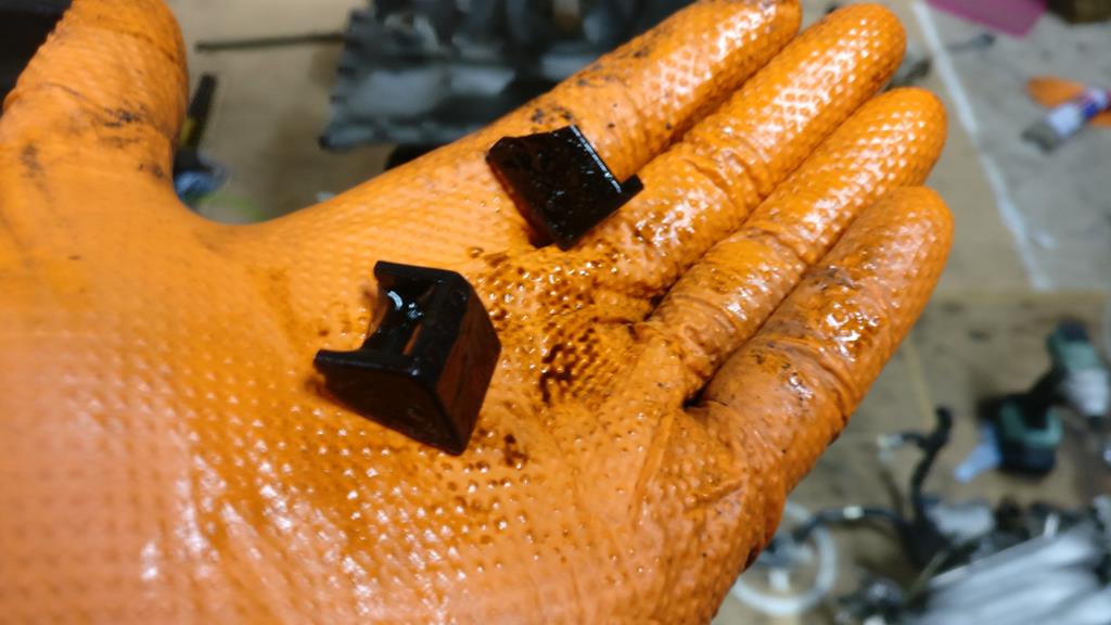

Oh hello. Why is a piece of the cam chain tensioner in the sump?
Not bank1...
(quite clean inside given the mileage)
Bank2 upper pad - broken in to about 4 pieces. That's quite a close call! It wouldn't have taken much more running for it to spit this remaining chunk out completely and be running metal on metal.
A few chunks loose in the head
Bottom end cleaned up. Heads and valley tomorrow while the sumps get coated.

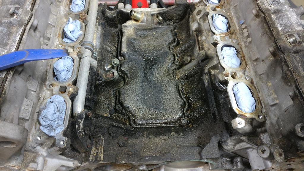

Right, back on this (again) after a bit of a wait for powdercoating due to a backlog and continued difficulty sourcing parts.
Cleaned up in here

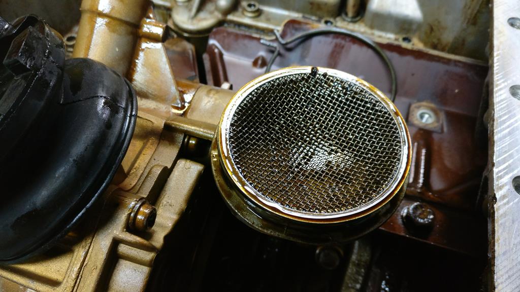

I popped the oil pump screen off just to check there were no bits of chain tensioner stuck in it - one tiny piece so thats fine.

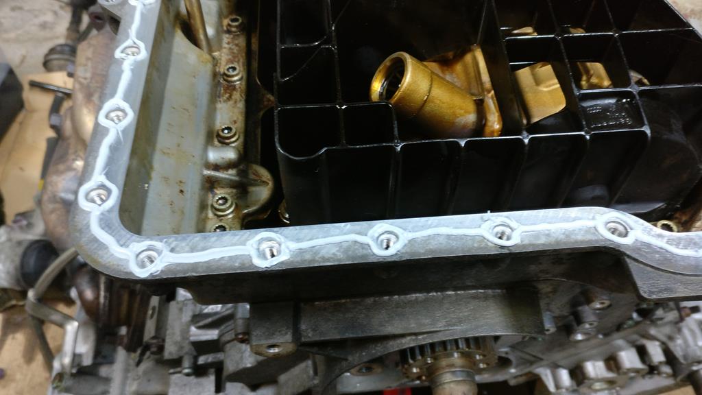

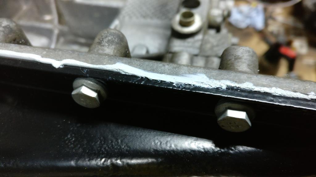

Sealant round the flange
Sump back on. I put new bolts on this time since the old ones are properly crusty. The sump looks a bit crunchy in this pic because of the light - actually its just some surface pitting where the rust was blasted off.
Metal oil cooler pipe
One day I will manage to stick a sump on without catching the sealant before it sets. That day is not today

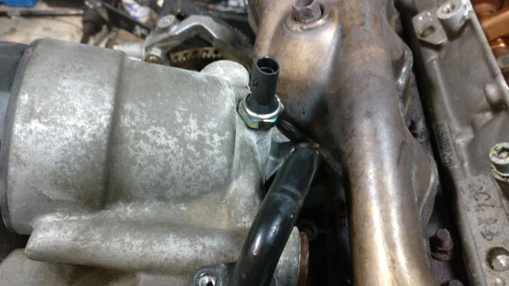

Replaced the oil pressure sensor as a precaution

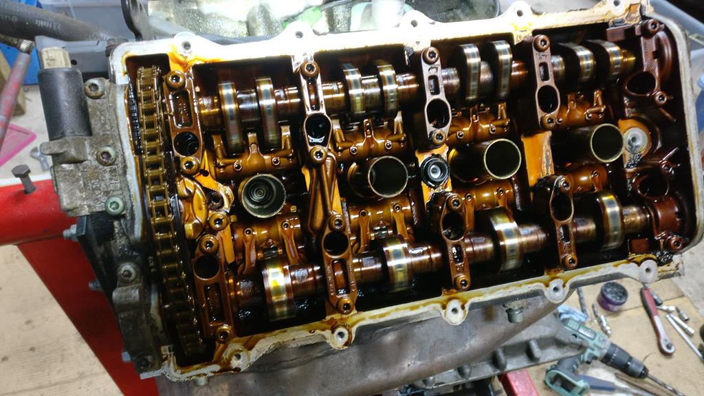

Put to bed for the evening since the cam covers are off.
Cam chain tensioners tomorrow
