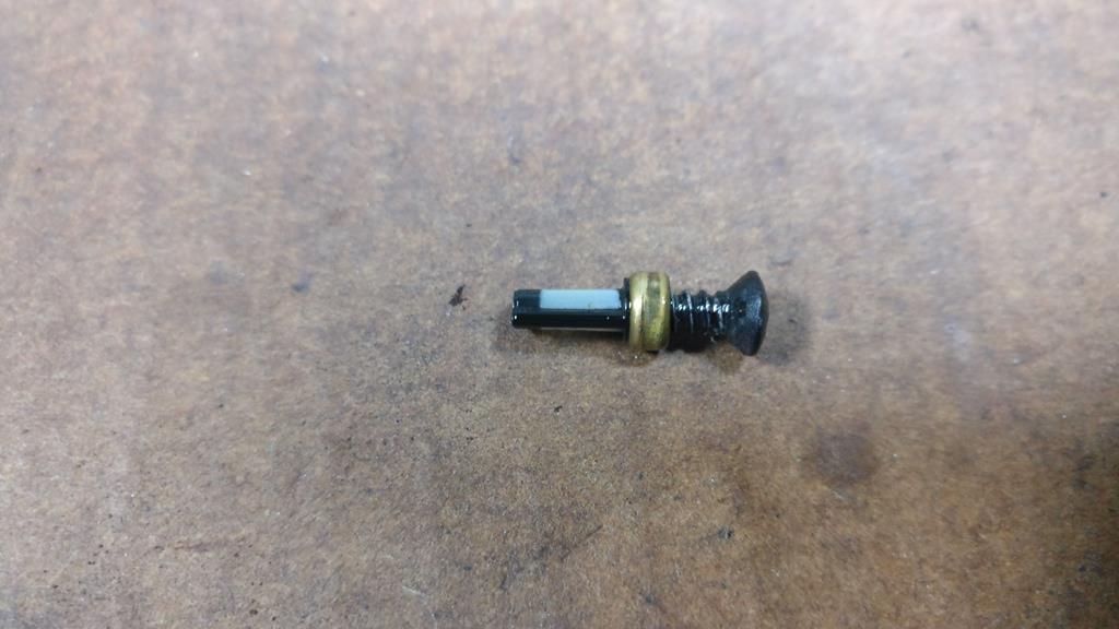

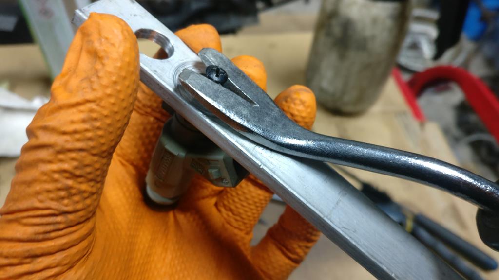

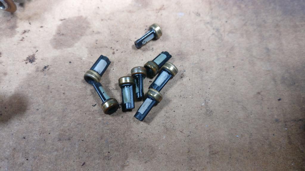

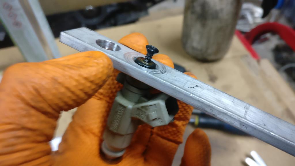

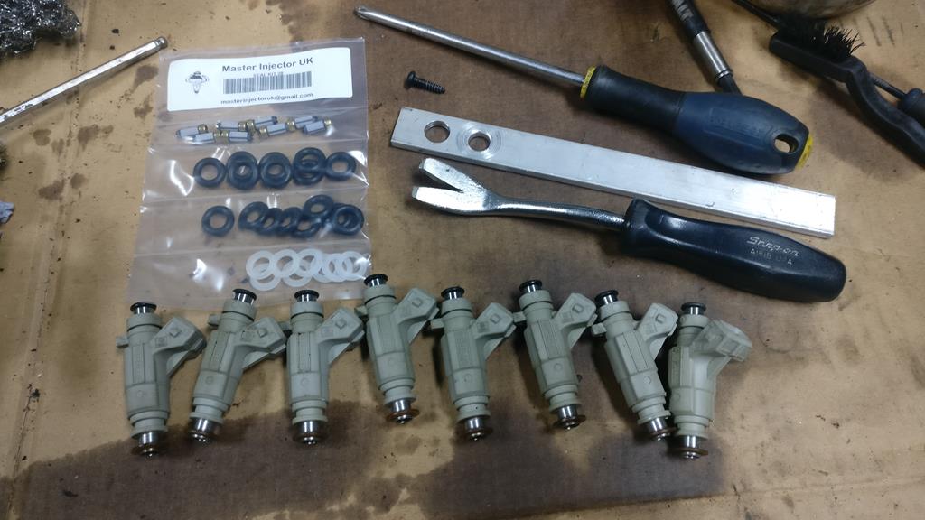

Injectors tonight.
Having struggled to get the filters out of the PF injectors, I made a tool The injector fits in the hole, then a self-tapper is screwed in to the filter
Then a trim removal tool can be used to lever against the tool and pop the filter out
thus:
All the filters removed. They are actually all clean and in perfect order, but I didn't know that until I took them out
At this point I was thwarted as the new filters are a slightly different size so I had to stop. I need to query this with the supplier tomorrow before proceeding, so I finished off prepping the manifold for paint which will hopefully go on tomorrow.
