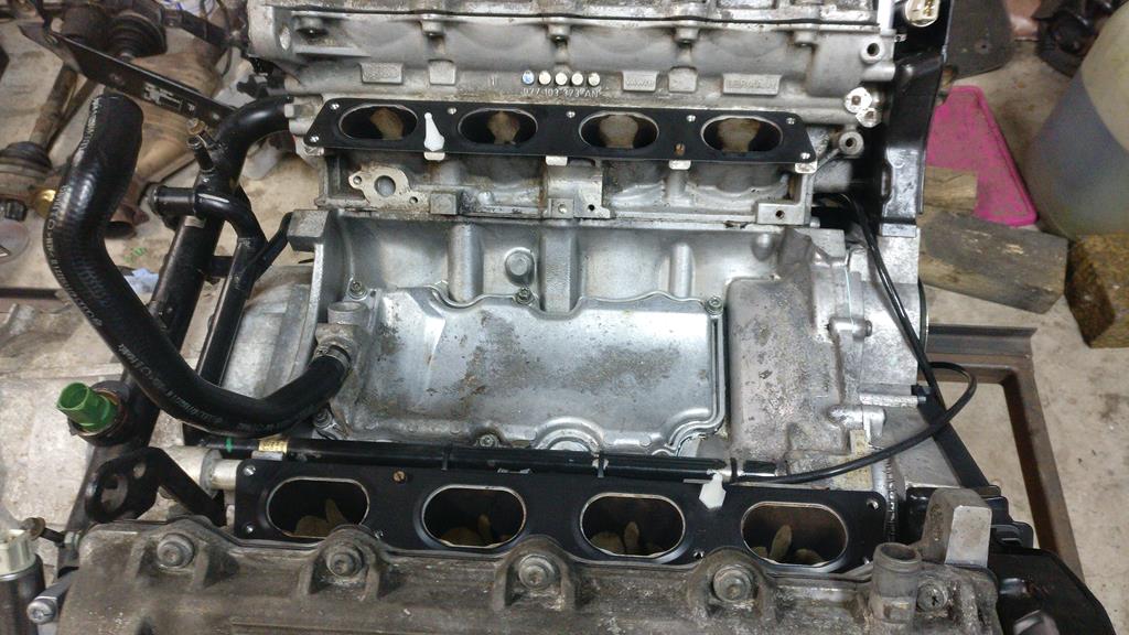

Put the engine and gearbox back on the separating table
Since I had the engine crane out, I contrived a solution to split the inlet manifold. The strap goes through each inlet port and supports the inner portion. The outer portion is wedged underneath the two box sections which are clamped to the legs of the engine crane
A little persuasion from the crane and the inner just popped out I'd dropped some brake cleaner in there previously so this probably loosened the silicone
Lift it out
and thats it from the top. These flaps open up at high rpm and shorten the inlet tracts. Its an interesting arrangement - the springs on the front hold them open, and the vacuum pods pull them shut at low speed. Presumably this is because the engine has less vacuum at high rpm since the throttle is open, so its easier to let go of the pods to actuate the manifold than it would be to try and actuate the pods.
This piece is a very intricate pressure die-cast. The tool for this must have been exceedingly difficult to make with such fine details.
The upper manifold is also die cast, but a magnesium alloy, the same as the cam covers. What's particularly interesting is that it looks like the mould must have been sand blasted after machining to give the outer surface a sand-cast alloy look. That's purely for visual effect, rather than an artefact of the manufacturing process.
The two halves are sealed together with silicone

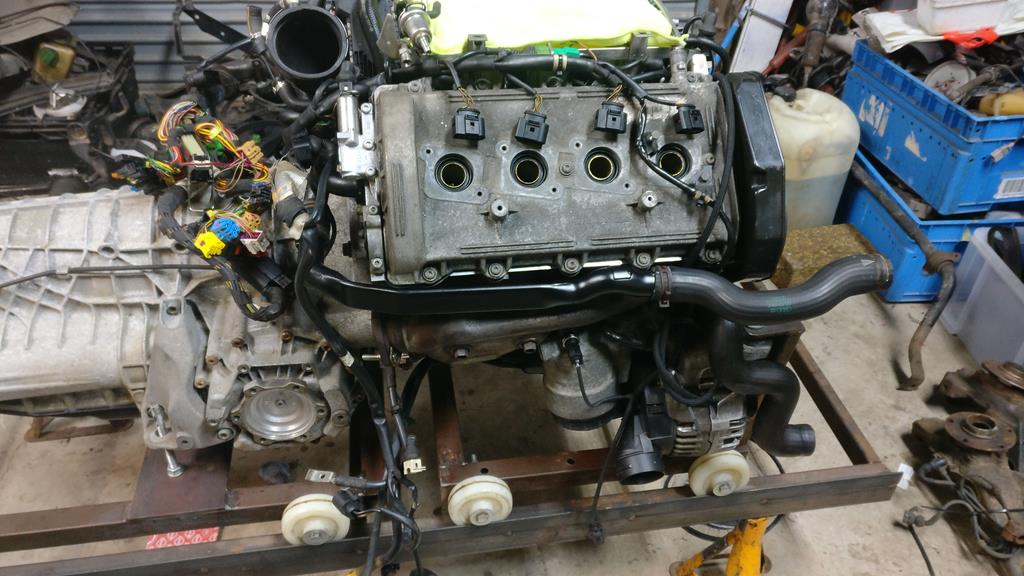

Back on the engine. Gearbox and torque converter bolted on, starter back on
New manifold bolts and powder-coated upper coolant pipe
Reconditioned alternator

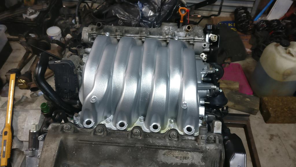

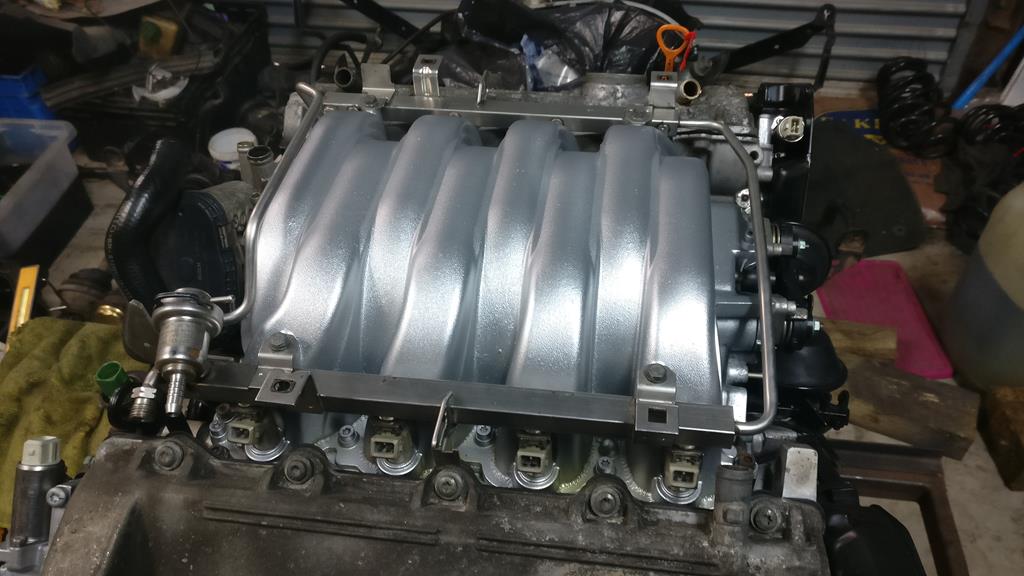

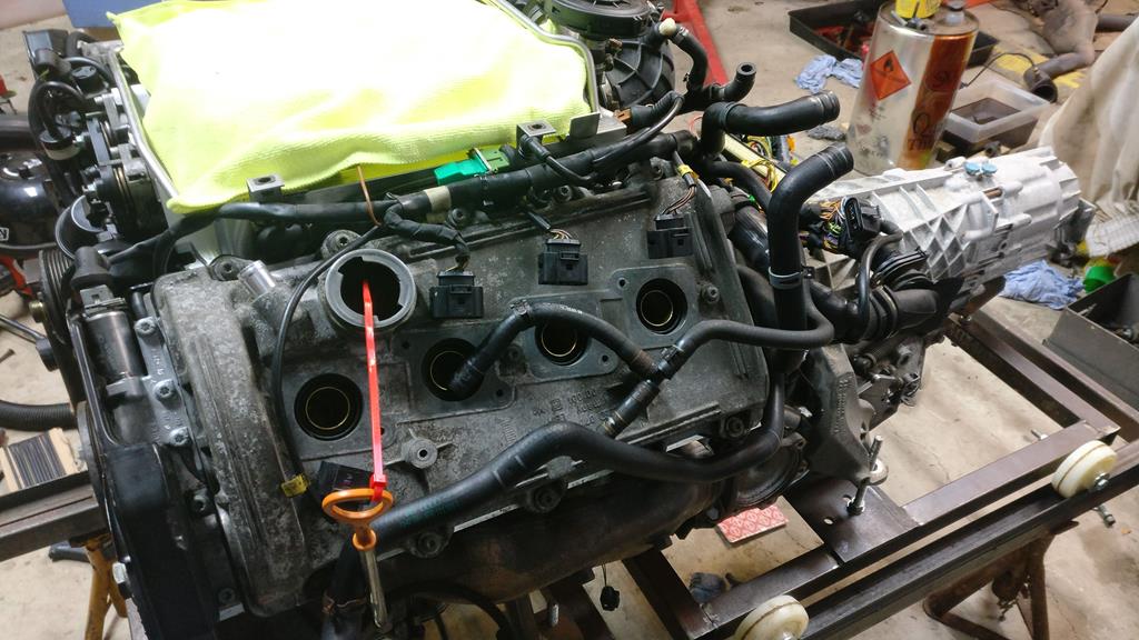

Engine ready for the inlet manifold to go back on
Manifold on
Injectors on

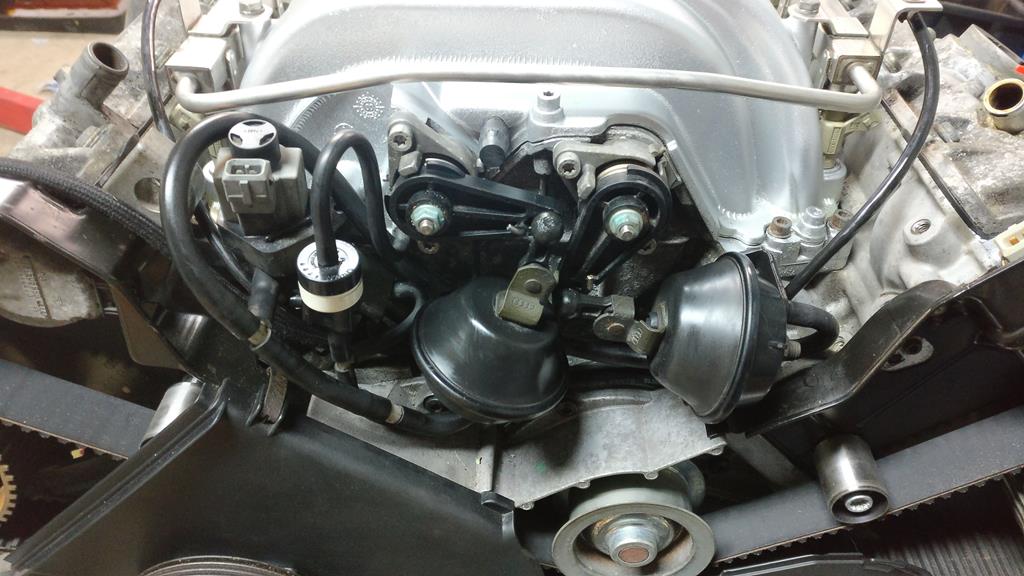

Vacuum pod gubbins on the front. No silly orange nuts!

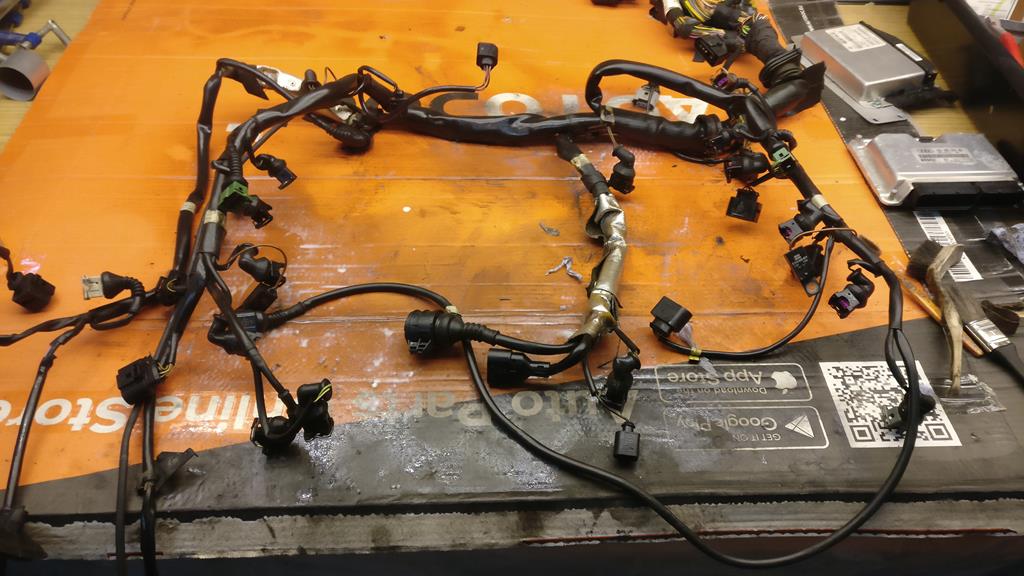

Cleaning the wiring harness
Wiring harness and coolant hoses back on

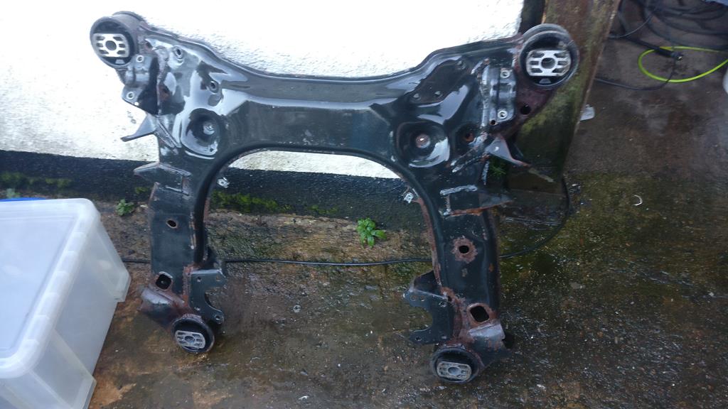

The replacement subframe after pressure washing. This is in really good condition and just needs some rusty spots painting. Its currently at home keeping warm so all the moisture dries out over the next few days so I can deal with the rust and repaint

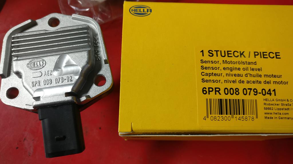

Normally at this point I would have spun the engine over and got oil pressure, but unfortunately I can't do this yet because it has no oil level sensor in the sump, largely because I forgot to order it The original was too crusty to reuse and I only realised I'd forgotten it when I put the sump back on. Consequently I can't put the spark plugs and coil packs back yet, or the engine mounts, although I can't put it all back on the subframe until thats repainted so its not a big problem.

The oil level sensor came in last week. The Hella part is the original item with the VW and Audi logos milled off

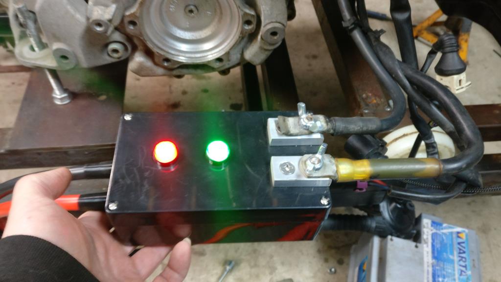

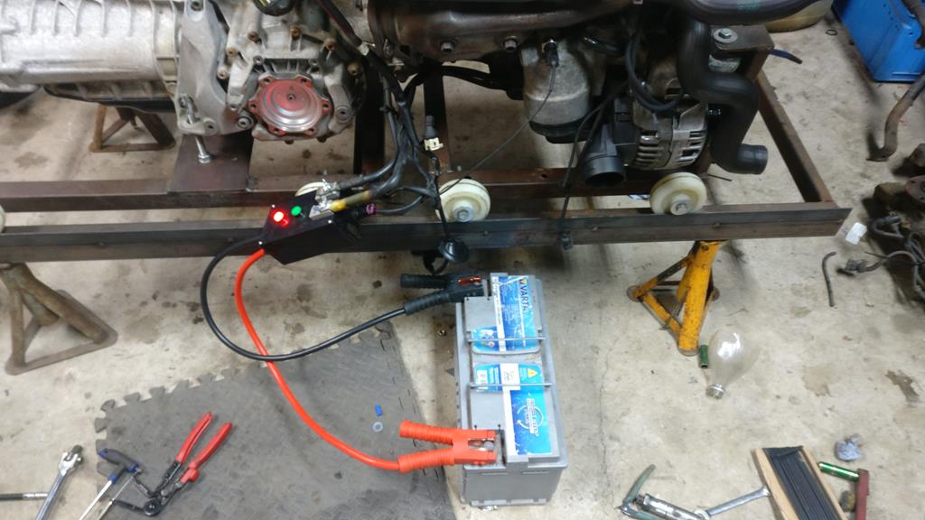

With the sensor back in the sump I could put some oil in it and use the test box to get oil pressure
Green means we have pressure

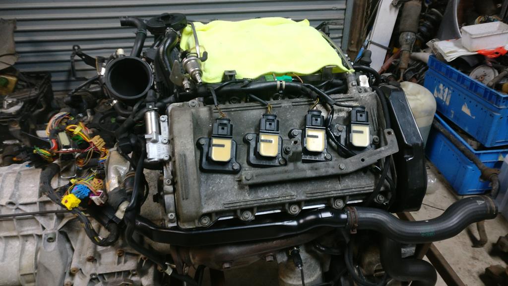

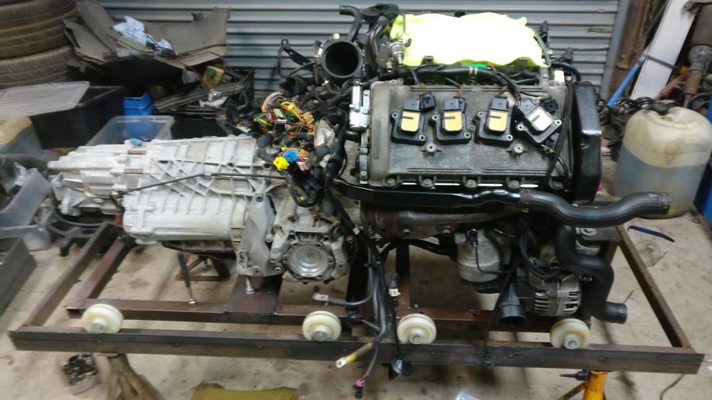

Spark plugs and coil packs back in

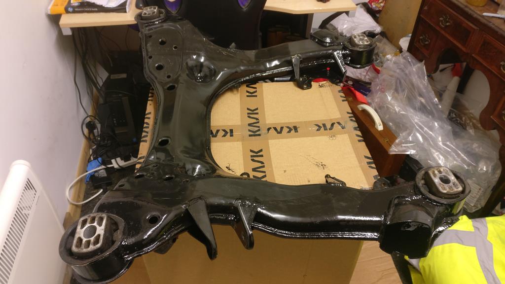

The subframe has dried out nicely so I painted the rusty bits with Rust-oleum.
