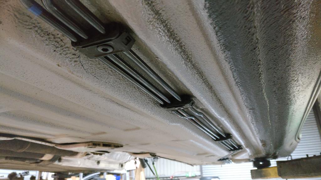

If you were to use rivnuts on the rear heatshield, would you have to remove the carpet to drill through just the floor and not damage the carpet?
  #262
Old 14th February 2022, 08:42 PM
I will be using rivnuts on those yes, but I won't be taking the carpet out. I'll just use a stop on the drill bit.

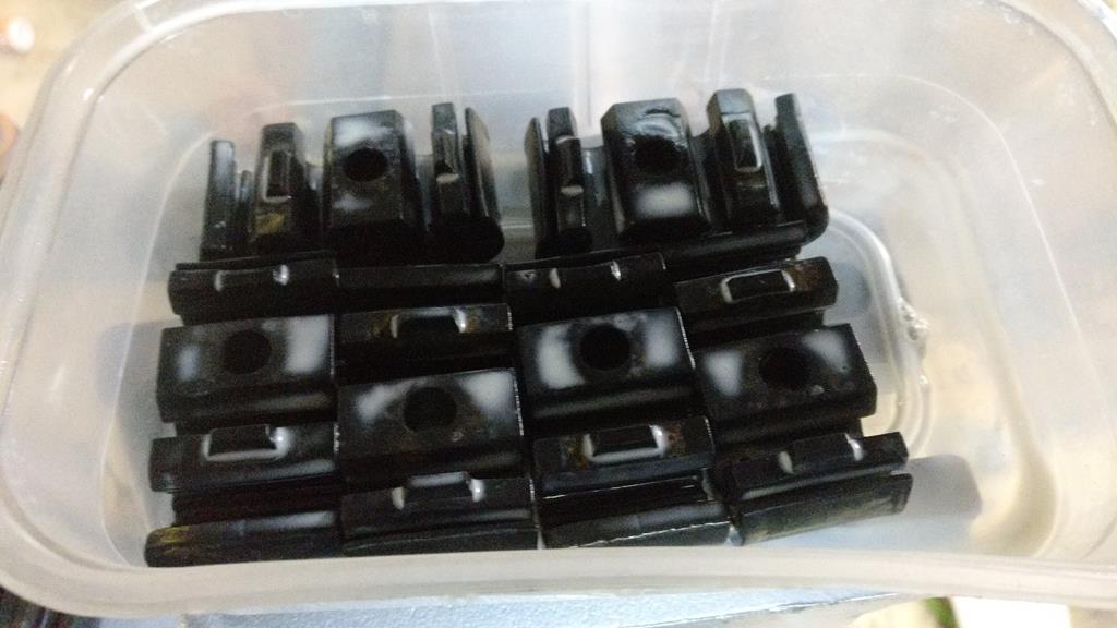

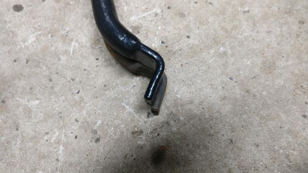

The fuel line rubbers cleaned up nicely in Evaporust, so then I soaked them in Autoglym rubber conditioner for a while and then put them back on the car with new clips and hardware

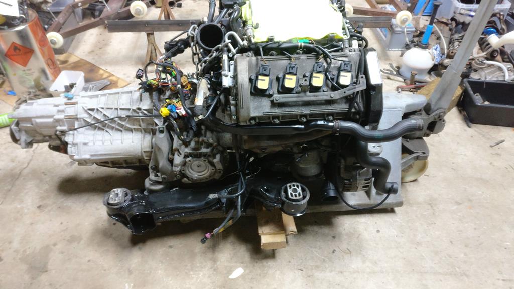

The paint is finally dry on the subframe so I put the engine and gearbox on it, ready to go back in the car

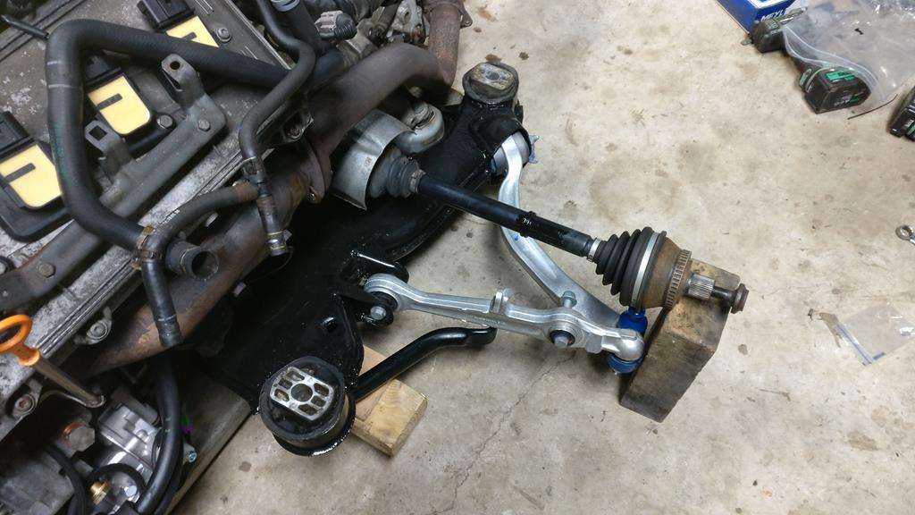

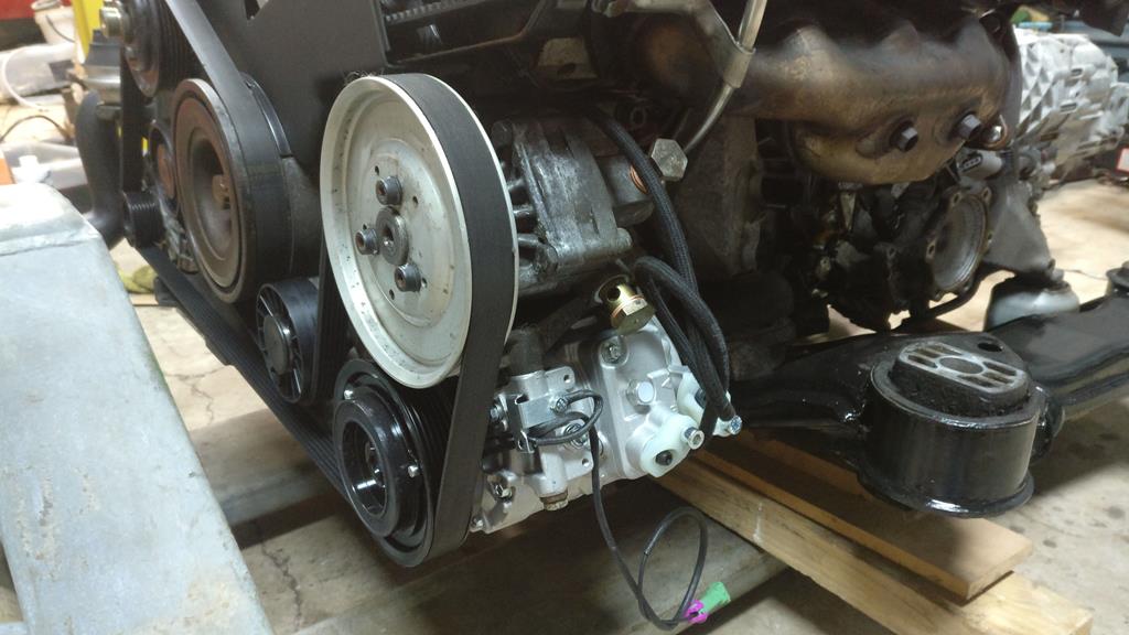

PS pump, new AC compressor and a few other bits back on the engine

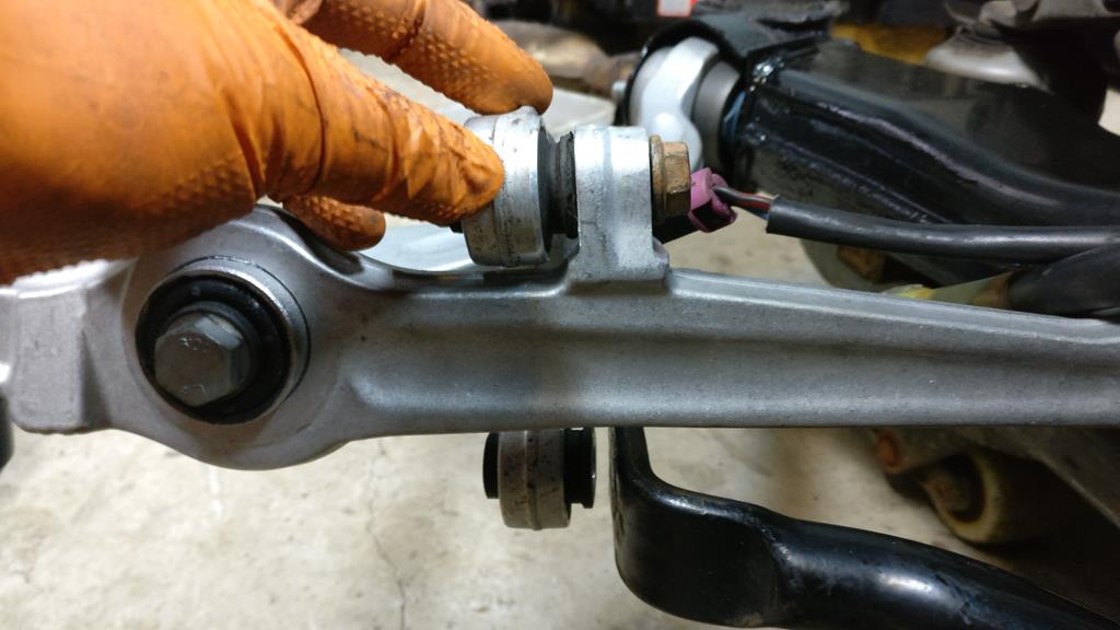

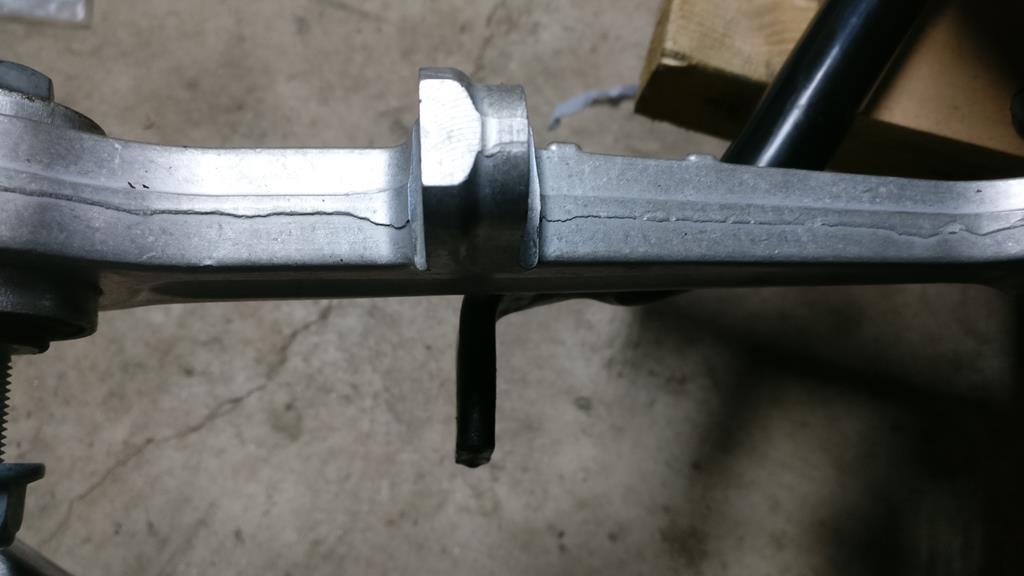

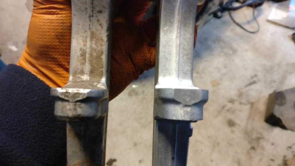

I discovered an interesting thing about FE suspension today, specifically a slight side-effect of using the PF lower front arm since the FE one is NLA. The anti roll bar links don't fit properly, which puts the bushes constantly under tension and will wear them out in short order.
There's a gap between the mounting boss on the arm and the bar.
Because on the PF arm, the mounting sits slightly further outboard by 3mm or so
Bizarrely, the PF anti roll bar (top) is actually shorter than the FL, which would appear to compound the problem. I'll figure this out when I put the PF back together.

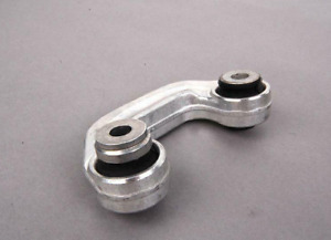

The A4 and A6 have this gap by design. They have the same design of ARB links, but with a small spacer on one of the bushes to accommodate this gap. I've ordered a couple of these to see if they fit better.
Arms, arb, downpipes and driveshafts back on so this is pretty much ready to go back in

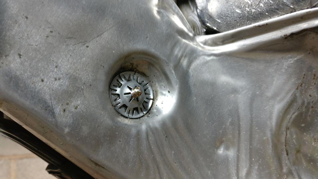

The grip-washers came in for the heat shields too
Final cleaning of the tunnel and floor tomorrow and the engine can go back in
Not great. I have the same setup on my 2.8 and when sat normally the ARB links are twisted. Have only finished the front end refresh recently, looks like a rethink?

Yeah same on Big Red too, and a couple of others. The B5 links should sort it and they are the same price.
One bonus, ish, of using the PF front arms is that the bespoke 20" headlight levelling link is no longer needed and the standard link can be used instead. Good if it's missing completely like this one. Less good if you already have a good 20" link I guess.
