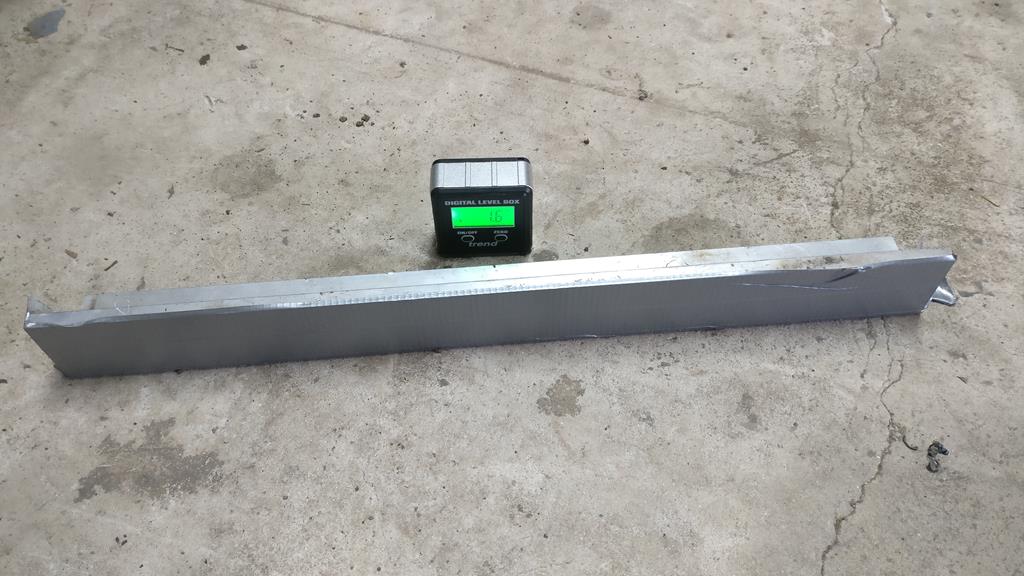

I had noticed that camber was uneven on the front, so basically I paid Protyre for a full alignment to effectively screw up all the settings but get me measurements of camber and caster on the front. There was too much camber on the left, and too much caster on the right so I spent an hour shuffling the front subframe around on Friday evening, using a lump of aluminium and an angle cube

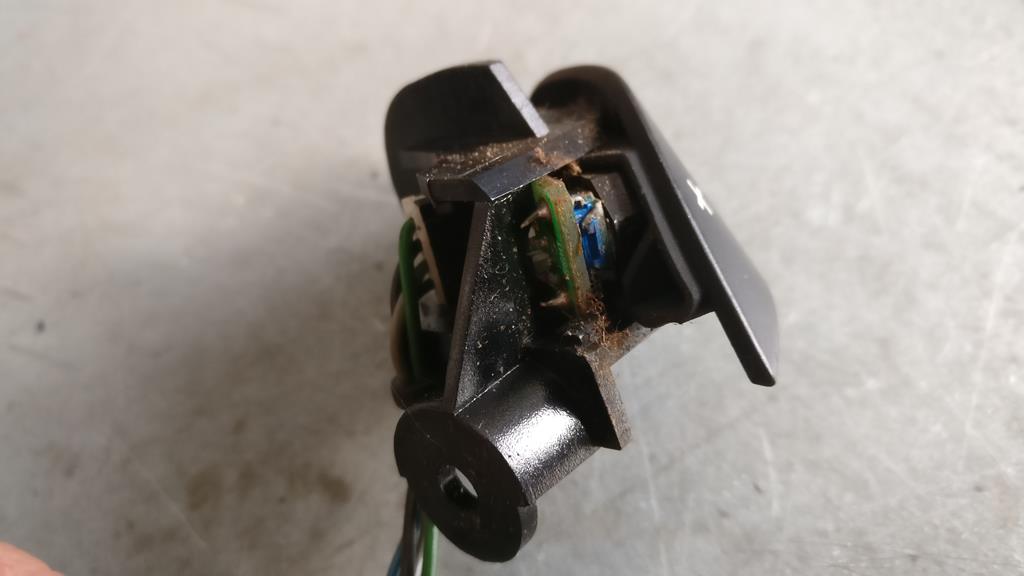

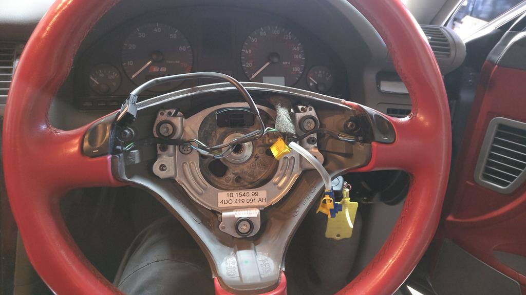

I'd also noticed the tiptronic buttons only worked on -. + worked sporadically on the right button, but not at all on the left so it was a switch fault rather than wiring
The buttons and wiring can be removed as an assembly so I just swapped in a set from a spare steering wheel
The old ones were a bit crusty, but these will serve well for experimenting with using them as radio control buttins instead

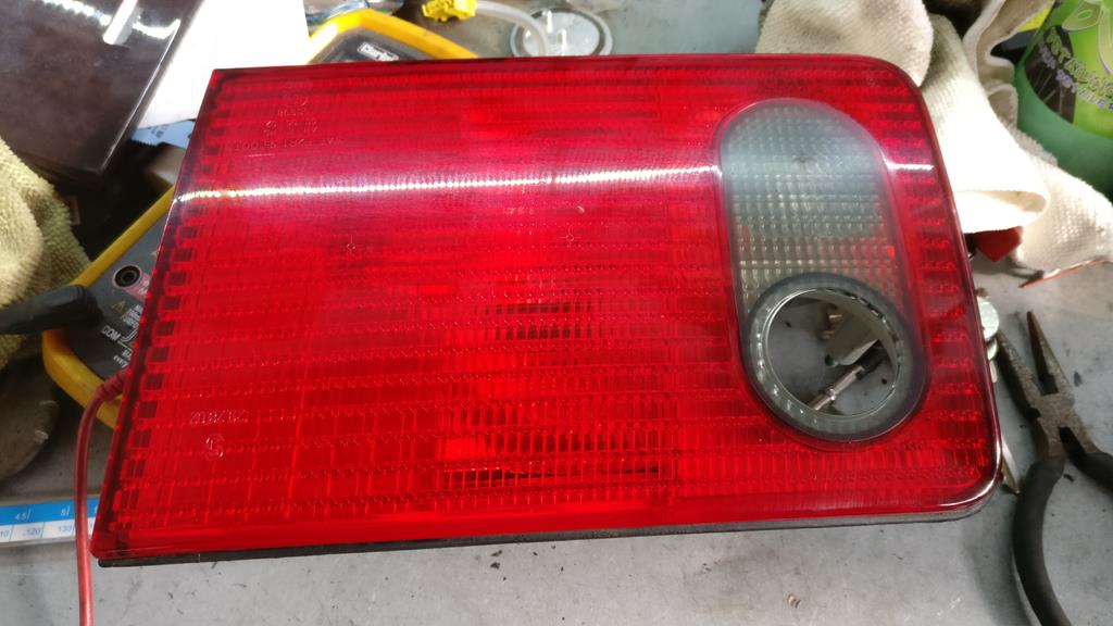

The right hand tail light had a crack in the reverse light so I swapped in a replacement
