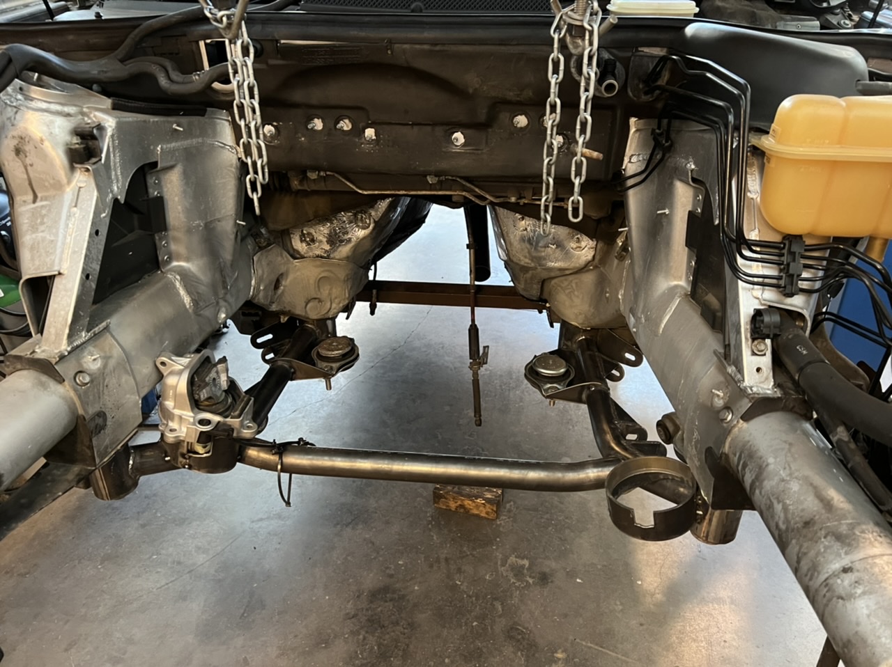

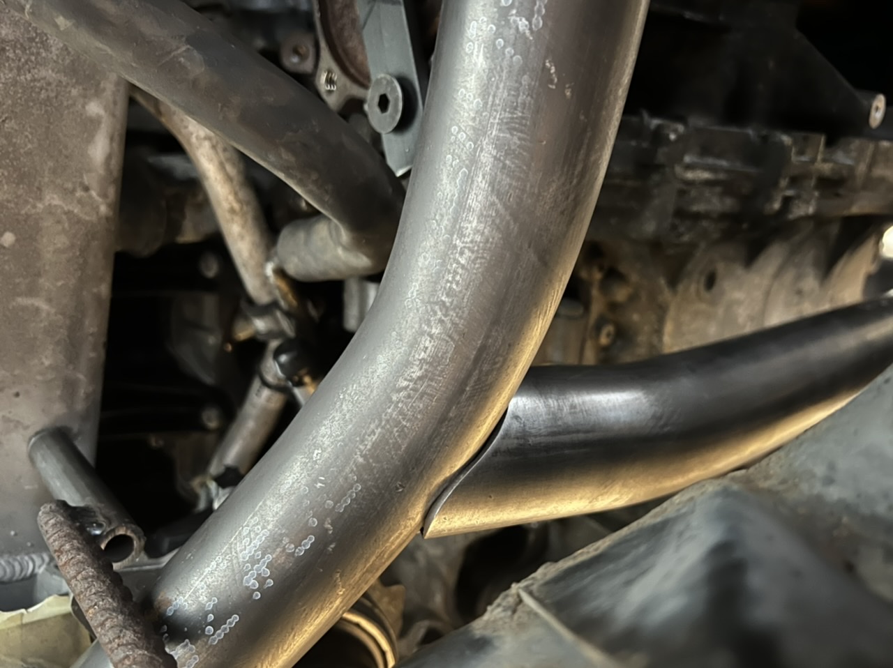

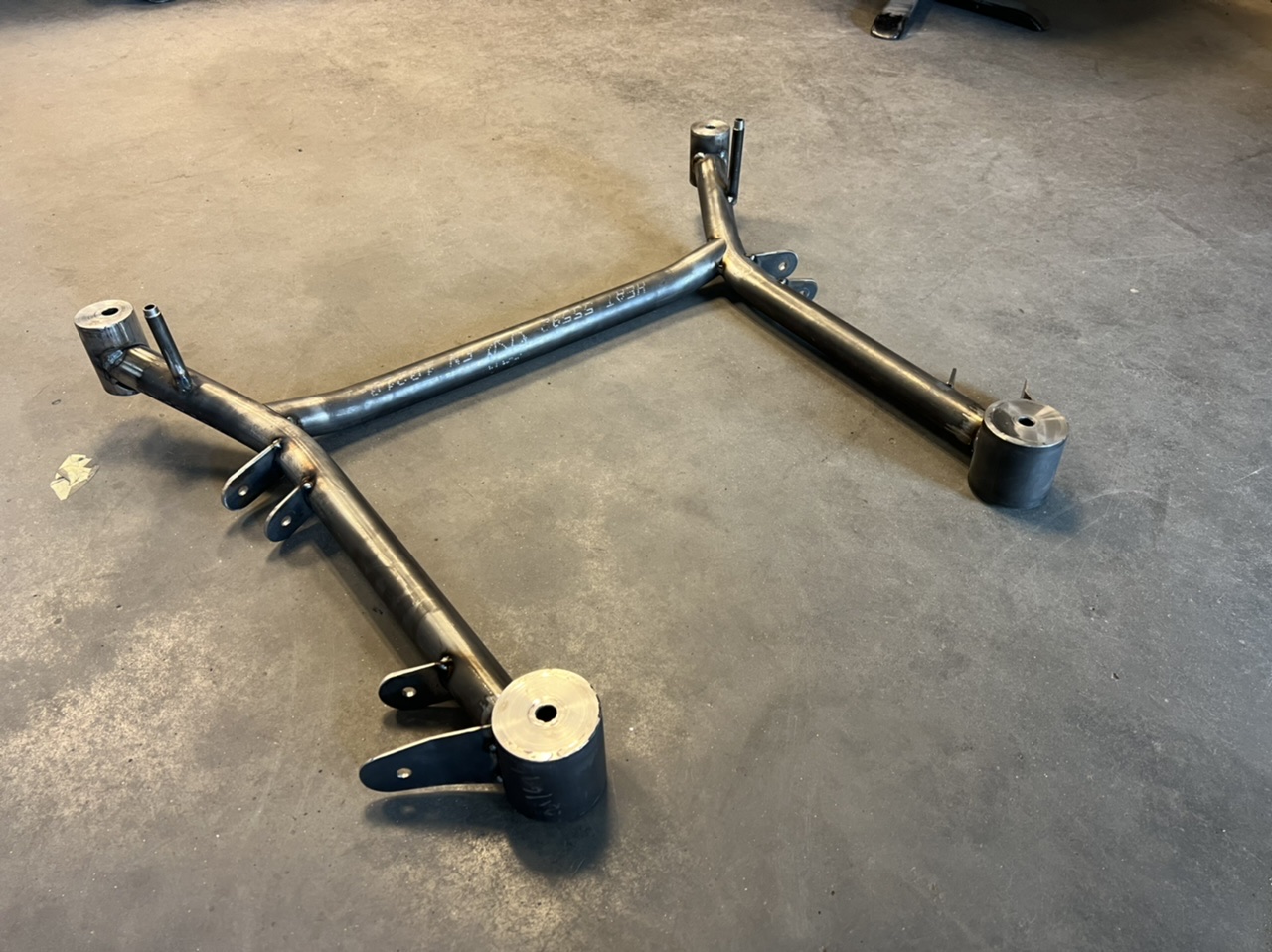

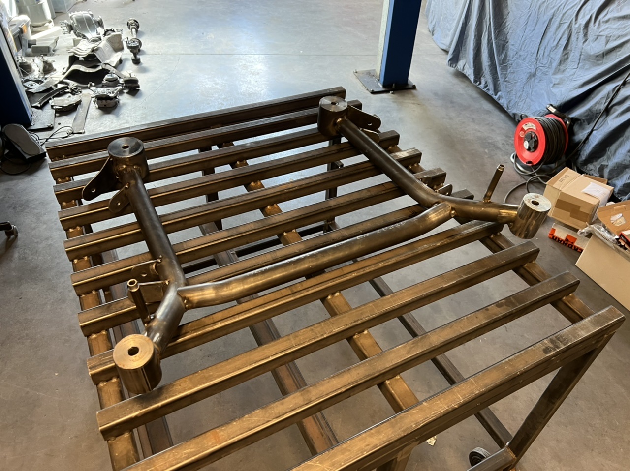

Subframe is taking shape!

Very cool! Nice work. Just wondering, are you going to use the stock ECU or are you going to use a standalone ECU?
Im gonna use a Emtron ecu for the engine and a HTG ecu for the gearbox. Also gonna use a single turbo hoping to end up somewhere between 800-1000hp
  #46
Old 17th July 2022, 08:23 PM
Audifan Audifan is offline
Join Date: Feb 2020
Location: America
Posts: 388
What gearbox are you going to use for this engine?
ZF 8hp55 out of the same rs6 as the engine came from

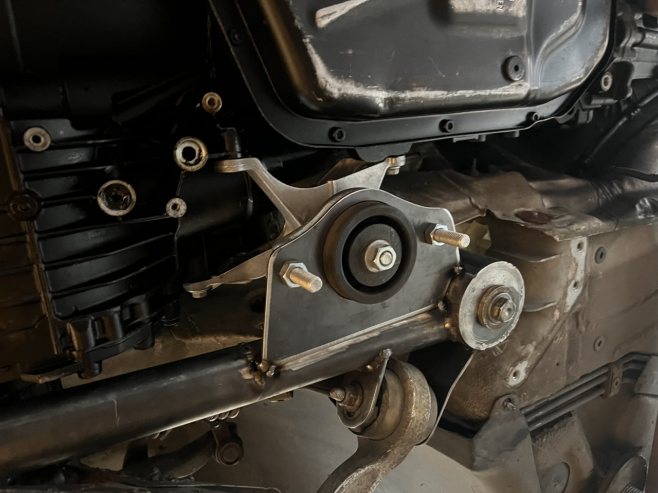

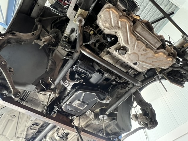

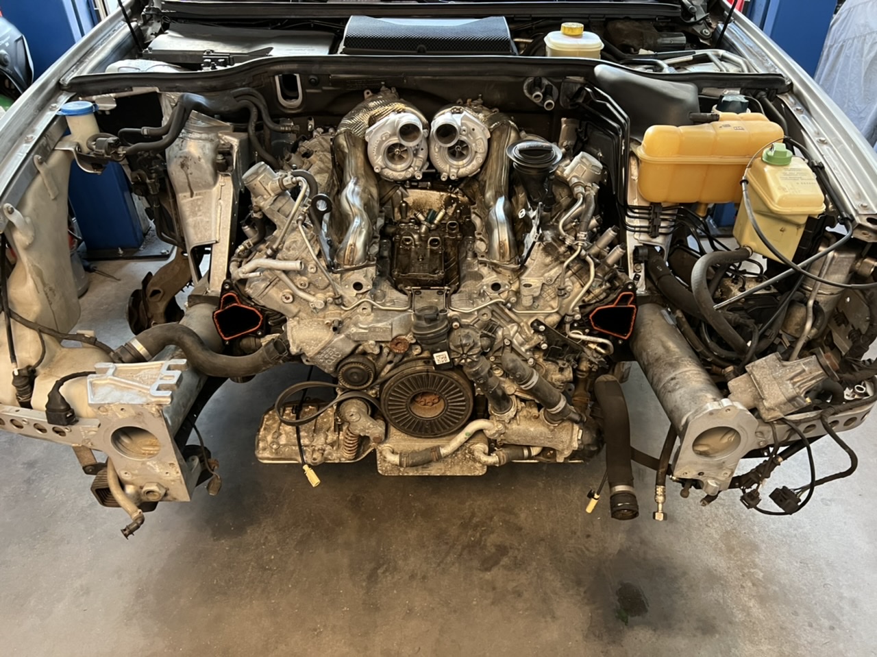

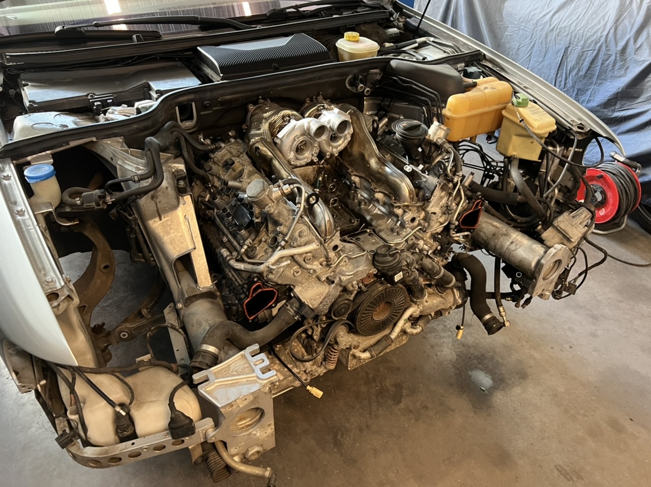

Yup I made some progress! Subframe is pretty much done and so are the engine and gearbox mounts.
Have the stock twins on to see but definitely no space without cutting and using the 8hp automatic. Maybe with 6 speed using the twins would be possible.
