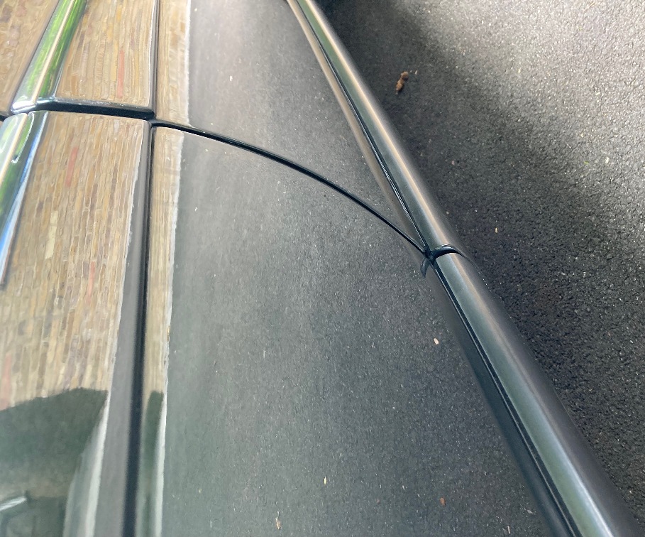

My drivers door lower trim is damaged; while doing some pre-MJ checks I caught my leg on it a few weeks ago! She didn't have time, given the huge load of other jobs, to look at it while it was there.
I found the plastic strip on the inside but it didn't want to slide.
It was quite loose at one end anyway and eventually just unclipped straight off; hopefully not too damaged to clip back on, otherwise it may need some adhesive or double-sided tape at the end of the job.
This is the door trim, not bad but I know it's wrong:

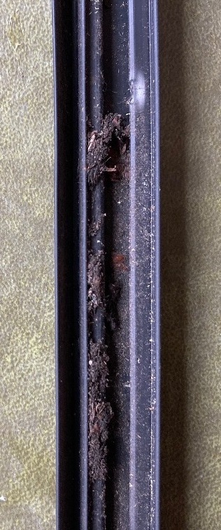

Old 1st July 2022, 11:49 AM
Posts: 8,545
The evidence, there's a handful of places with similar witness marks.
(The others also have smaller marks the other side of the channel as those clips did engage - this didn't hence the muck!)
Hopefully, if it doesn't go back on securely, A8Parts can supply one.
PS The photo is indeed upside down from how it is mounted on the door, but the lighting makes it look weird the other way up.

Old 4th July 2022, 10:47 AM
Posts: 8,545
Looks good now and was a lot easier to fix than expected.
The cover strip on the inside also slid on correctly with a little "persuasion".
