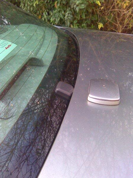

It's a very long time ago now, and on my PF S8, but I ended up putting the "puck" outside at the very rear of the back window, just in front of the boot lid.
I'll see if I can find a picture...
Much better reception there as the rear screen does block the signals to an extent. And that was for the very rare RNS-C.
It was a bit of a PITA to graft it onto the existing wiring, but as you're running a new one should be pretty simple.
