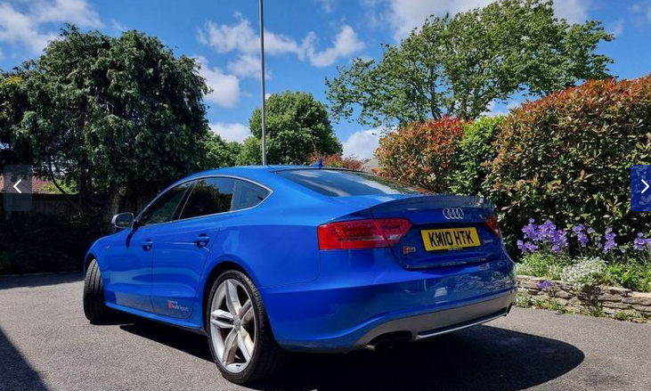

Here's a photo of my car with spaceship mileage but well cared for... decals will probably get removed when I sneak out with my girlfriend's hairdryer one day but don't tell her!

I will admit to having no luck with the passenger door mirror. My seats are electrically adjustable but I don't have that memory panel on my door similar to the one on the A8L. Perhaps mine is a so-called poverty spec - it does have SatNav but not sure if HDD. As you can tell I'm still learning, and that will be a long process as I'm blown away by the performance of the thing - it's a lovely blue rocket-ship and I'm going to have to be very careful. Touch the right pedal and I'm catapulted forward into the next decade!
I did look at an older S5 with the V8 which had a Carlos Fandango exhaust on it - I was informed by the garage (Smallfields) that 'it was very loud' so I gave it a miss and then jumped on this beautiful Sprint Blue one. Seller told me it was the best colour and I obviously agreed with him.
