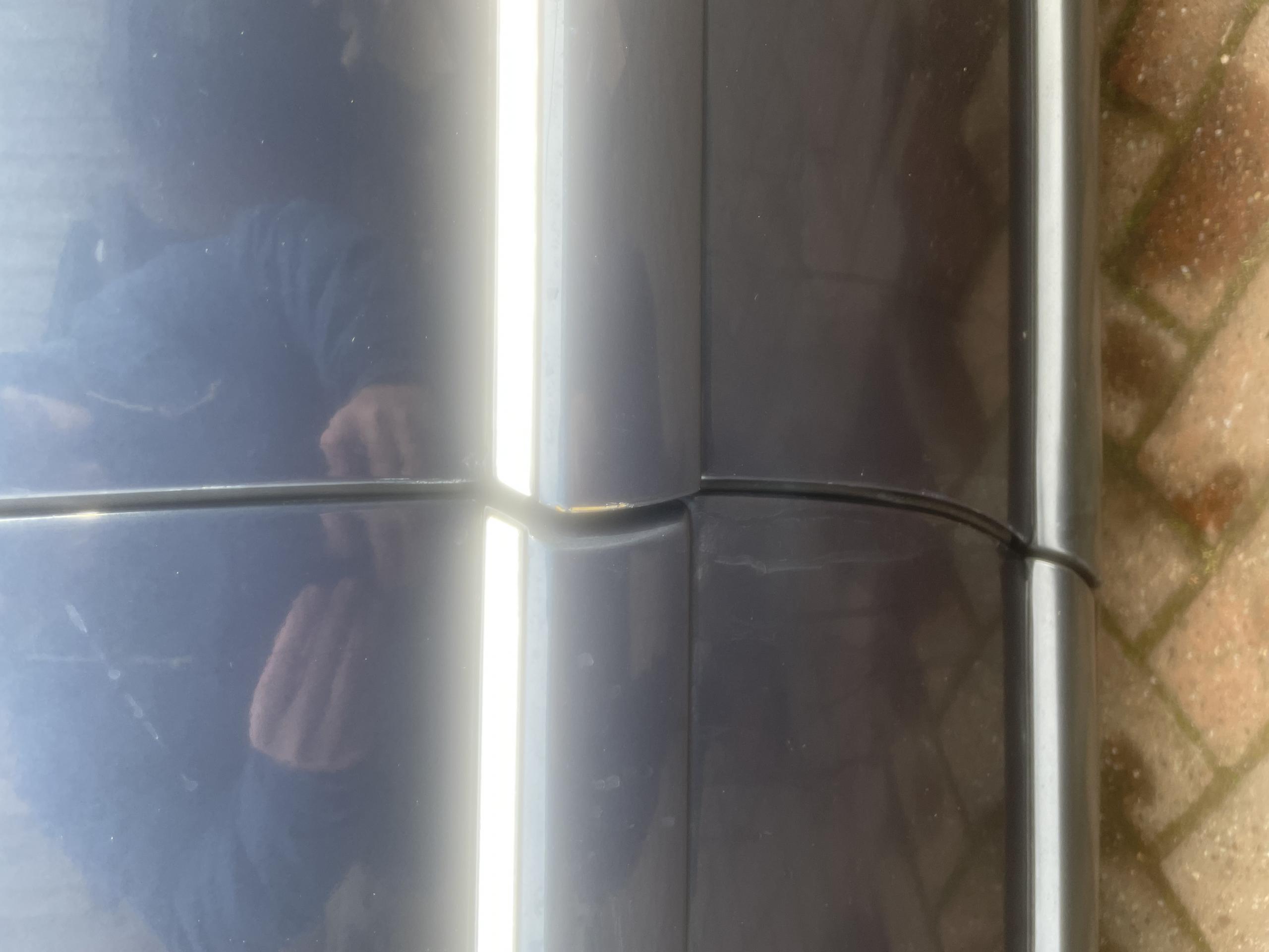

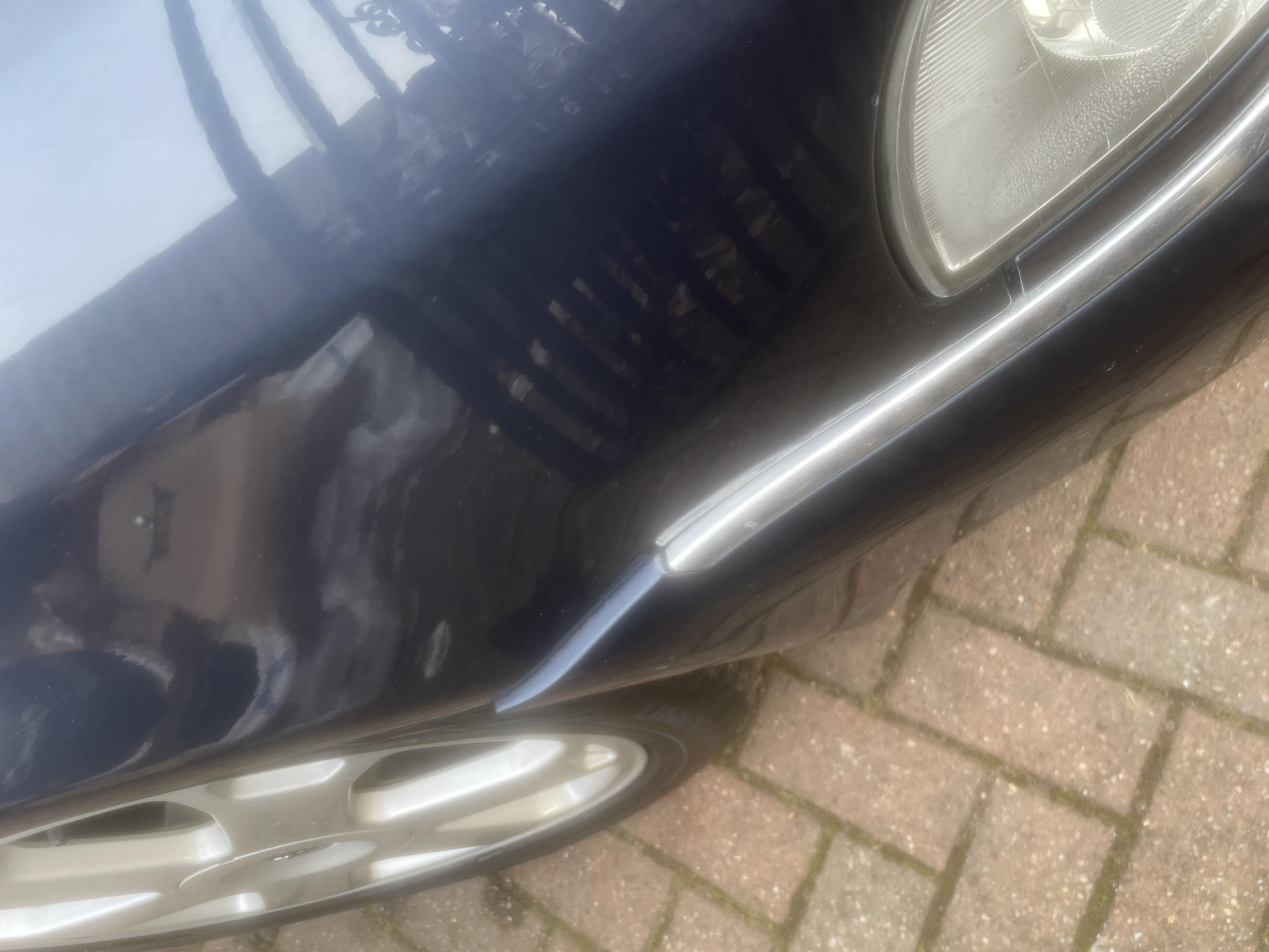

1. Drivers door was 3-4mm too low, was out of alignment (image) but gave the vibe of crash damaged. gap in seal on top of door. RHS front bumper wasn't flush with the wing (image), looking underneath the arch was clear over spray. The drivers door had weird peeling again a sign of poor respary.

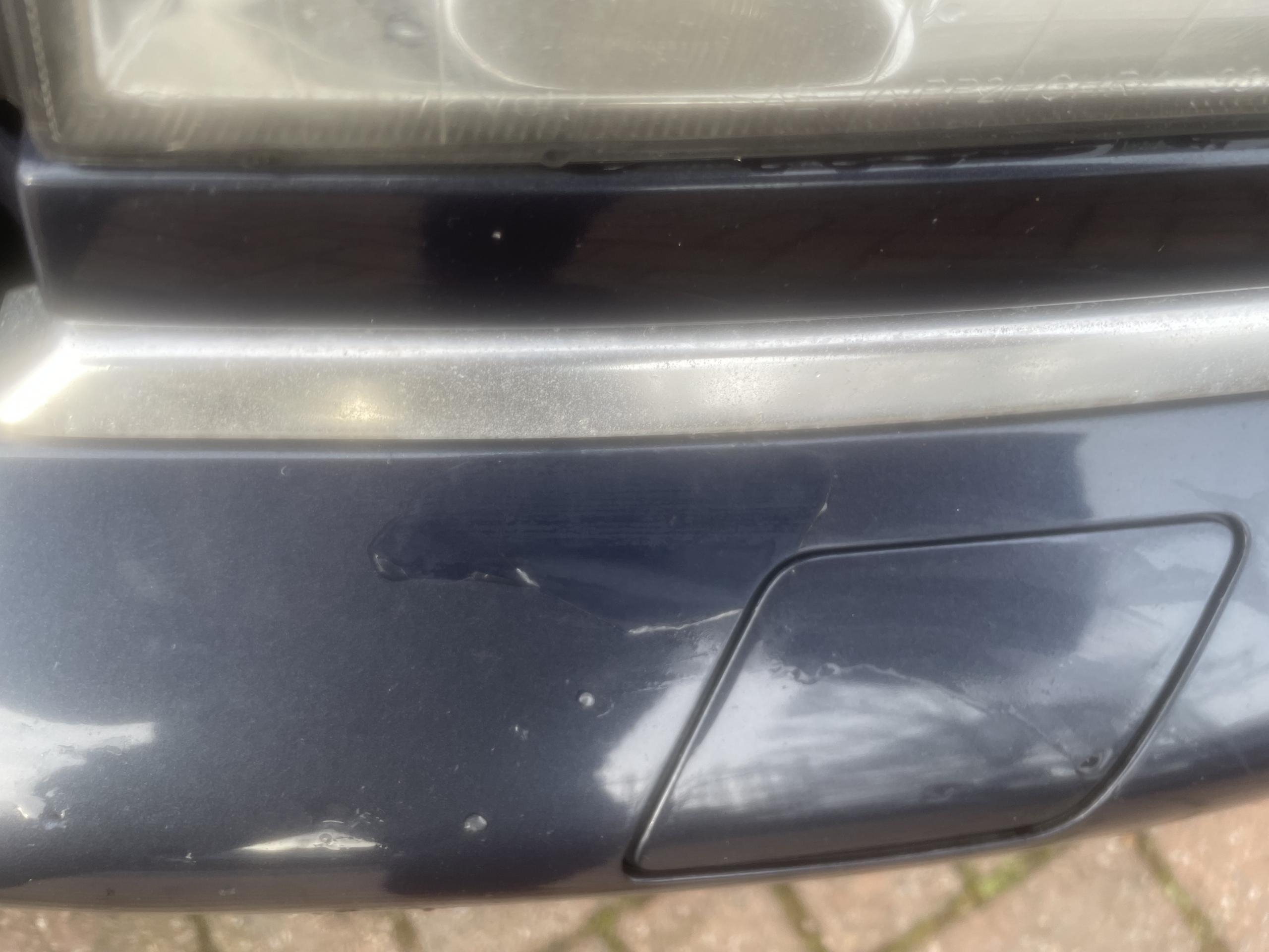

2. Front bumper paint peel and front passenger door paint peel-

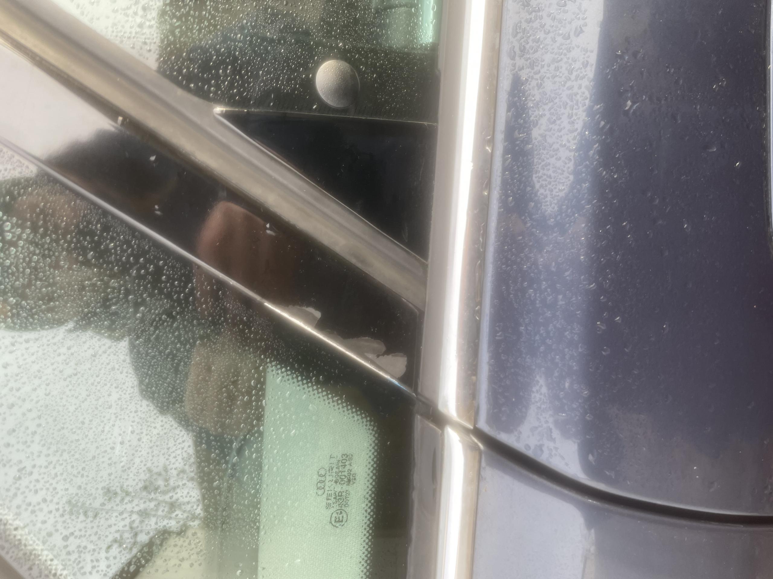

4. Rear Passenger door window frame corrosion was like something from the titanic (image) and has corrosion chipping on skirt

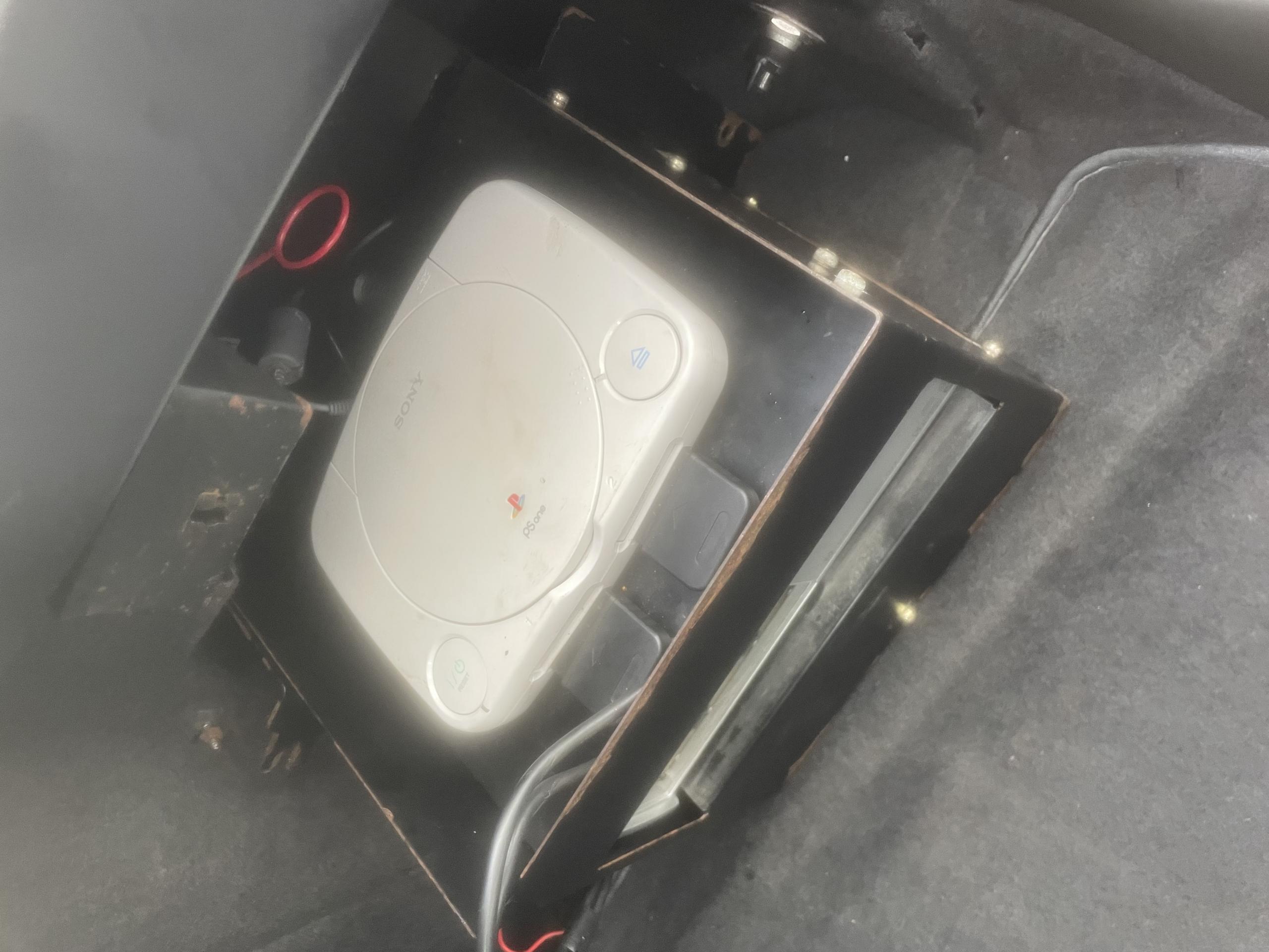

9. the PS1 was just in the boot mounted on a frame, looked totally screwed, the tv in the rear didnt work just cannon fodder in the rear.

The driver's door has probably been fiddled with. Its not uncommon for them to end up out of alignment like that, and the window frames are notoriously difficult to get right if they have to be removed for repairs. Ditto the bumper - the brackets on the wings bend slightly leaving the corners sticking out like that
The corroded fuel door and door triangles are standard fitment these days. They all go like that eventually. Many fuel doors have been replaced but the door triangles are an ordeal to get to and require the door completely stripping, then you have to line the window frame up again. Its common for the black B-pillar trims to suffer the same way.
The PS1 frame is how they are. They were dealer-fitted and all that kit was knocked up by a small British electronics manufacturers, hence why it looks a bit agricultural. Shame it didn't work though. I've yet to encounter one that does.
