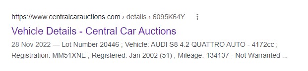

From googling, was sold in auction on 28th November, is there anyway of findout the sold price? screenshot attached
https://www.centralcarauctions.com/v...tails/6095K64Y

The main red flag was the 11 owners and the total lack of service history, no garage invoices for the work. Just A4 europarts invoices with hand written mileage and "service done". The car was sold at auction on 28Nov in Glasgow and the last owner europarts invoices are in Glasgow so match the evidence. The car still had residual glue on the front screen id say from the auction house.
