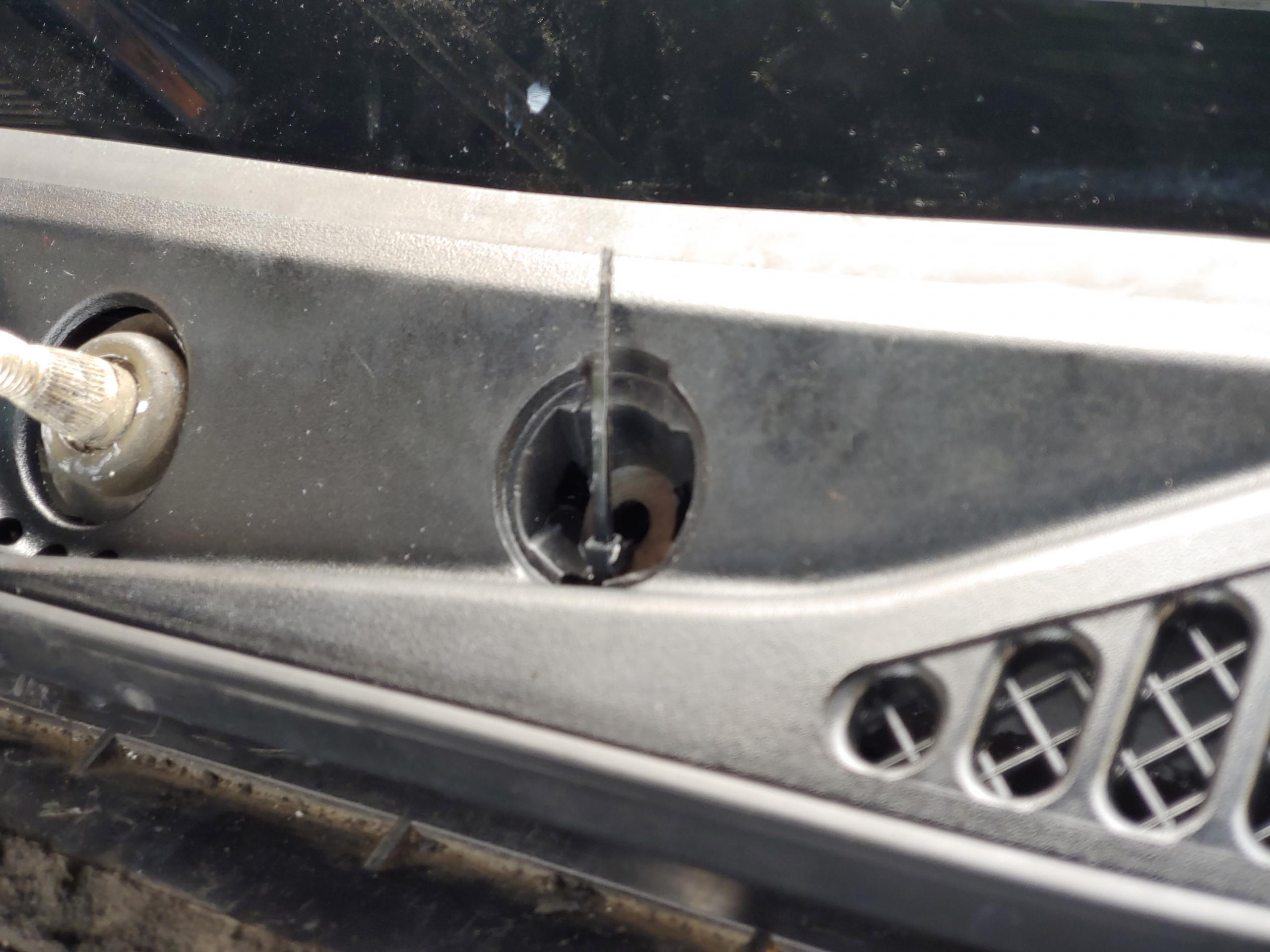

I removed the whole linkage, stripped it, cleaned it thoroughly and gently sanded the contacting moving parts with 1000-1500 wet and dry. Greased up the moving parts and refitted. A massive improvement. Sorry I didn't take any pictures during the refurb but here's some videos of the results. (I did manage to refit the whole thing 180 degrees out the first time - probably as a result of not taking any photos as I went! So the wipers tried to go down rather than up.) Also steeped the whole nozzle jet in limescale remover overnight and got my spray back to a good level. Think that's why I started it in the first place but got adventurous.
The middle securing bolt for the scuttle needed cutting off as the captive below it was spinning. Bit of an awkward replacement in place now with a 10mm nut below which now needs held with a particular spanner to remove. Picture here shows initial cable tie replacement attempt. Hey ho, worse has happened. Took the opportunity to give the scuttle a real good clean. Made quite a difference being able to get right in about it off the car.
Anyway, not a terribly difficult job if you've got the time, the space, the patience and the attention to detail to put it all back together not 180 degrees out. Couple of circlips in there so you'll need to have the right pliers for them. Yes, I've definitely got 'the slap' on high speed but it seems to work for now at a decent tempo so a worthwhile fix if you've not other option.
