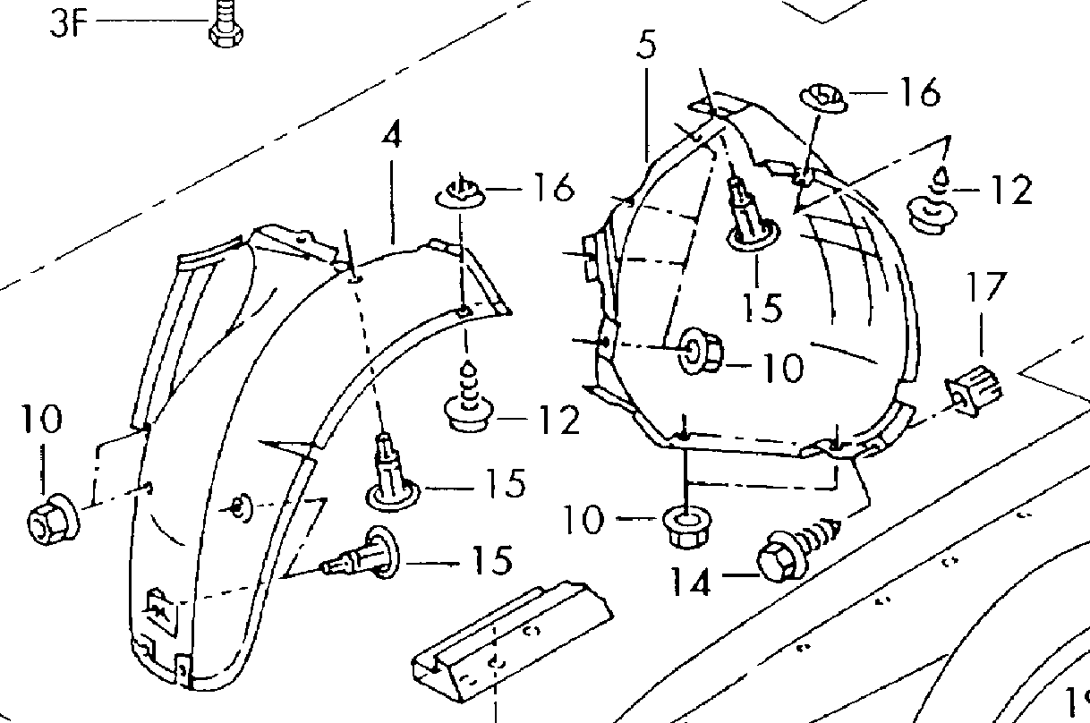

Anyone happen to know what these are?

There are various ones for the wheel arch liner. The attached image shows them. They are as follows:
#10 P/N 171201969 - Hexagon collar nut (plastic)
#12 & #14 P/N N90250001 - Oval head panel screw (metal) - goes through lip of wheel arch
#15 P/N 4D0807300 - Spreader rivet (plastic)
#16 P/N 443821699 - Clip (plastic)
#17 P/N 811807577C - Insert nut (plastic)

brilliant thanks for that
