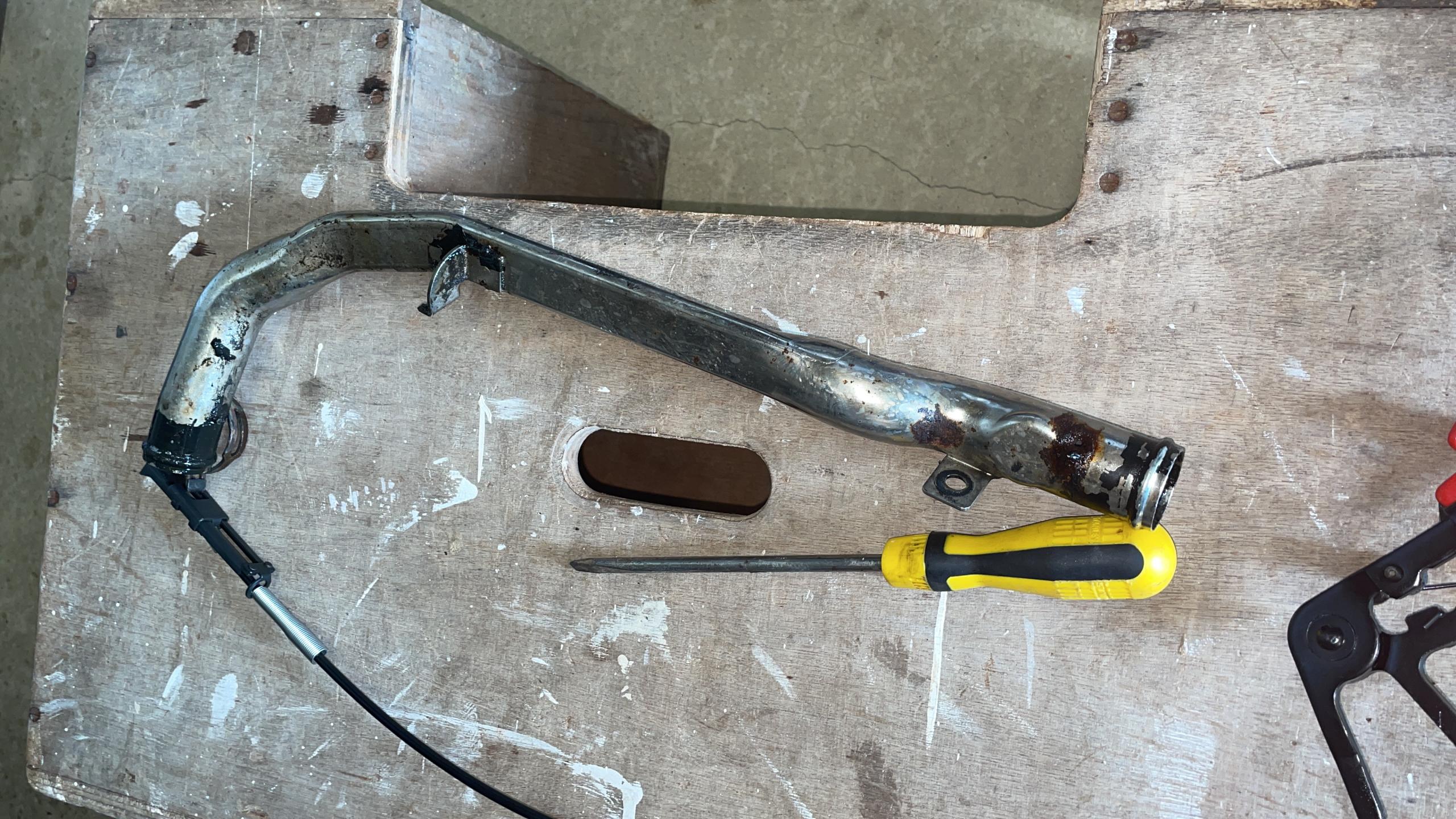

The bugger is out at last
Note the corrosion of the clip, I think water was getting trapped between pipes corroding from outside
Next task, get the replacement in and put back together

I thin these were sandblasted or similar before powder coating, the blasting smoothed out a rotted through hole, then powder coat over

The coolant pipe problem seems to be resolved at second attempt. Got a couple of secondhand pipes from the US sent directly to MJ, which she got balsted and powder coated, one of which is now installed and am not seeing any coolant loss.
