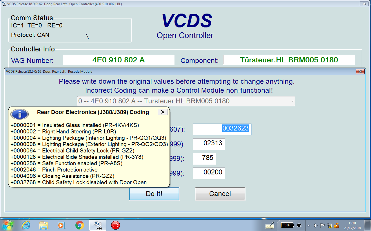

Hey you don't happened to have this info for the d4? Currently looking to retrofit rear blinds but having trouble finding how to code my door modules.
Afraid not. However, it should be along the same lines. I suspect with the D4 that within VCDS, it will have 'Long Coding'. Essentially, instead of adding up a list of numbers based on what is fitted, there is a series of tick boxes for each of the options. You just tick/untick the relevant option(s) and save it.
Since you're retrofitting them, you will need to code other modules as well. Based on what I did on the D3, in addition to the two rear doors, you will also have to code in the Driver's Door (42), Central Convenience (46) and Roof Electronics (38). The numbers in brackets refer to the relevant module address, but with the added complexity in the D4, there may be other modules involved.
If you check the following thread, I mention what the relevant coding is for each of the modules in the D3, which should give you an idea of what to look for in the D4:
https://forum.a8parts.co.uk/showthread.php?p=151305
