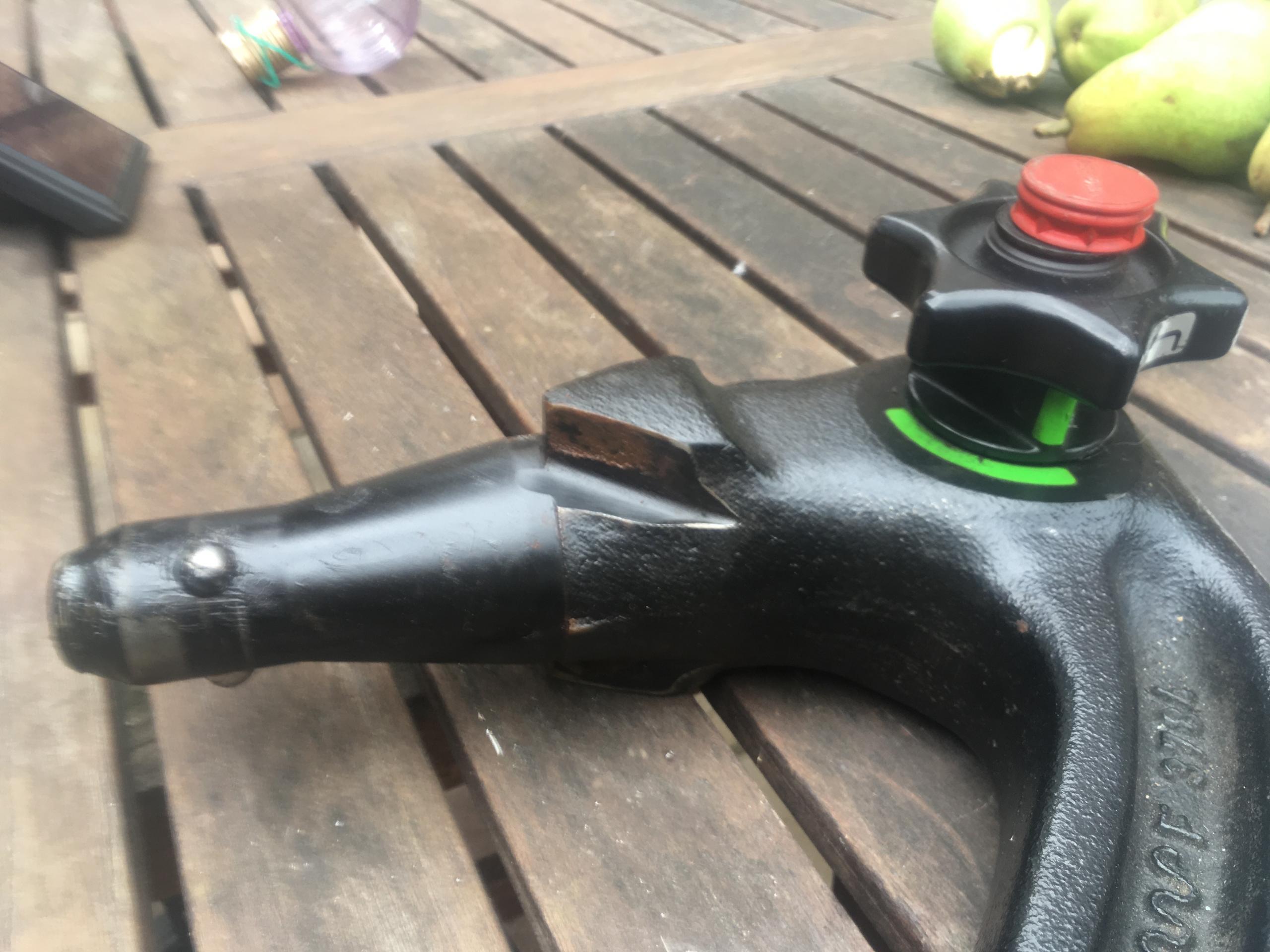

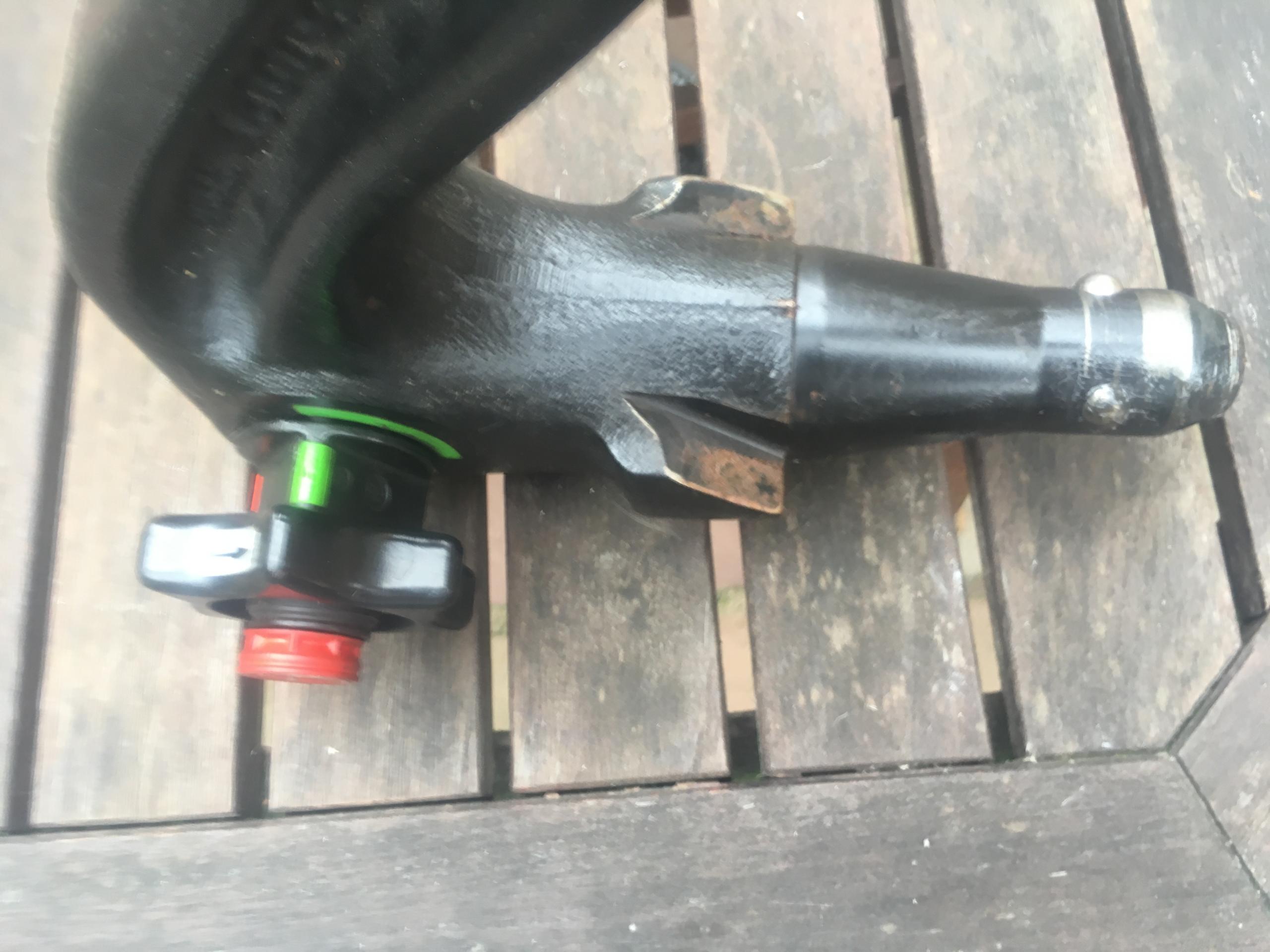

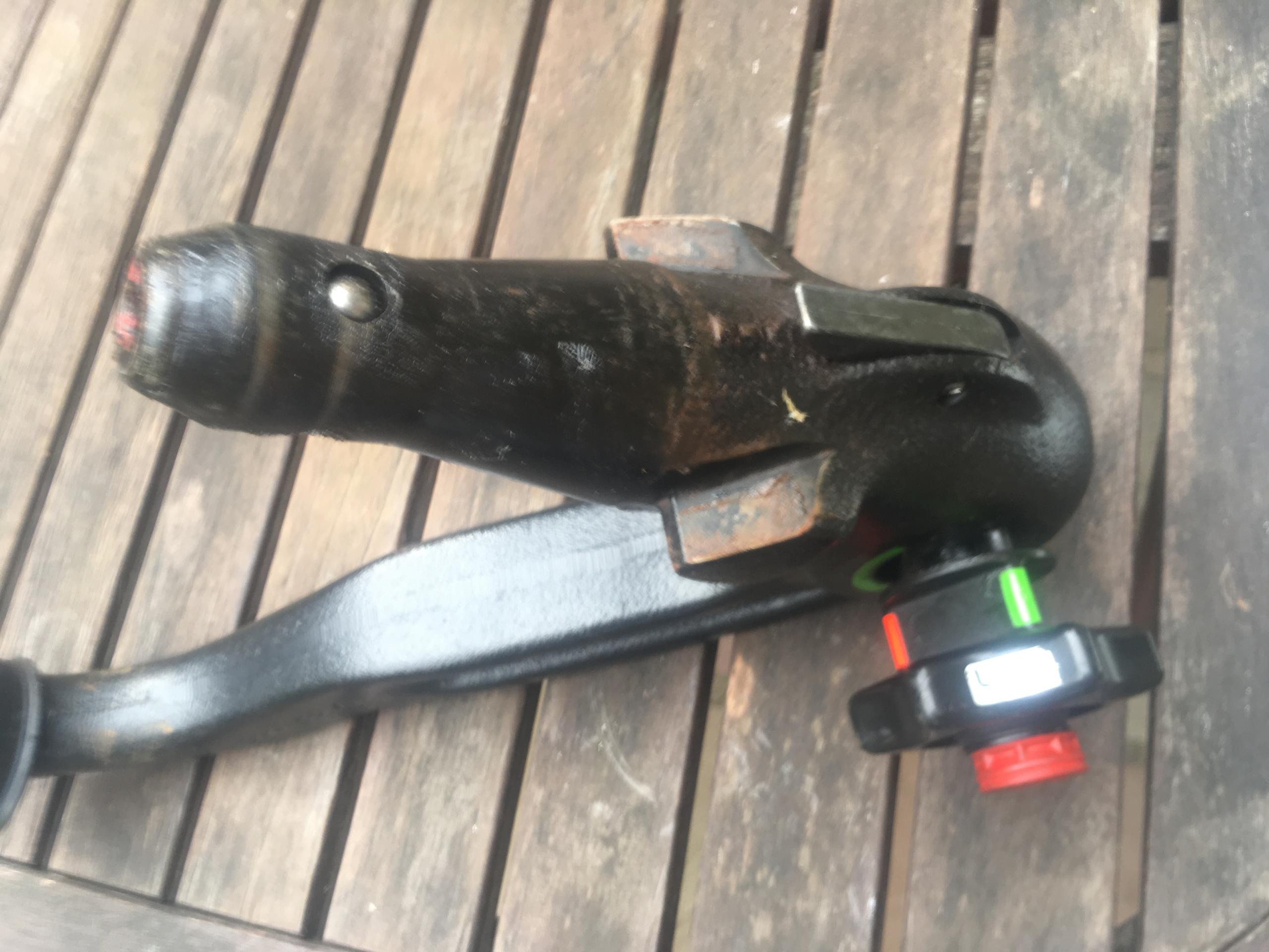

OK, tried it on mine, so here are instructions and photos.
Photo 1 is the 'resting' position, with the balls out. Turn the key clockwise, pull on the knob and twist it. It will lock into place and the balls can then be pushed in, as in photo 2. It's now ready to insert onto the tow bar.
As it pushes in, the lever on the side of the tow hook is sprung and the balls are then released to lock the tow hook in place (as in photo 3, but obviously I didn't insert it). The mark must be aligned with the green section.
NB the key must now be turned and removed to ensure that the tow hook is fully engaged.

Old 22nd August 2024, 01:49 PM
Photos as promised (I hope!)
