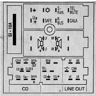

Note: Probably relevant/important that this is NOT a Bose system so I think the front speakers are driven directly by the RNS.
So it should be the 8-pin connector next to the multi-block/multi-colour connector and specifically the pair nearer the fuse.

I can't recall exactly how the plugs fit but I don't expect it's easy to swap left and right.
Looking at the back of my old RNS-D, the block connector for the speakers has 8 female spade connectors. In theory, you 'should' be able to remove them from the connector with one of these terminal removal tools.
A bit of hassle, as there's not a lot of length to those looms, and you'll be trying to remove them, whilst the loom is pretty much still in the slot where the RNS-D sits. Then again, removing the door card to get at the speaker is no easy task either.

Sean, I'm thinking that if "reseating" the block connector doesn't work I'll make up some short patch leads male-to-female spade connectors (of the right size).
Then I can connect the RNS-D outputs to the "other" sockets on the loom.
That should tell me if the issue is in the RNS or the wiring/speakers.
