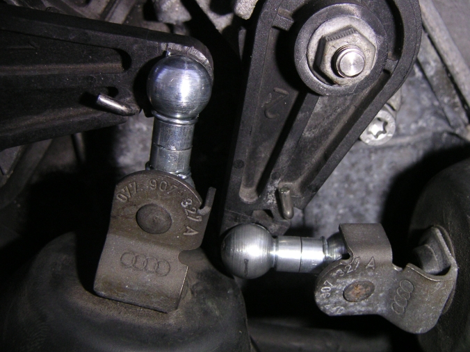

Thanks Mkoneman!
I wish there was a off-the shelf solution when I fixed mine 2 years ago. I ended up using stainless ball joints, had to cut them and tap them. Audi dealer wanted £160 for new arms & bellows.
Ben, thanks for the heads-up about the flap itself seizing up. Hopefully I haven't damaged anything. Now I see Audi's logic behind using plastic arms.

Old 12th July 2011, 05:23 AM
FireStorm FireStorm is offline
Posts: 212
My warranty covers the whole unit with a £50 excess.
would i be better to get the unit replaced for £50 inc labour and new arms, or just buy the aftermarket arms?
and just making sure it covers D3's 4.2s
Old 13th July 2011, 08:43 AM
Simon Wallwork Simon Wallwork is offline
Location: Bulgaria.
Posts: 302
Just to add my 2p worth.
These things actually make a difference if not working ( if not working properly, they make the car a lot less powerful and it uses more fuel)- and they need to work even for low power settings.
My n/s one was stuck, but when fixed the car was noticably both more powerful and fuel efficient, especially at LOW power levels. ie in normal driving, once fixed, it needed less pedal for the same result.
Both bellows should collapse (and operate the things they're attached to) on startup.
My cars average fuel DIS was 23.1 mpg before I fixed it. Now it's 21.3.
It's done 30,000 miles since I last reset it, so it must be WAY more fuel efficient than it was.
Old 25th July 2011, 09:08 PM
Curtis's Avatar
Curtis Curtis is offline
Join Date: May 2011
Location: durban(south africa)
Posts: 157
my car has only one vacum thing,when i start the car it doesnt collapse yet when i rev it it will collapse for a second them go back.is that normal for a pf 4.2?
