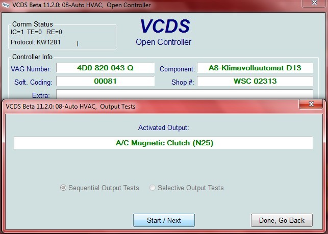

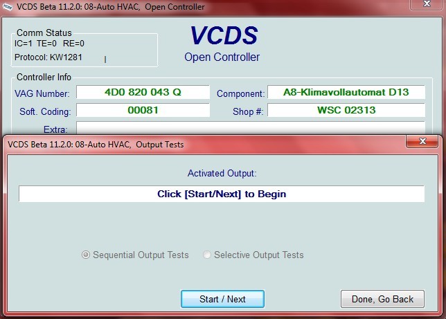

Here we go. Open VCDS to the HVAC page and select button 03 (bottom of column 3). You'll see this:
Hit start and cycle through the tests and you will see this:
Once all the tests are complete check the faults section to see if any registered. If there is a clutch fault then it is possible you have a faulty clutch. The other 2 options are low pressure and pressure switch.
