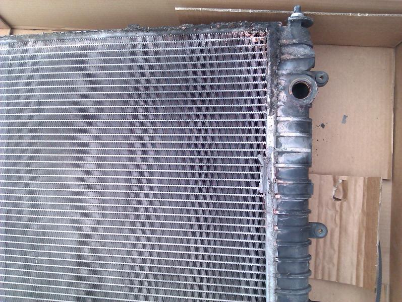

And as a bit of tragic evidence to it's untimely demise....
Strangely the expanding pool of coolant that started this adventure was coming out from the other side of the car to the leak!
