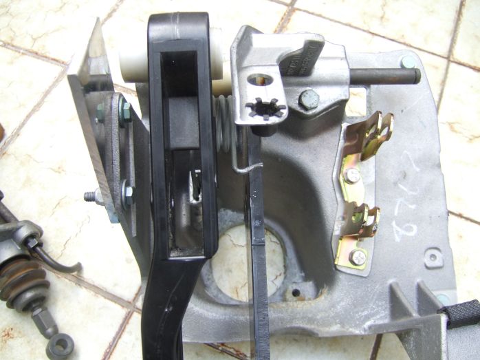

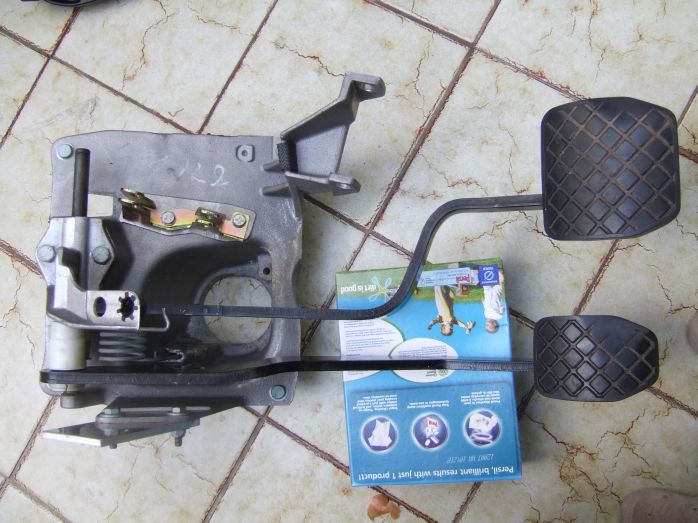

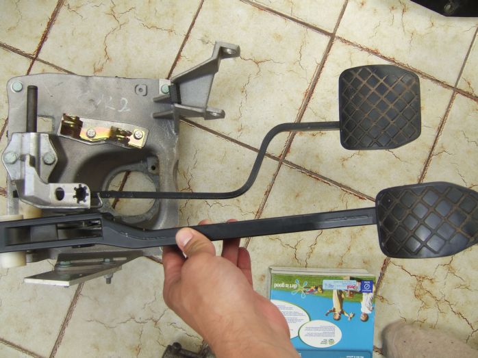

I have spent a lot of time lately thinking about the best way to implement a 3-pedal box into the current RHD S8 pedal box mounting point.
After a lot of crazy ideas, like moving the brake booster and using the LHD pedal box, or using a thinner brake booster to squeeze into the gap in the chassis, I have decided that the best approach (for me, limited resources etc) is to try and mount a clutch pedal on the existing RHD pedal box with minimum modification. In other words leaving the accelerator pedal and the brake pedal as they are, leaving the brake booster where it is, not cutting the chassis in any way (all customising to be done on the pedal box casting itself).

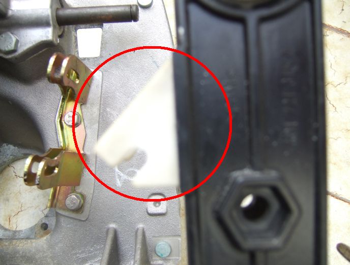

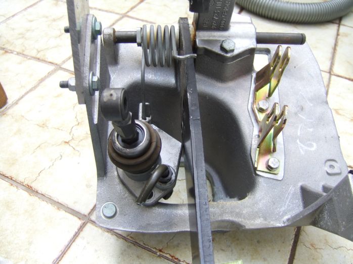

Looking at both the LHD manual and RHD auto pedal boxes, I realised that there is enough room on the pedal mounting shaft (RHD box) for another pedal on the right side of the brake pedal. The white pedal bearing material would have to be cut down a bit to fit it but it will fit. The question is will there be enough room for the clutch master cylinder and the clutch pedal torsion spring without interfering with the brake pedal?

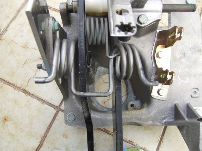

In the following pictures I will attempt to show that it looks like there is enough room for the clutch master cylinder, and there will be enough room for a custom torsion spring (web research shows this need not be expensive, in the region of
£50). The LHD torsion spring wastes a lot of room for the clutch pedal pivot point as the LHD alumminium clutch pedal is very wide. Using a steel clutch pedal, or the LHD brake pedal as the clutch pedal, would free up a lot of room for a narrower torsion spring maintaining the same number of coils and the same spring constant, that would actually fit between the side of the pedal box and the brake pedal (see pictures). Alternatively, it may be possible to use the LHD aluminim clutch pedal, however due to its width a torsion spring with fewer coils would have to be designed.
If you have a look at Tozo's S8 conversion post you will see that his clutch pedal is a steel type pedal of thin design, not the wide aluminium pedal like in my picture.

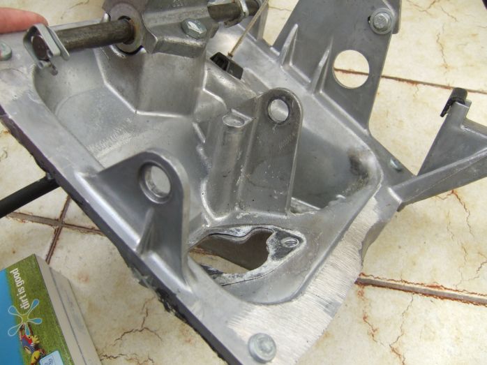

Alternatively the LHD brake pedal looks like it can be converted into a clutch pedal without too much modification. It would need a new mounting hole for the clutch master cylinder, and a mounting point machinde out to mount the plastic torsion spring swivel mount (circled red in the picture). Also the actuation mounting of the master cylinder would have to change to a fork type mounting to go either side of the steel clutch pedal. Fortunately it looks like the brake booster fork actuator that attaches to the brake pedal looks ideal for the job, it would just need cutting down to the right length and tapping to screw onto the top of the clutch master cylinder.
The main task would be to weld onto the RHD pedal box a mounting point for the clutch master cylinder and a mounting point for the torsion spring. Luckily one mounting point for the left side of the torsion spring already exists in the form of the protective bracket on the left edge of the RHD pedal box. All that needs doing on this side is to drill / machine out a hole for the left side of the torsion spring.
The right torsion spring mounting and clutch master cylinder platform can be either made from scratch, or cut out from a LHD pedal box and shaped to fit the RHD pedal box.
Also the Brake pedal torsion spring would have to be moved to the right side of the brake pedal, this being the only modification required for the brake pedal.
Another unresolved minor issue is the placement of the hose from clutch master cylinder to slave cylinder. It looks like the A6 hose is a good bet as that car also uses the 01E gearbox. I bought a LHD hose however it looks like this will be too short and of the wrong shape.
Hope this is a useful idea for anyone interested in doing a manual conversion.
*I forgot to mention the clutch safety switch. This can easily be mounted onto the RHD pedal box side bracket using either a custom made piece of aluminium or just chopping off the stock mounting from the LHD casting that mounts all the brake and clutch sensors. Then just bolt or weld onto the RHD pedal box side bracket.

Similar approach I'm looking at, Goran. I purchased an Audi A4 B5 pedal cluster. I'm removing the section with the clutch pedal and clutch master cylinder, and will have this welded to the D2 box. I'm going to order a second D2 pedal box from A8parts for the purpose of this mod, as I want to drive my car right up to conversion time.

TozoM8 has been very helpful, he made a custom clutch pedal himself from steel. I dont think there is a stock steel LHD clutch pedal. I'm going to go ahead an use the LHD brake pedal and modify it to connect to the clutch master cylinder either with the brake booster clevis, or by welding the steel bolt from the aluminium clutch pedal onto the LHD brake pedal and mount the master cylinder to the right side of the cluch pedal.
The LHD brake pedal is alredy usefully curved off towards the brake pedal with just the right separation.
