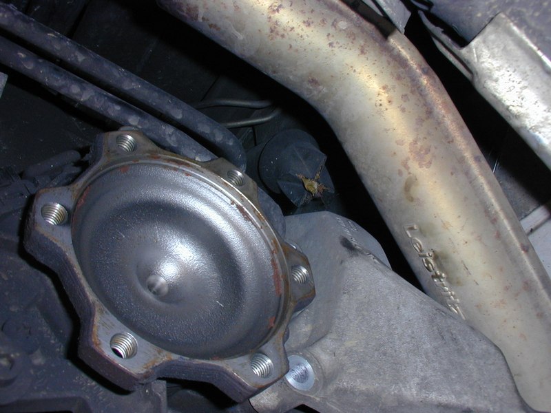

Old 23rd September 2011, 01:47 PM
here is a pic I found Guy, just for you. by PaulW of course.
http://forums.quattroworld.com/a8/msgs/25523.phtml
