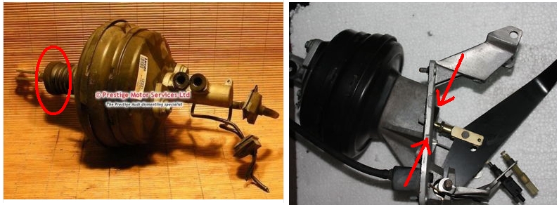

Came accross a potential major problem, with my specific clutch pedal mod at least, the boot of the brake master cylinder piston is quite wide and has to move through the area where I was going to weld on the clutch master cylinder and over centre spring mounting plate. Oops!
Back to the drawing board.
(thanks to A8 parts for the picture, and apologies to the other e-bay seller for using his picture).

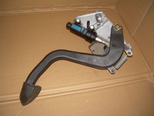

One more potential frankenstein solution, a BMW E46 clutch pedal has a nice thin looking design for the master cylinder and over centre spring mounting, maybe it could work. Shame the master cylinder is plastic, thats BMWs for you
