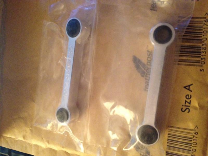

Just recieved my 1" arms from www.gruvenparts.com and replaced the broken arm on the RH (as you look at it) inlet vacum pod. Easy to do, after taking off the engine cover. Just pushfit the old off & on with the new, all done by hand. Took her for a spin and noiced quite a difference on my now 190K 2002 S8. Between 2,000rpm & 4,000 there is definately more torque and so the gbox does not need to kickdown as much. All in all a major performance improvement for £80. I'll see if it improves the 23.6 mpg average and post any changes. Well worth checking out if yours have snapped as most do and go undetected.

Yes they do have them, and as Adrian suggests they are longer than the S8 ones, but you won't be able to use the 2" arms advertised recently because I have already acquired them!
