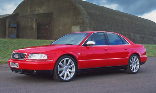

cant remember where I saw this but saved it as I too had never seen a red one either, think it looks good actually
