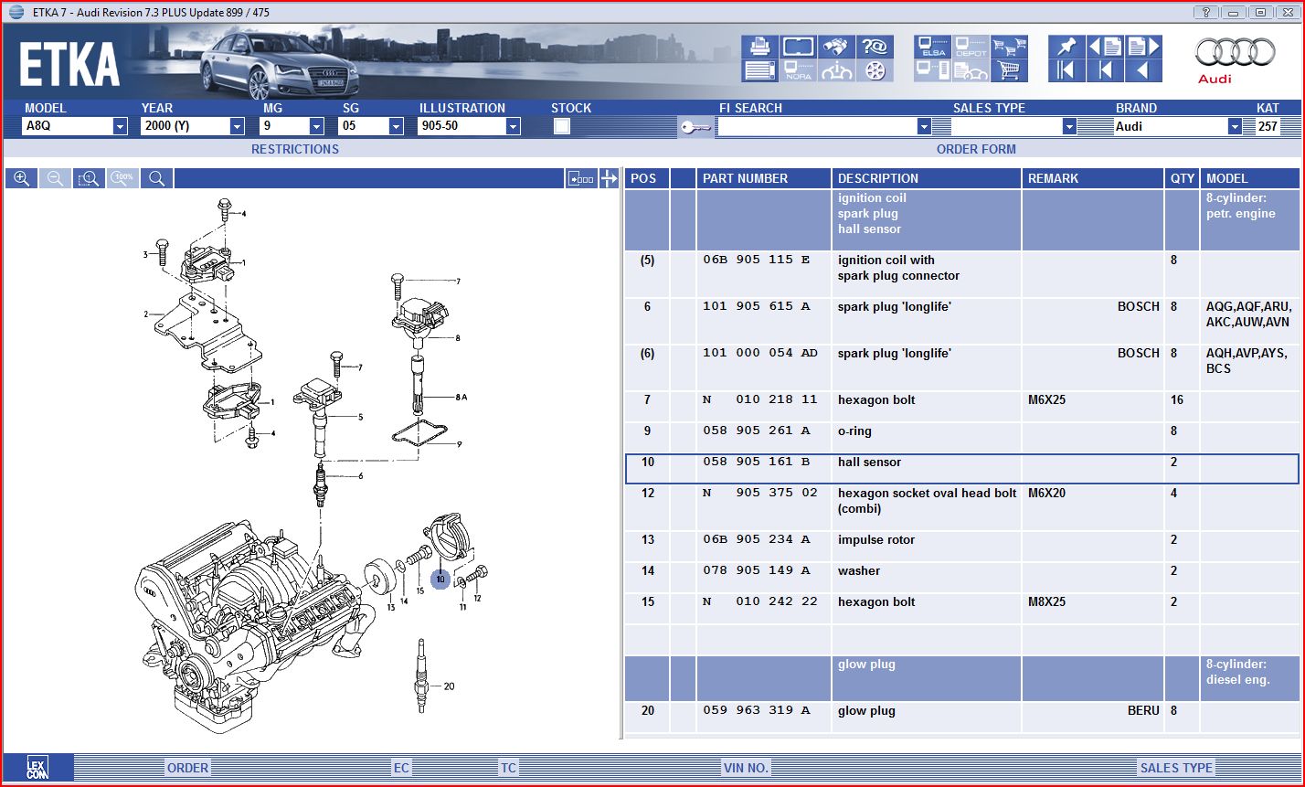

Has anyone got the part number for the AQH engine so I give TPS a call tomorrow?

If you can read .xps files on your computer, the attached zip file will extract to 2 .xps docs from elsawin
Don't know my way round Etka well enough to be sure of an accurate part number - not even sure I've managed to find a full list of engine sensors to be honest!!

Old 21st March 2012, 08:32 PM
Take a look at the attached - I presume you're after the "hall sensor" that fits around the impulse rotor? part numbers are on the graphic too
