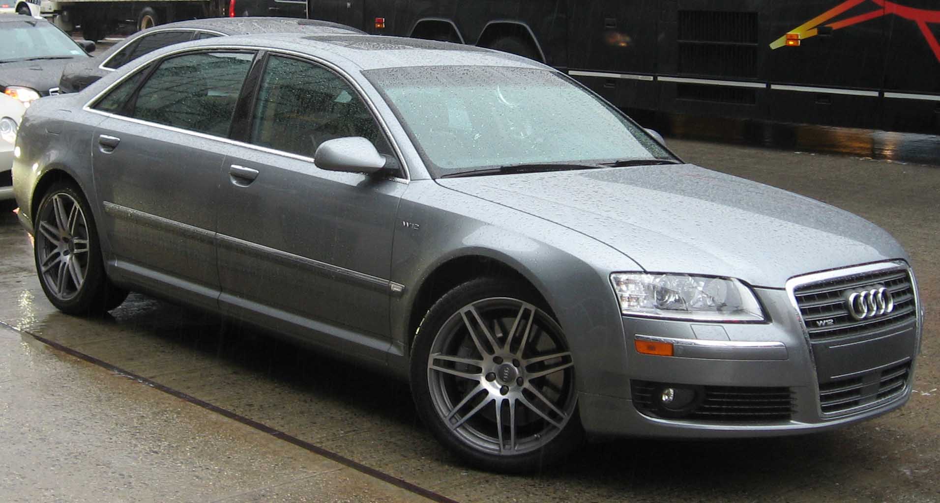

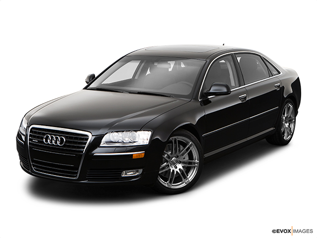

  #36
Old 20th March 2012, 09:08 PM
ID:	3007   Click image for larger version
  #37
Old 20th March 2012, 09:21 PM
But do you know what the ET of these wheels are?
  #38
Old 20th March 2012, 09:25 PM
no but nor do you! look I was merely pointing out that 3mm outward distance is not a huge amount in the world of tyres, heck tyres that are incorrectly inflated can be that much out. at the end of the day its up to Glyn to look at what space he has and make a judgement based upon that - I was merely trying to point out that the idea wasnt dead until hes done that
