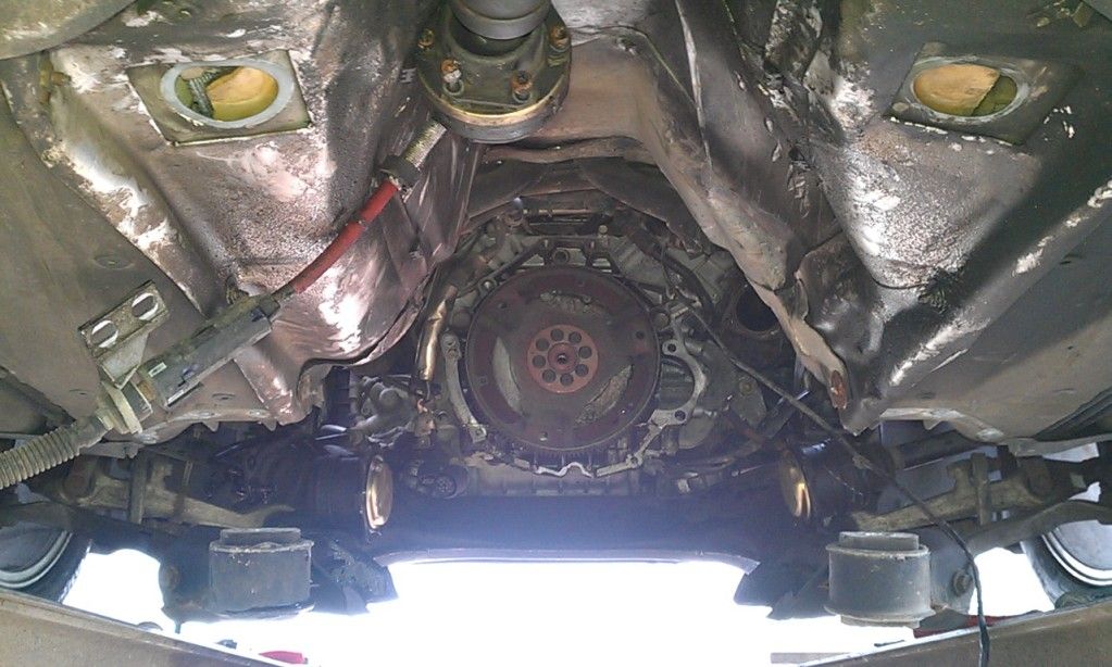

Just following on from my above post...
You can just see the bracket in this photo for the outer cable.
And you can see it having been detached in this photo showing the cable hanging out of the way.
MG
