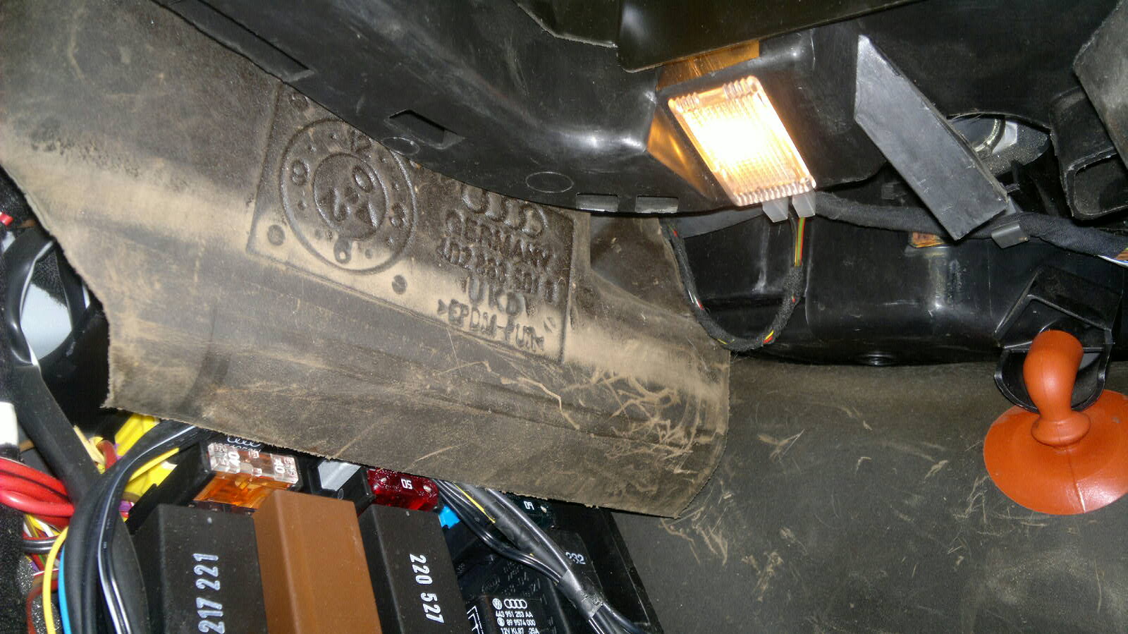

Have had the aforementioned problem a while. Have tried to locate to connections to the motor, but without any success. Can anyone put a picture on here to help please? Have also tried to locate the motor housing from inside the car via removal of the glovebox. Yet again came to a dead end as the only box i can seem to find is the housing for the relay circuits. Any help would be grateful, thank you..

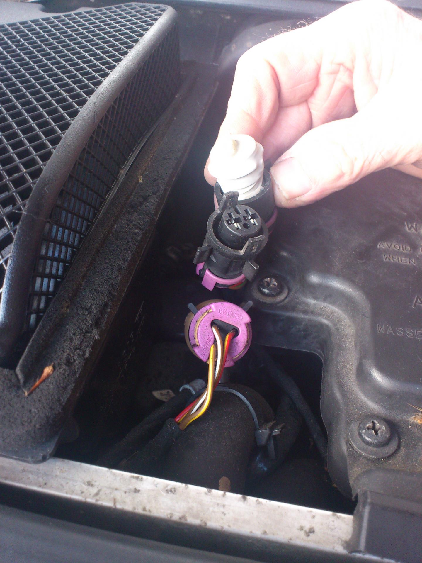

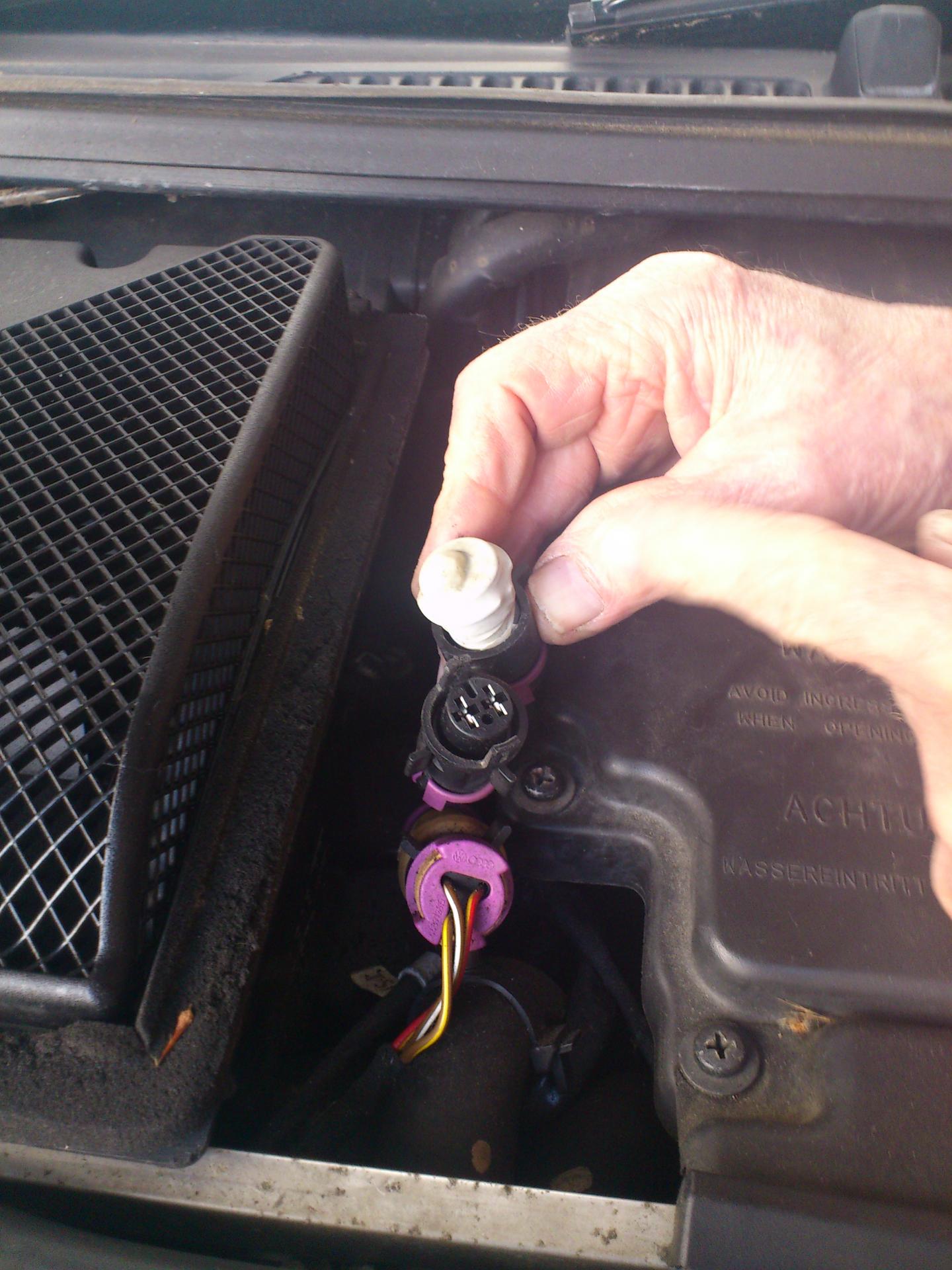

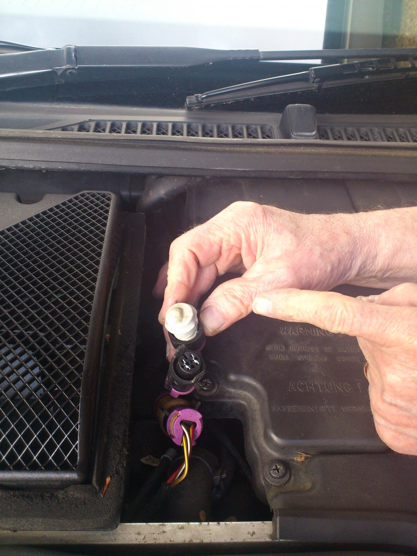

Smile Resurrecting an old thread.... UPDATE
Afternoon all.
I was afflicted with this same infernal noise which started around 2 months ago on my A8L (FL). I knew it was heating related as it started a couple of seconds after ignition on.
After switching off all heating though, I could still hear it. After reading through the forums, and in particular the posts from IT and HPSauce, I was able to locate the two plugs disconnected the purple one. Oh my goodness. What a relief it was!
So I'd like to pass on my thanks to both of you, as it has really been bugging me. Having looked at the cost of replacement, I think I will forego the luxury of heating the cabin after the engine has been switched off.
For scooter68, I've attached some pics.
My old man had the ingenious thought of cutting the fingers off of some latex gloves, and placing them on the two 'open' connectors, which should keep them nice and dry for a while. Never thought I'd have mini Durex on my beloved A8L!
