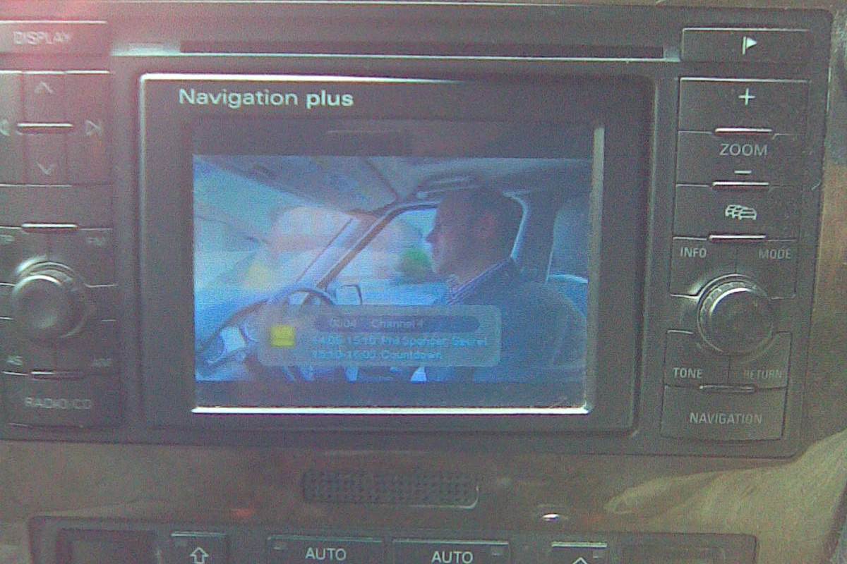

First picture, achieved only using "wet string" aerial and in "letterbox" mode from indoor testing; still plenty to do though......
