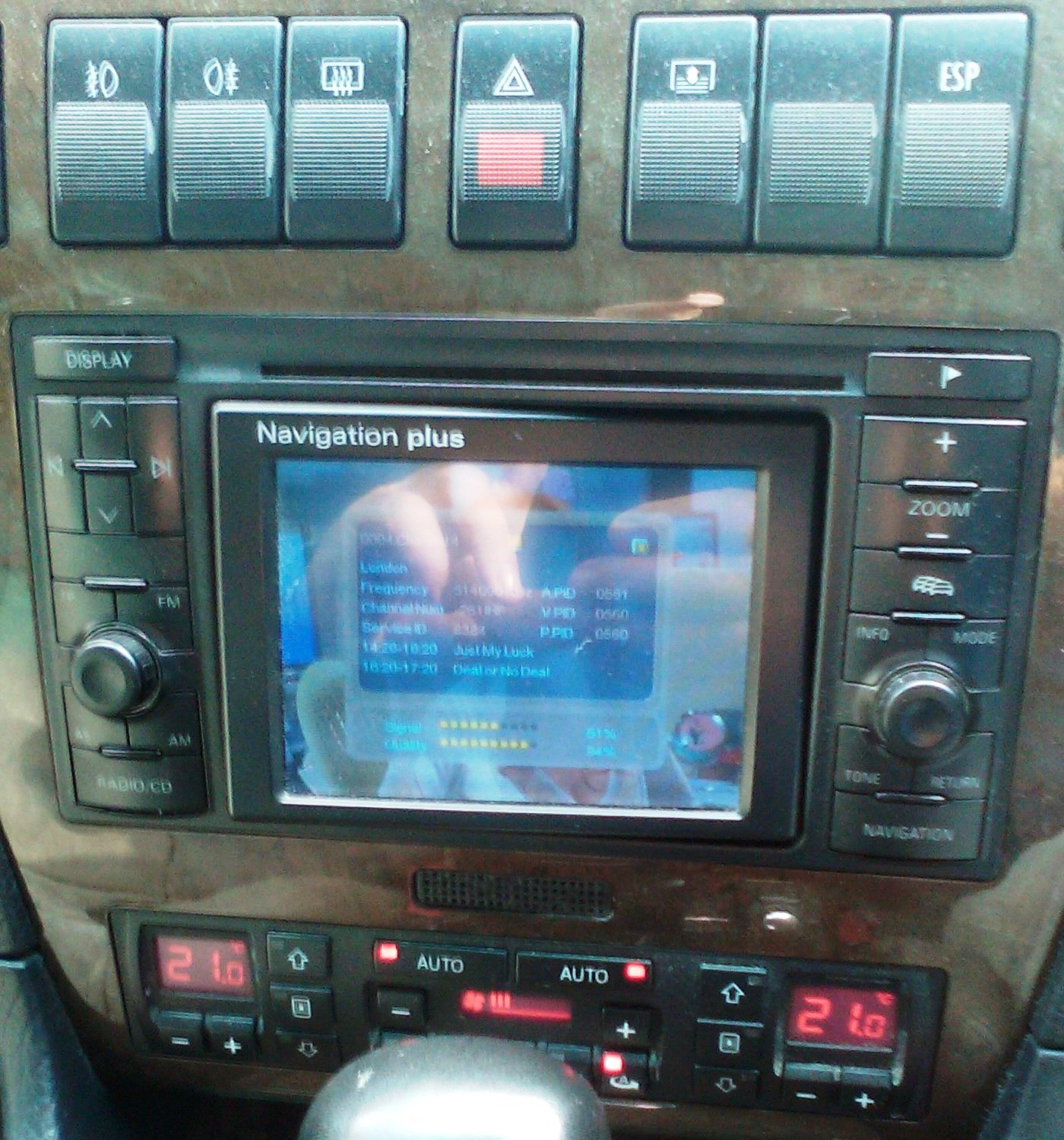

Significant progress today; it was warm and dry enough to pop out and sort out some wiring.
Ran a 12V supply to the DVB-T tuner from the old analog one, sadly has to be with the ignition on, there's nothing that goes "live" at 12V when you just turn the RNS on; fixable with a relay I guess.
Slung the remote cable into the cabin out of the boot and in the NSR door, tuned in to Radio 4 (no reception on my driveway) and went for a local drive.
I was only 200 yards up the road, getting out of my little local valley and it started spluttering into life - Gardeners Question Time I think.
Headed back downhill and off to the other side of the main big valley onto some flatter ground and it was getting much better so I switched to Radio 3 for something more soothing though it really still wasn't listenable while moving due to breakups.
Stopped in a layby used by school buses and tried TV - that was actually working very well when parked (as was radio) and only about a mile from home so still quite a distance from the transmitter (Crystal Palace).
So, a bit more tidying up to do (still waiting for some bits to arrive) and lots of experimenting with the 4 onboard aerials to try. But the principle of using the existing aerial(s) with phantom power from the old tuner seems worth pursuing.
These pictures (sorry about the reflection of my fingers) shows how a small increase in signal strength from moving out of the valley has given a huge increase in reception quality.

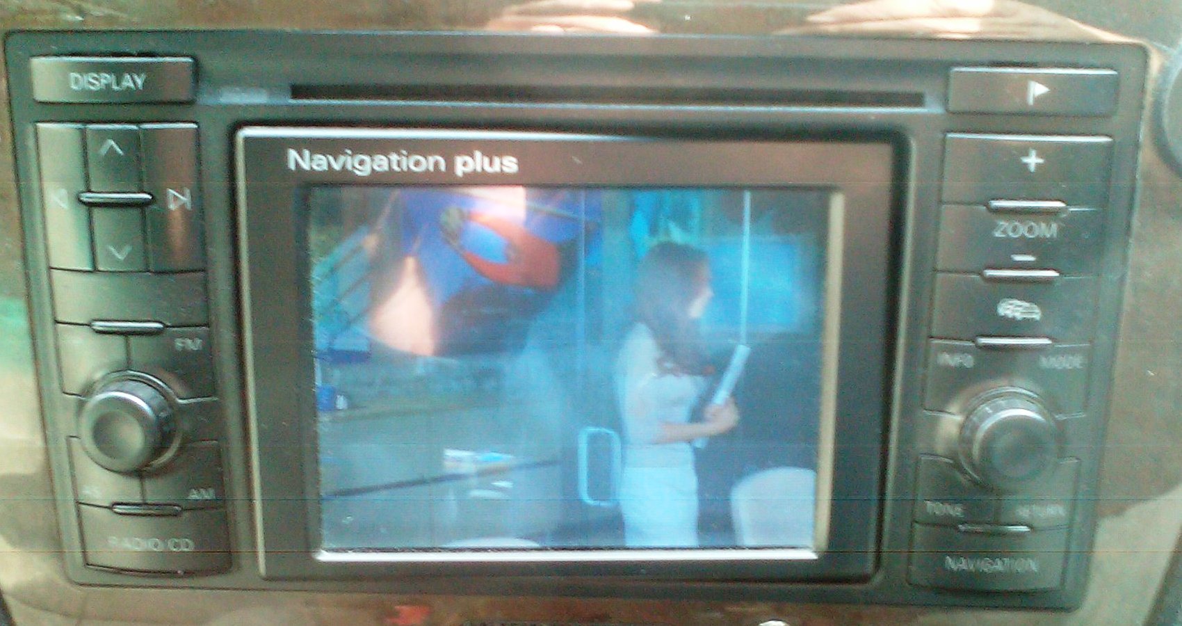

Tried a different aerial connection and a different road - more open land near M25 with no obstructions. Was able to listen to digital radio while driving and no crackles, until I hit some trees and hedges. Again, only just over a mile from home; definitely need to experiment with the aerials.
The aerials leads are numbered 1 to 4; without having to take things apart does anyone know which is located where and if they have any other characteristics that differ?
Picked up BBC1 OK while parked on an M25 overbridge:
