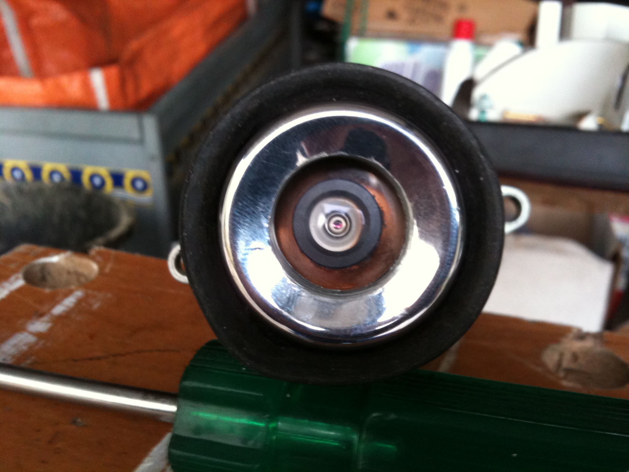

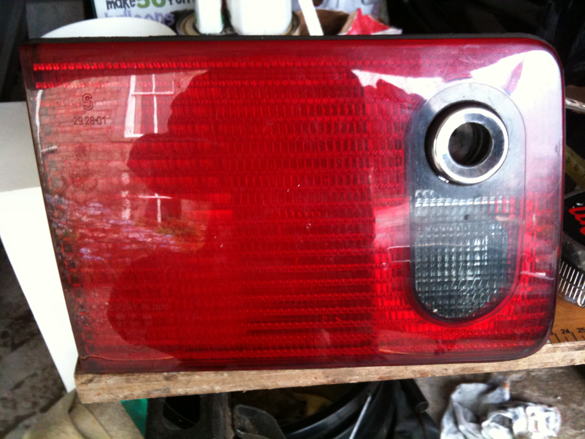

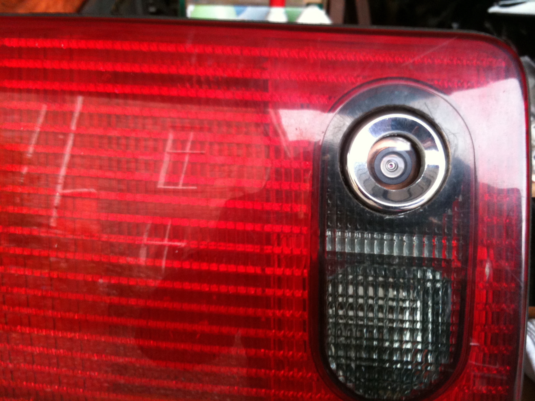

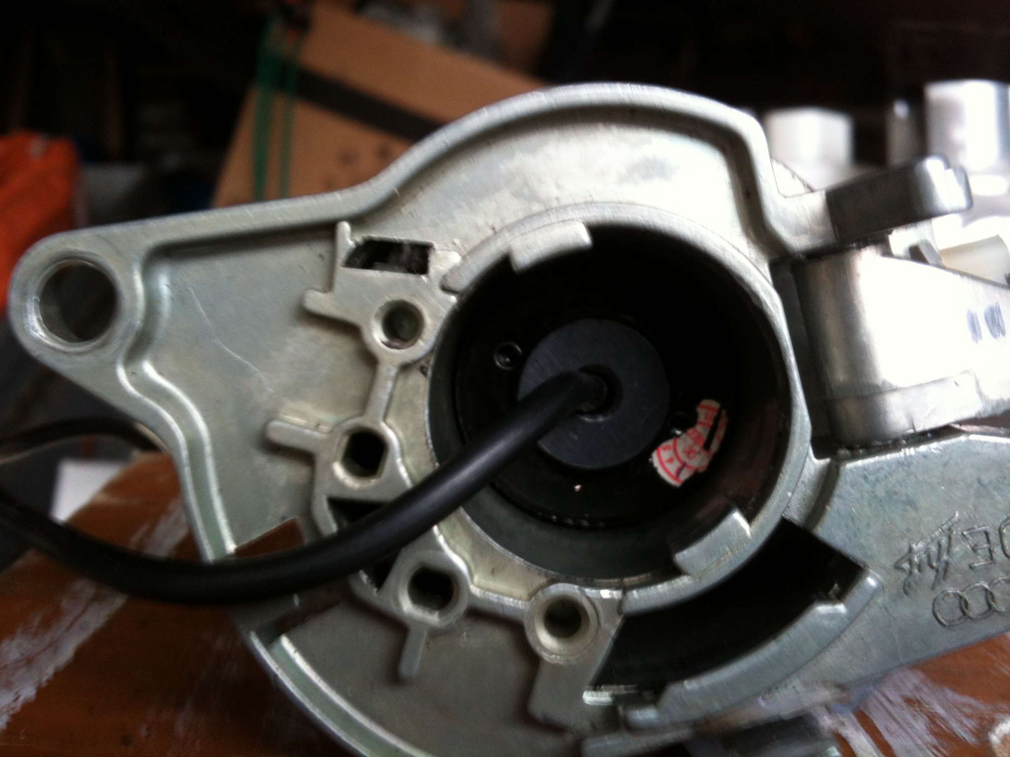

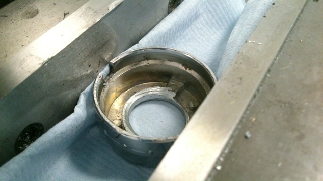

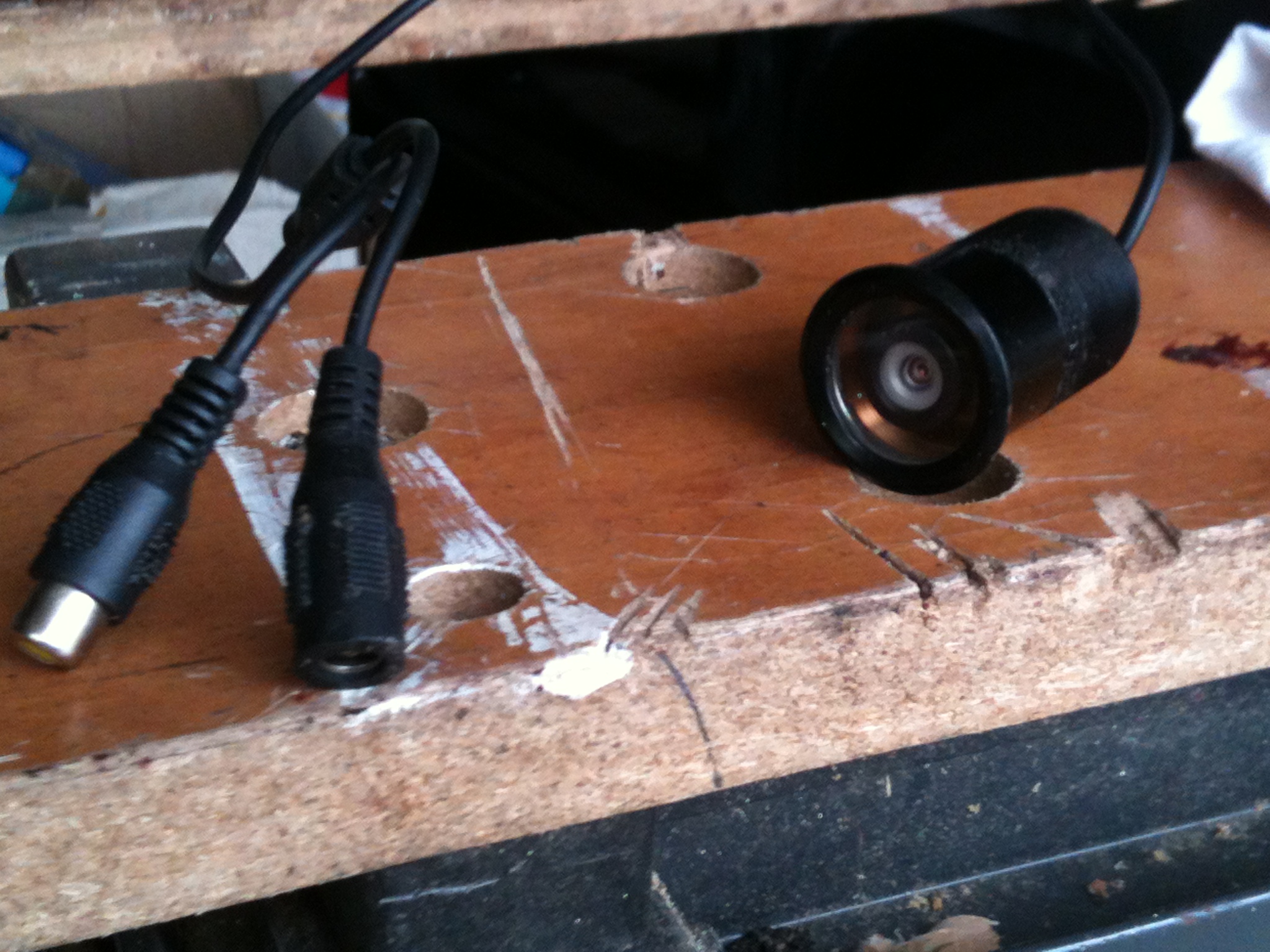

So, I've left the central locking alone for a while whilst I focus (hee hee) on the reversing camera installation on the nearside.
First I had to cut a couple of holes in a spare n/s rear light unit to take the boot lock that I'd butchered by removing the lock barrel to take the camera instead (first 2 pics).
The camera is a very neat fit into the empty lock carrier as the second couple of pics show.
But, I had to break off part of the chrome surround as there's a bit that extends down the lock barrel and that meant I had to have the remaining part machined so that the camera would fit flush inside it (pics 5 & 6).
The last 2 pics show the camera inserted into the lock carrier and then positioned loosely into the light unit. I still have to seal it and make it sit a bit more centrally before the light unit goes back into the car, but so far it's looking pretty good I think.
