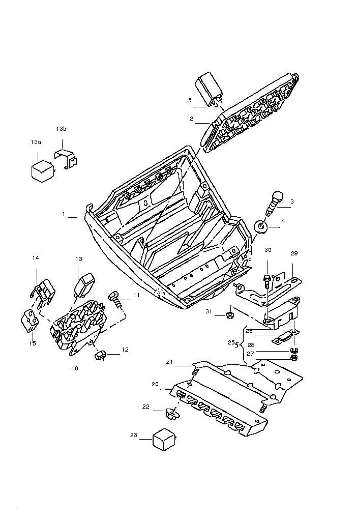

Old 23rd April 2013, 12:56 PM
Relay location 4 part No. 8A0951253A

Old 23rd April 2013, 01:35 PM
Posts: 5,160
This this thread for photos of the relay location: http://forum.a8parts.co.uk/showthread.php?t=5370
Old 23rd April 2013, 02:23 PM
Don't come here confusing the issue, i seen that thread but it makes no sence to me. Oh it's too late now you've confused me. I'm an electrical retard Jim.
So Jim, is it Realy in location 4 (like Neil says) or Relay 203 in location 7 (as in the tread you just pointed at) or relay 373 like PsYcHe says in said tread?

Is the relay position you're after. The middle tray of relays slides out. Get yourself a bit of wire and short between the live feed from the solar roof and the centre connector of the relay block and you should hear the asthmatic wheeze of the solar roof.
