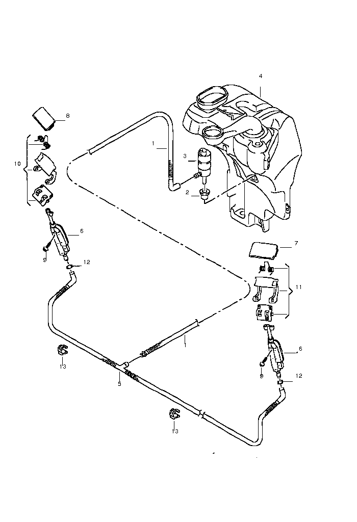

W12 headlight washer system looks like this Glynn -
bumper parts are as follows if it helps at all -

Neil if this is the picture for the headlight washer system on a W12 then how does it control cleaning just one headlight at a time as the pump looks like it is connected to both pipes together ?

ahhh . . . are you saying I've put up the wrong picture or that you dont understand how the headlamp washers work Darren?
I think from memory they do go up and down one at a time so that you don't lose lights/visibility on both headlights at once, but if it is the wrong diagram then vagcat has it wrong lol. maybe each washer pops up on some kind of signal from a controller or relay? anyone got any ideas?
