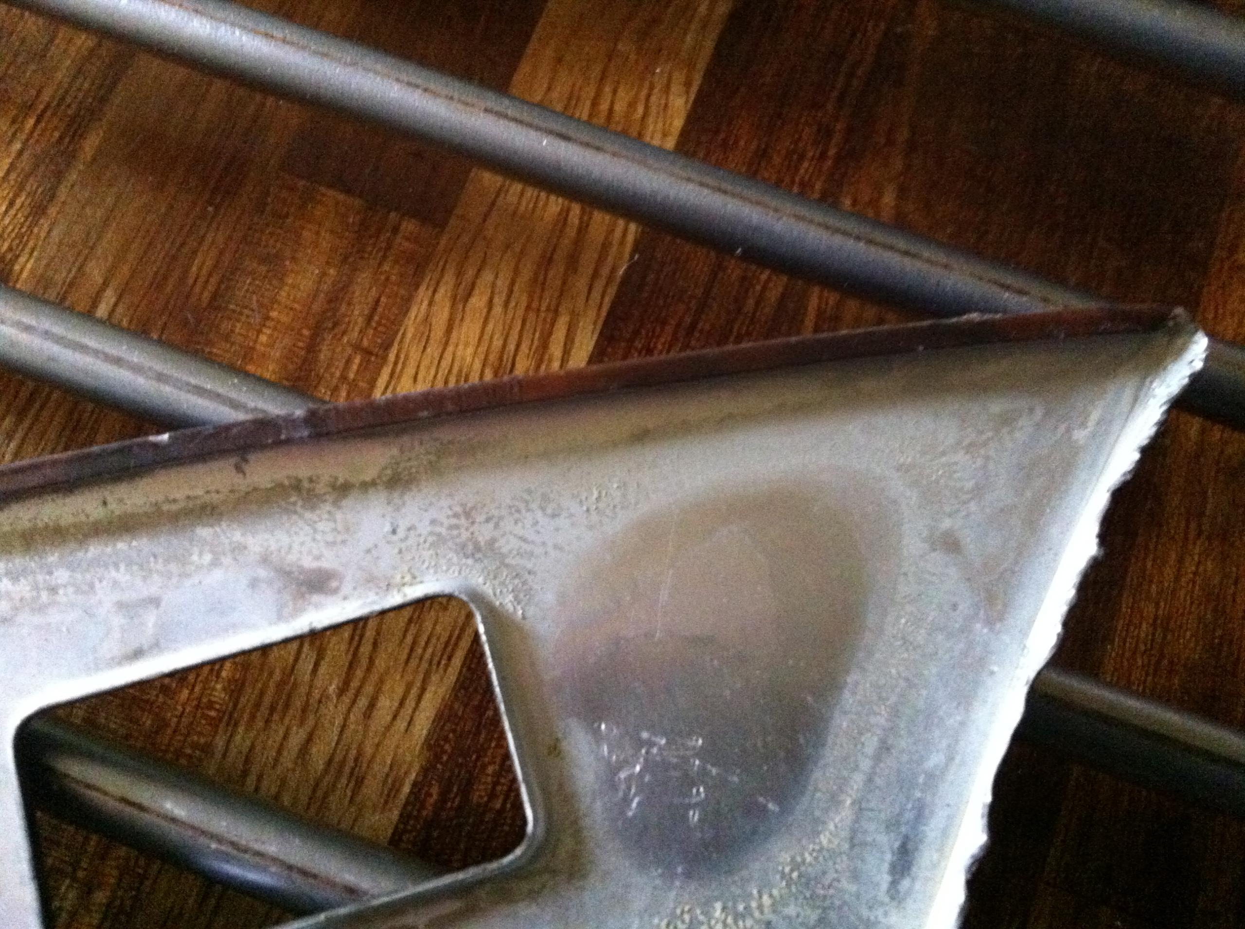

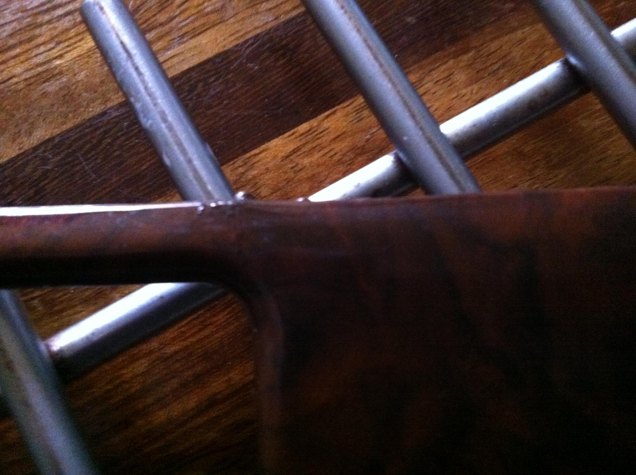

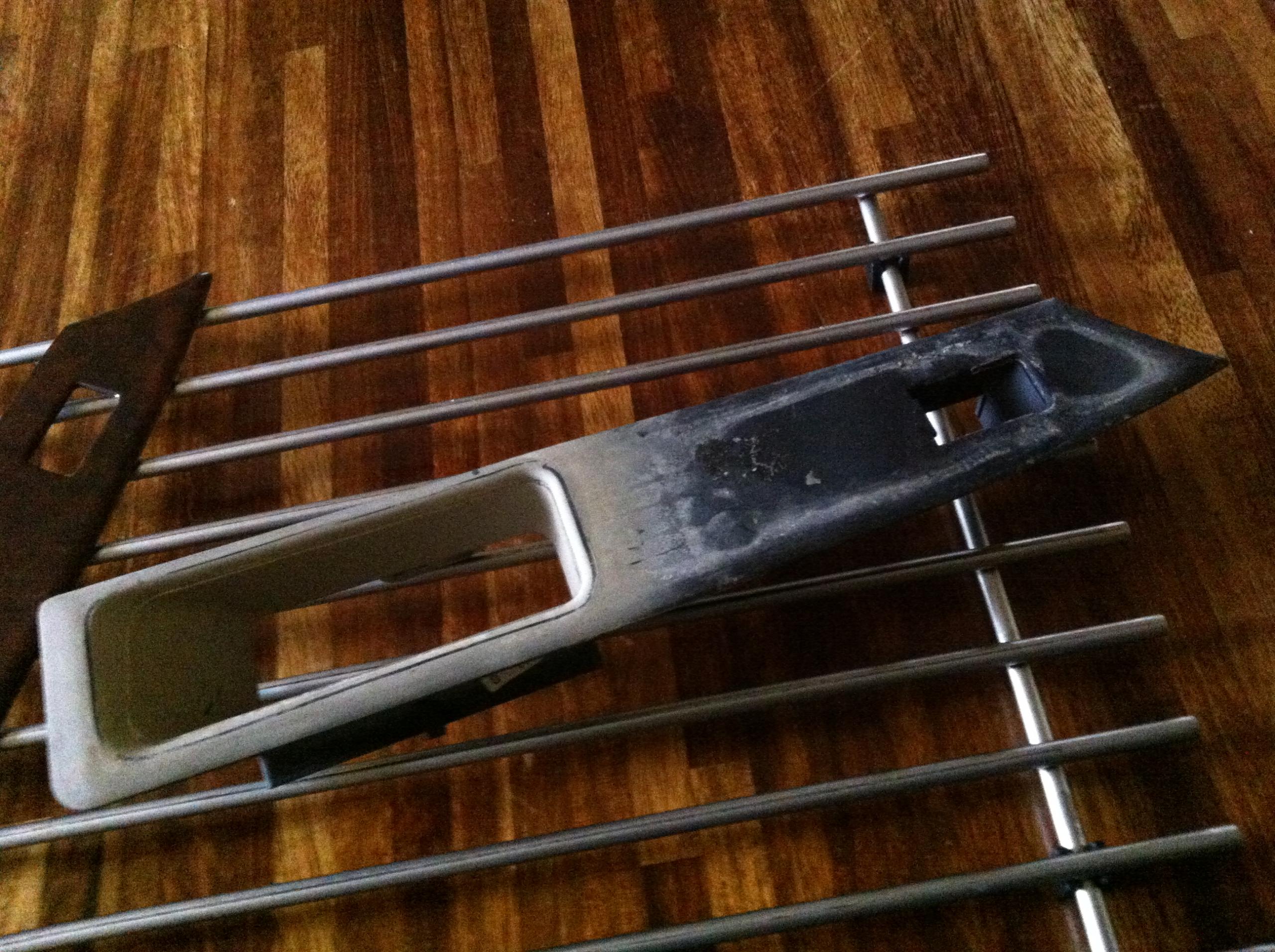

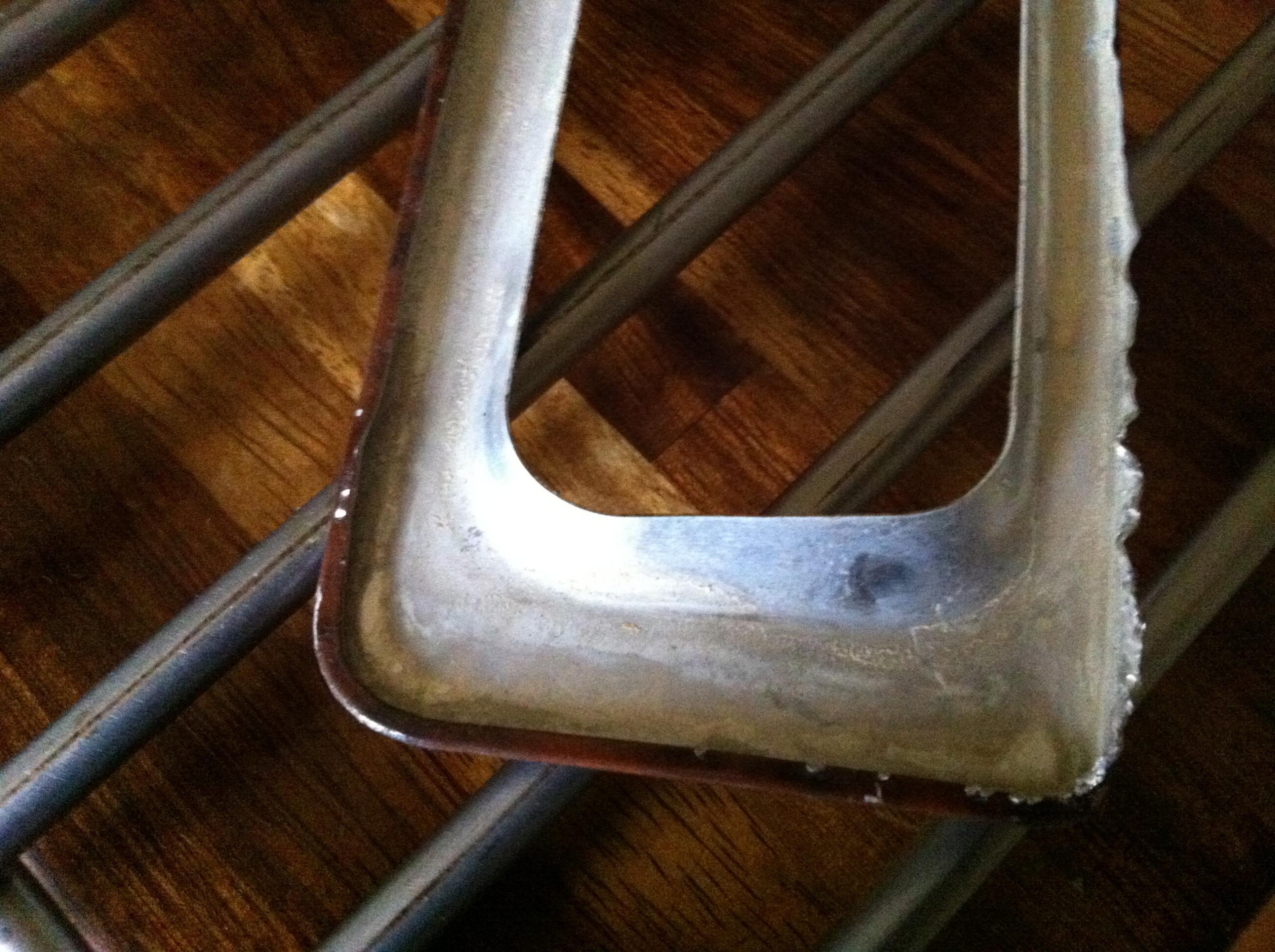

Here's a few photos to show how the 'wood' is attached and why it's not practical to remove it.
The first 3 photos show the underside of the 'wood' (actually a thin, tin-like metal) illustrating the attachment method of folding over the edge of the 'wood' plate. You can also see that, to remove it, you have to prise the folded edge upwards on at least one long side.
The fourth photo is an attempt to show the damage that this does to the 'wood' side. It doesn't show up in the photo, but there are small cracks introduced into the 'wood' at right angles to the edge.
The last two photos show the underside of the 'wood' panel and the top of the plastic door pull beneath to illustrate that there's not much glue used at all.
I've not attempted to refit a 'wood' panel, but I'd expect that to cause even more cracking to the wood effect.
