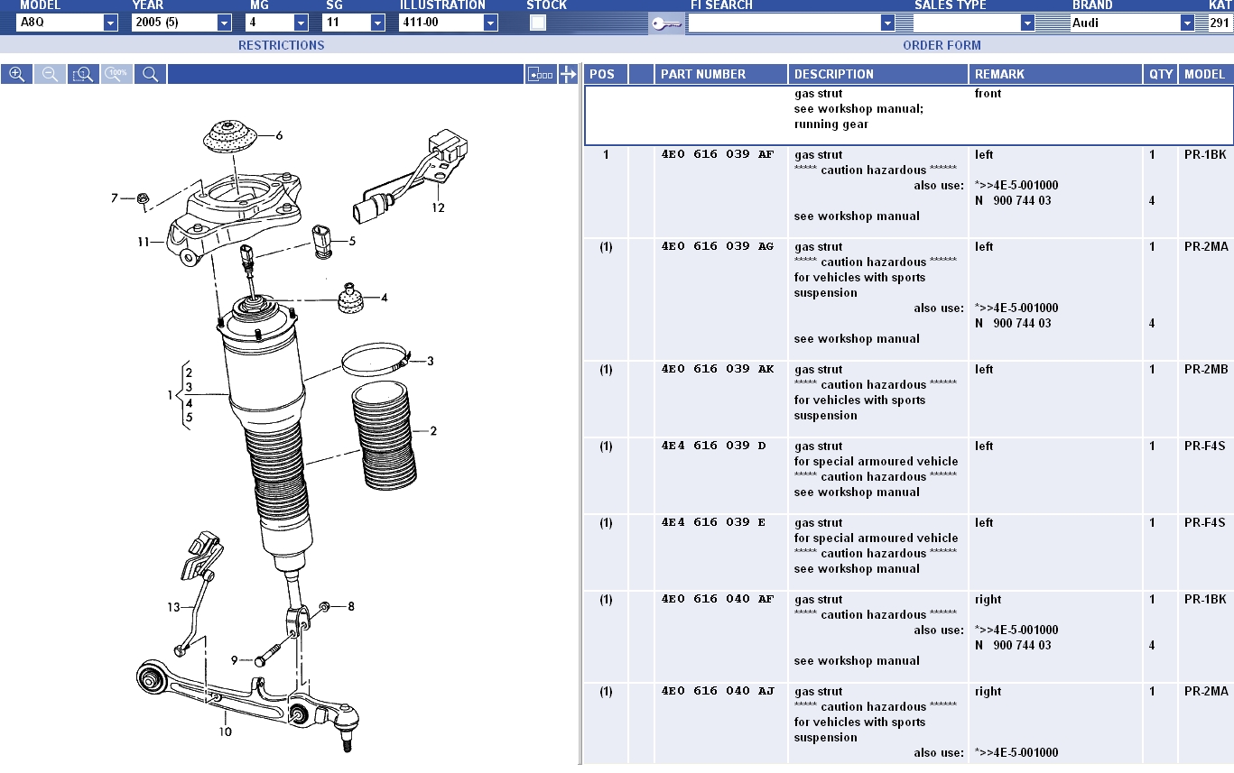

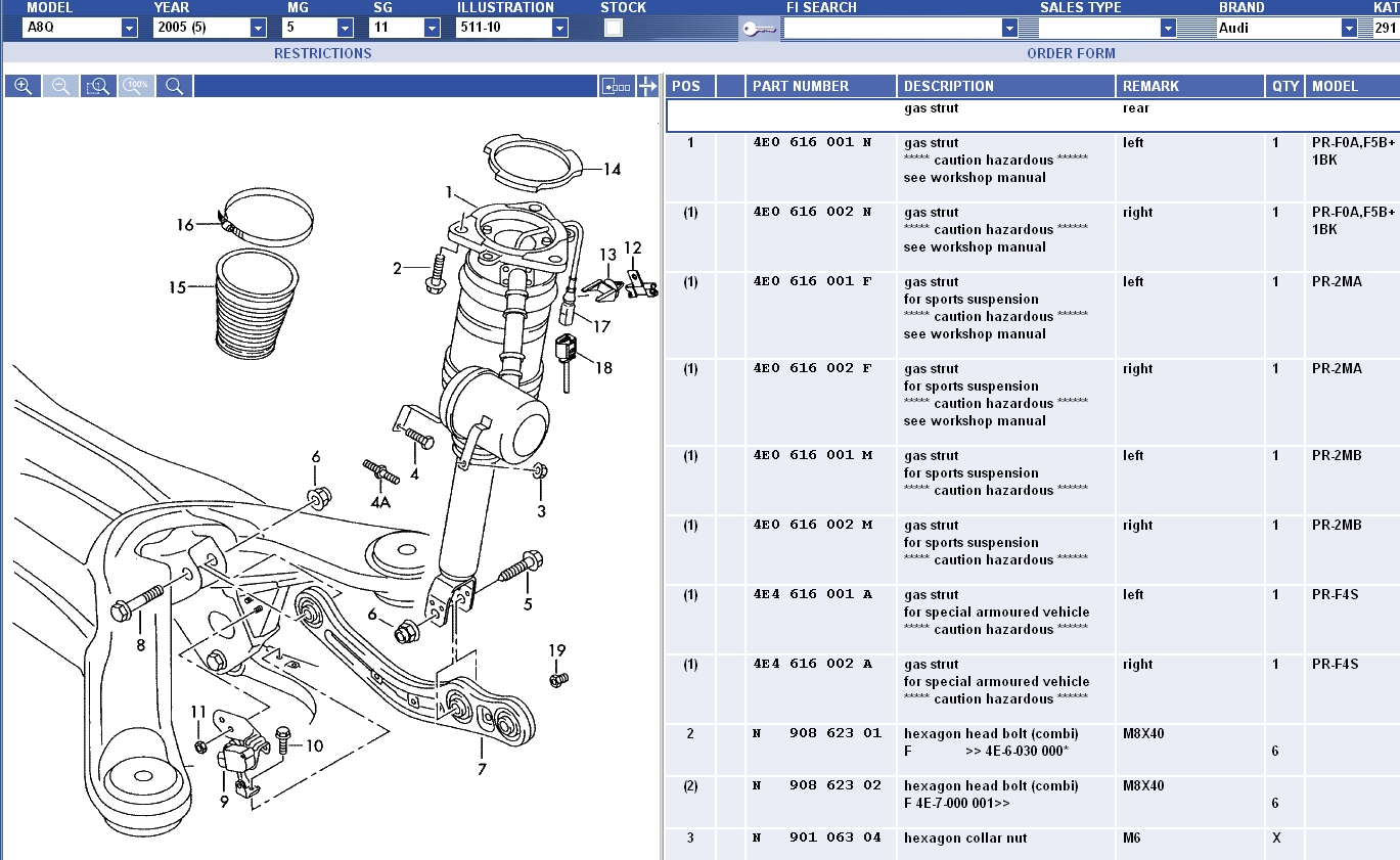

Old 20th March 2013, 04:22 PM
Posts: 3,843
As you can see below struts are different as well
ID:	5771   Click image for larger version
Old 20th March 2013, 04:52 PM
So it's a whole different setup.. Ah well
