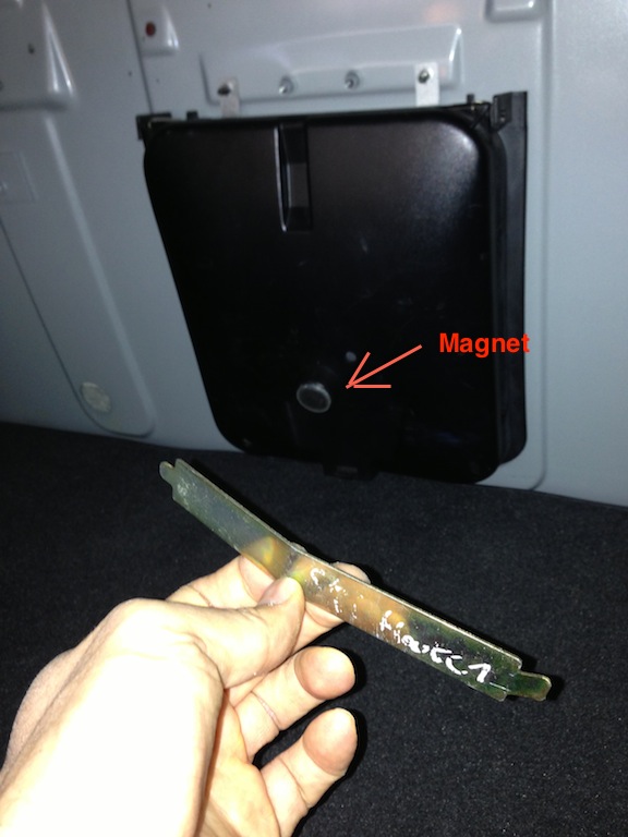

I'm retrofitting ski hatch now and there's one thing I don't understand. The hatch has a magnet from the boot side. I understand the magnet is designed to hold hatch in place when opened. But magnet doesn't work with aluminium... When hatch opens the magnet is at awkward angle to chassis so it can't engage with anything.
What that magnet is for?
Also got a part called "stop plate cover" that came with the hatch:
I don't understand where should I use that "stop plate cover". Because it is made of metal I make conclusion it should work with a magnet
Confused a bit.

Is there not a frame that goes with the ski hatch that would match up with the lugs on the metal bar you have?

If you take a look directly upwards from the base of the ski hatch opening in the boot (the underside of the parcel shelf in effect) there is a couple of slits in the metal where the gold piece of steel will slot into (apply a little pressure to bend it slightly so it will snap into position)
This will then line up with the magnet so that when the hatch is in use it keeps the cover up and out of the way.
Hope this helps :-)
No Perhaps maybe because I've got FL and the metal bar is for the pre-FL...
Hope this helps :-)
Yep, I knew it should be there, just don't understand where the gold piece should slot to May I ask for a picture please or would it be too much?
