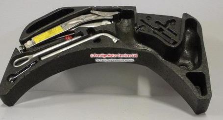

I thought there was a space in the tool kit insert?
Old 30th June 2013, 09:24 PM
I've seen one fitted in the tool section under the boot carpet, but not sure if that's a different bit of material specific to the removable tow bar install or common to all. Don't have a pic, but as a worst case scenario a roll of good quality bubble wrap and pop it in the spare wheel centre will keep it out the way without it knocking about. Not elegant but probably eaiest option
Old 30th June 2013, 09:29 PM
The big hooked space....for this....
Just realised, that's only for D2.
And this is a D3 thread.........

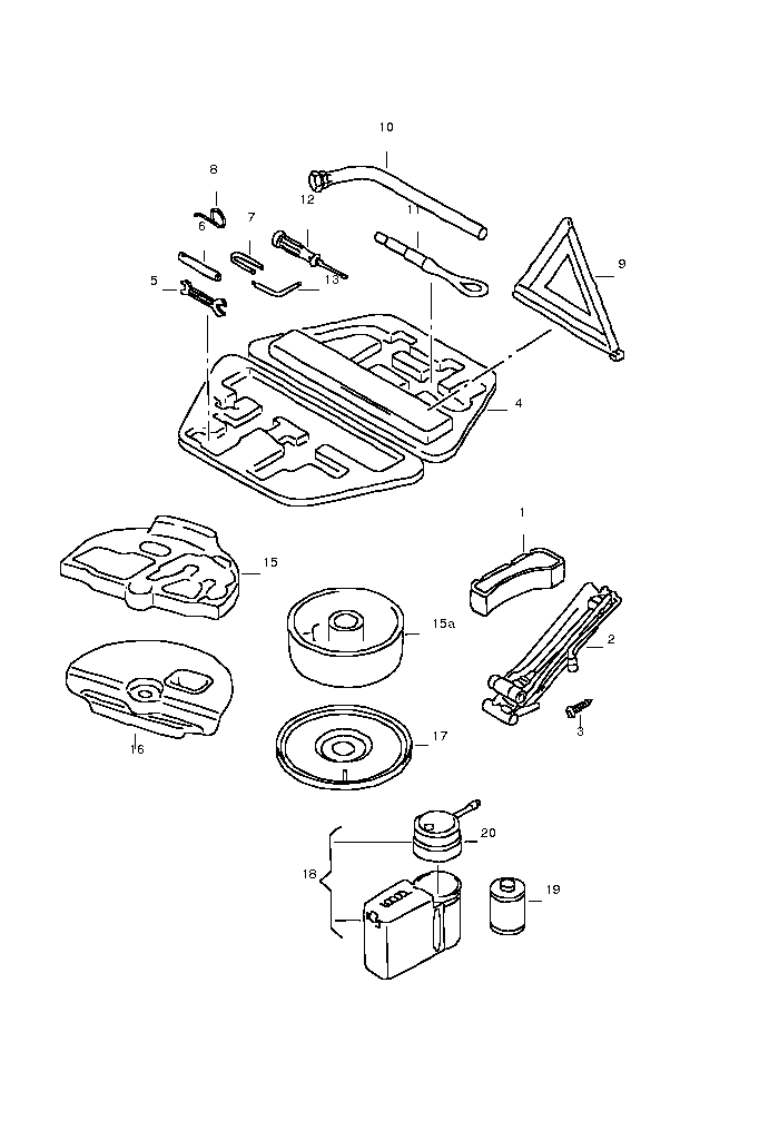

Old 1st July 2013, 10:29 AM
looks like either item 15 or 15a (sorry to be a bit vague but audis descriptions are a tad confusing -
15 - 4E0012109B tool box / for models with breakdown set
15a - 4E0012109A tool box / mounting for trailer coupling ball
16 & 17 are their respective covers -
16 - 4E0012116A cover for spare wheel well with tool tray / for models with breakdown set
17 - 8L3012116 cover for spare wheel well with tool tray
