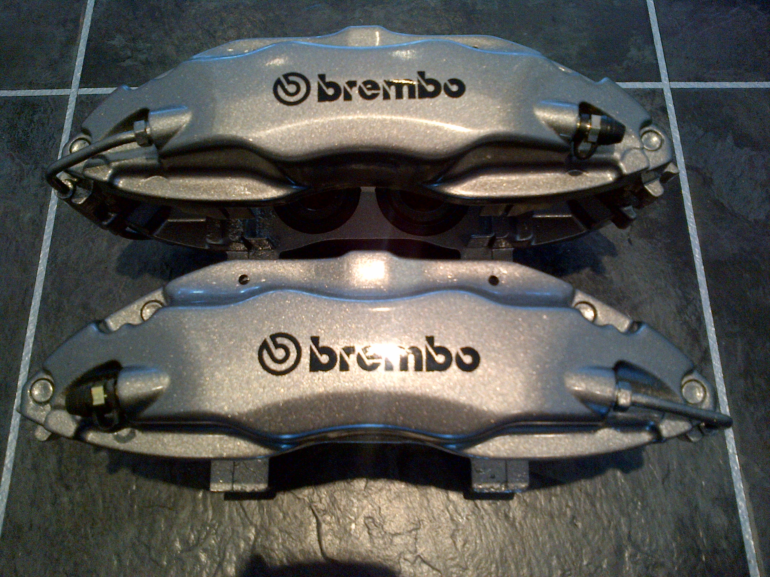

Cool Pretty. huh?
They've stuck one of the brembo decals on a bit wonky, but not sure it'll notice once it's on.
Downside is I'll have to wait a couple of weeks before fitting them.

What was the cost for the refurb? Did they change the pistons,seals and that funky little plate that is screwed on(the one from my recollection fu*** everything thing up due to corrotion from road salt and so on)

There are options, but I went for the whole lot:
strip, clean, regrease, remove corrosion, reassemble: £144
all new seals, rubbers, blead nipple etc: £39
paint (with 2 year warranty): £115
Brembo decals (high temp vinyl): £15
5 year warranty on caliper function apparently - pretty good.
Not cheap overall, but a helluva lot cheaper than 2 new calipers, and look prettier (IMHO).
They removed the 4 plates you mention (with heat), then grinded out the corrosion so that they lat flat again, painted, straightened the plates, and re fixed. Didn't need new plates (they're stainless).
