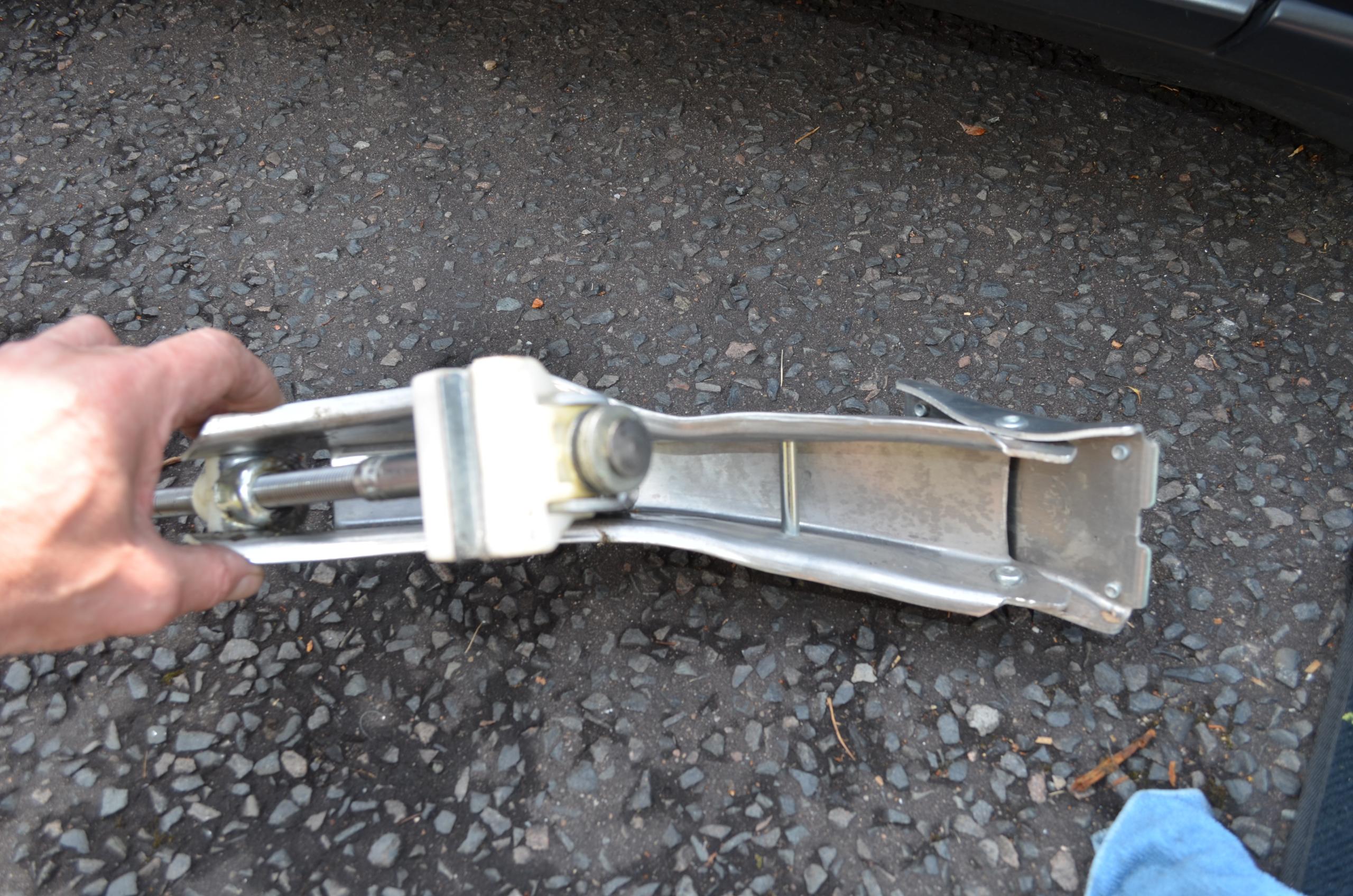

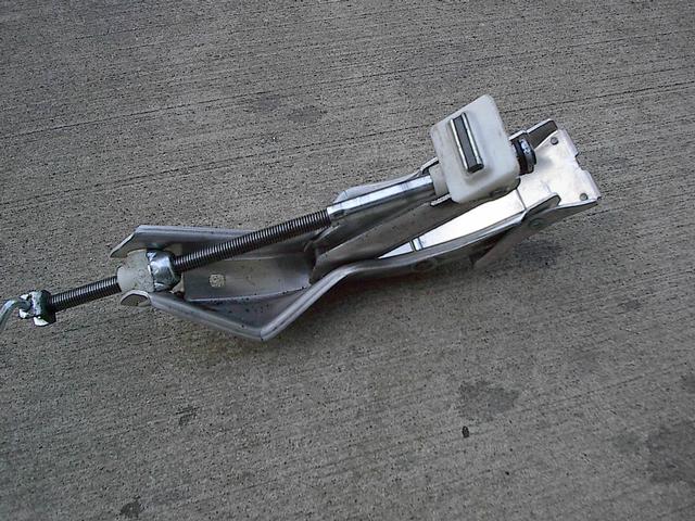

Hey just looking at your photo's there David and that jack that folded on you is different than mine, are the jacking points different on the FL than PF or that jack you have is from an A4. The jacking point has some steel in it and the locator on the jack has a magnet so it's easier to keep it in the jacking point. Not that it makes much difference as the 8 ones fold aswell, but i don't think that's the jack for the car.

The reason i used the SAAB jack was the 9000 is similar in weight to the 8 and it has a flat surface on top for bolting your locator to, i did have another but i think it came from an Astra so didn't thnk it would be up to it. Just be careful brothers, don't make the same mistake Audi did.

I think that the body is the same but I can see that the "groove" which positions on the jacking point is continuous on mine but shorter on your jack. The jack is (was!) rated at 1000kg. Jim has kindly let me have his old jack as he has the up-rated version which looks more substantial.

Thats what made me think that jack was not for the 8, the 8 jack dosent have a groove it actually protrudes out and sits inside the cup on the underside of the car, the part that is gray and looks like a groove is the magnet.

David, are our/your 2 jacks identical? If so, it's highly unlikely that we both had the wrong jack isn't it?
Old 18th July 2013, 08:14 AM
The jack I got from Jim is exactly the same as mine (with the groove in the top) and the part number is the same - 4DO 011 031D. It also conforms to the pictures in the handbook. With the FL the jacking point is a ridge on the sill adjacent to the jacking pad point used by 2-poster lift arms. The handbook identifies these both quite clearly labelling the pad as "Jacking Point for Workshop Lifting Platform" and stating that the vehicle jack should not be applied here. So it would appear that there is a difference in jacks and jacking points between PF/FL.

My late FL jack looks (if my memory is working) very much the same as my PF one, and I wouldn't ever use either!
Part number stamped on it is 8D0 011 031C, which may actually be from an A4?
No magnet, just a big nylon lug with a groove in. Rated 1000kg as usual.
Old 18th July 2013, 08:24 AM
Ah right then there you go, slight difference to design between PF and FL.
So it was a redesigned jack that was as rubbish as the one it replaced. Well at least the designers were being consistent.
