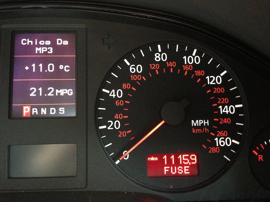

Got FUSE on odometer today. Car is FL 2002.
It went away when I pressed daily trip reset button "0.00"
...Have no idea what it means...

Check the fuses. Our A6 shows the same message when I remove fuse for instrument cluster when flashing ECU.

Engine ECU on A6. Many VAG cars need instrument cluster fuse to be removed when flashing ECU, don't know why but that's just the way it is. The general rule is if it does not flash with fuse, remove and see if it helps.
