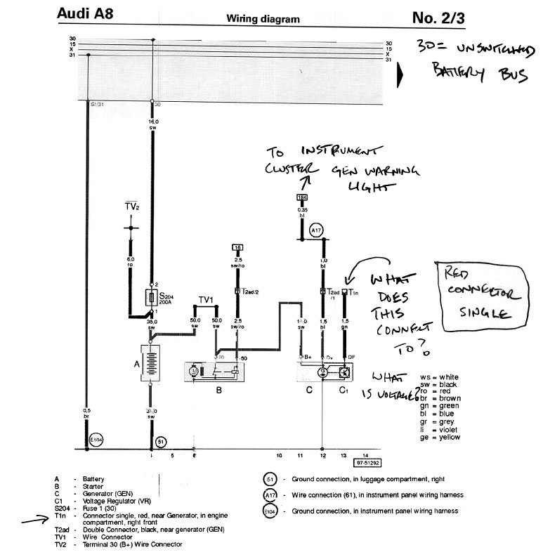

Hi Ainars, the stock regulator adjusts voltage fine, but this happens on alternator poles. For instance, voltage on alternator of my car is 14.2v -- tip top. But on battery poles I have 13.8v -- God knows where the voltage drops on the way to battery. What I want is to have 14.2v on battery poles.

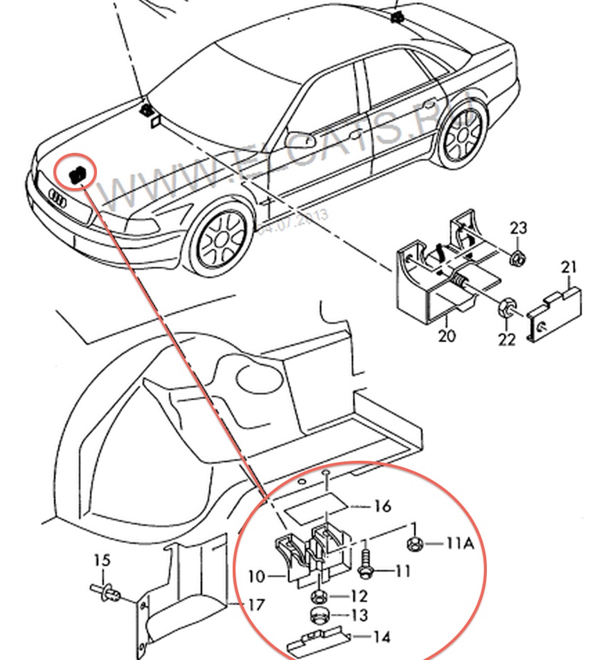

Goran, yes distribution point on starboard side in the wheel arch is classic place for corrosion:
But on my car that place is fine -- I have checked it. Voltage drop on my car is elsewhere.
Here is electric scheme:
TV1 is the box in the wheel arch.
But if you look at 'TV2' you will see that whole Terminal 30 is connected to battery, so God knows that draws current from there while engine is running. I'm sure that voltage drop comes from that part of the scheme.
Old 5th September 2013, 08:13 PM
T1n goes to switched +12V and is used to supply current to rotor of alternator through the voltage regulator.
