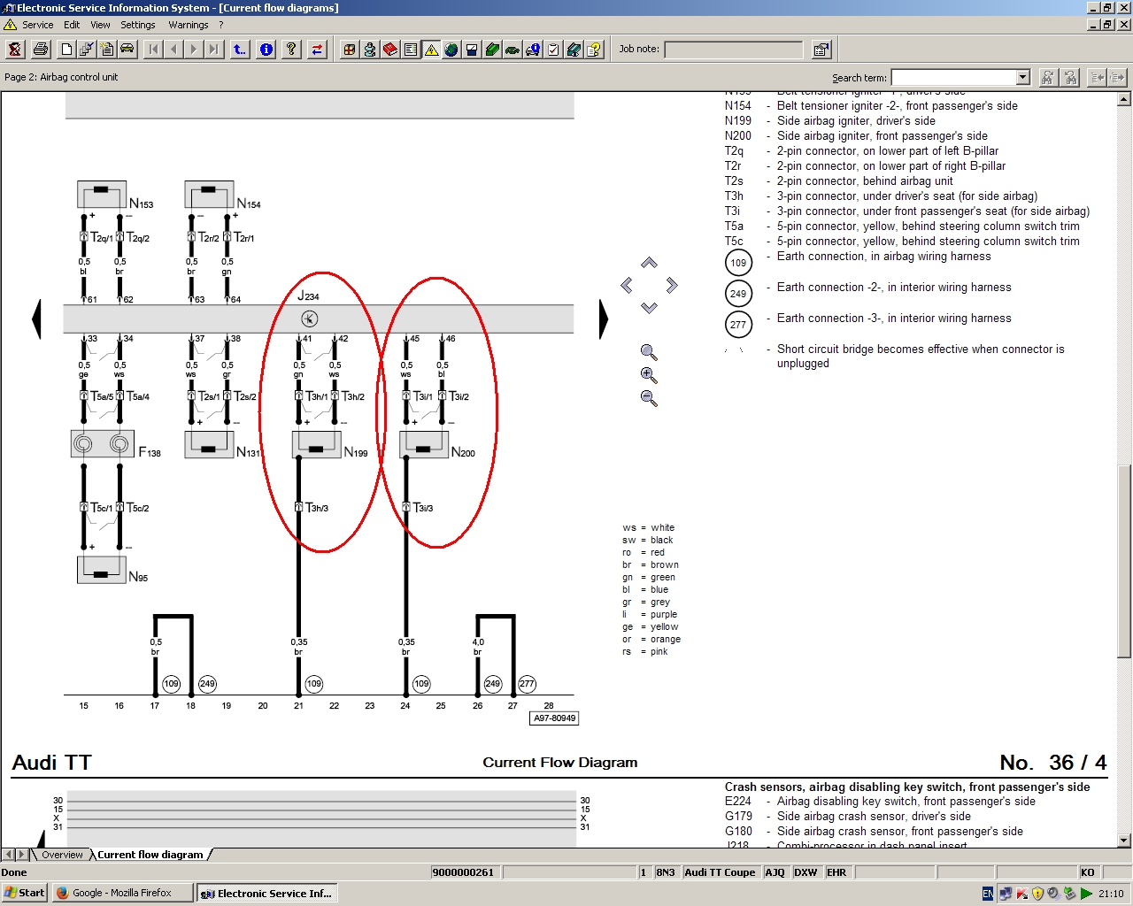

Does anyone know why the front seat airbags have 4 wires, two of which are brown.
The TT seats I bought have only 3 airbag wires, only one brown wire.
On this diagram (for an S8 apparently) it shows only 3 wires for the seat airbags? Or maybe the ones I circled are not the correct ones?

Old 12th July 2013, 03:11 PM
Posts: 3,854
The ones you circled are head(curtain airbags) not the seat airbags. Seat airbags would be the ones on the ones on right side with only 2 wires.

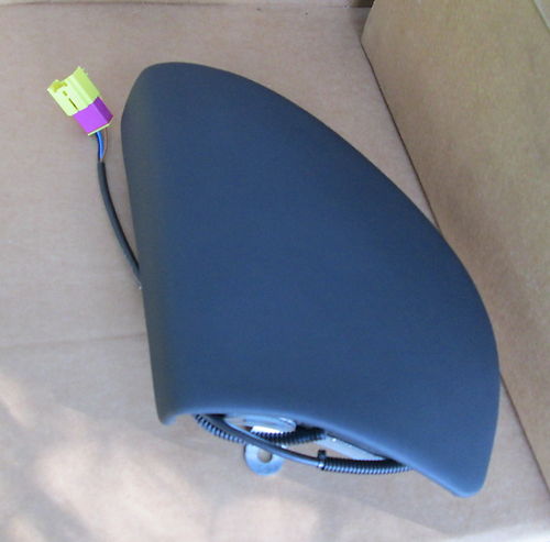

Name:	TT Airbag wiring.jpg
ID:	6762   Click image for larger version
Old 1st October 2013, 09:32 PM
ELSA is very accurate with wire colours.
On screenshot I see wire colours BEFORE connectors T3h and T3i. AFTER connectors colours can be different.
All connector pins are usually clearly marked on connector itself. Use those pin numbers for guidance. For example: T3h/1 means pin number 1 of connector T3h. Just find pin number 1 on the actual connector.

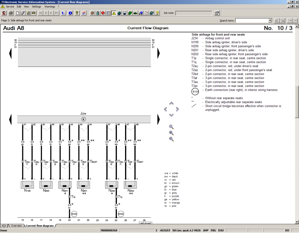

Name:	S8 Airbag note.JPG
ID:	6779   Click image for larger version
Name:	A8 seat aribag wiring.jpg

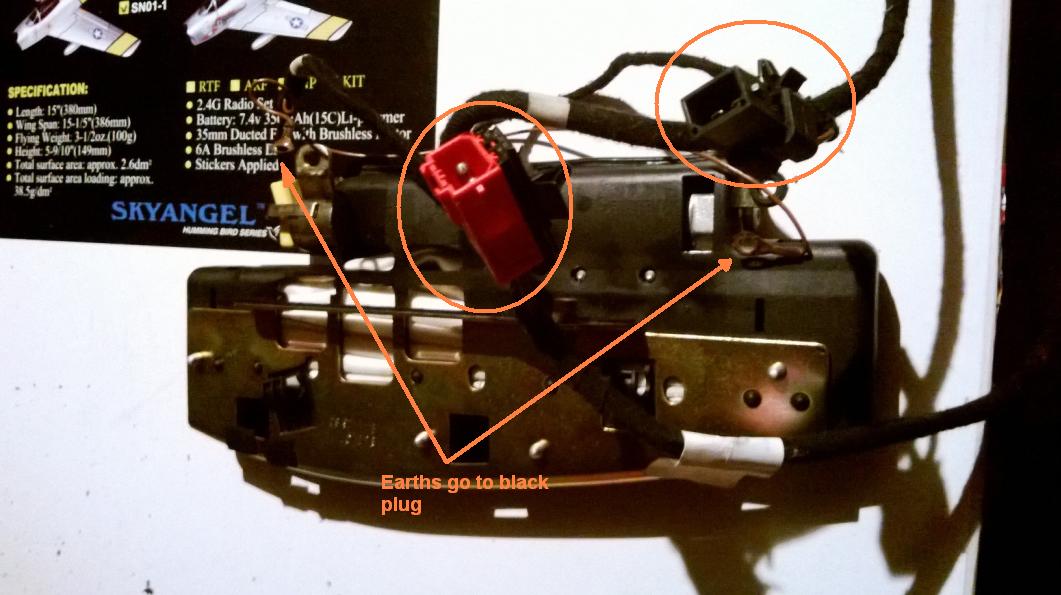

Old 2nd October 2013, 10:47 PM
>> its the black plug from the airbag, that just goes to the chassis?
Sorry, I stopped understanding what picture means what. Picture with airplanes in background is D2 seat or TT seat?
What is this picture again? Part of TT seat?
Two ELSA diagrams are clear to me.
If we assume that picture with airplanes in background is D2 seat, then red 2-pin connector should be T2ay or T2az according to last ELSA diagram provided. It has two pins and it is red colour.
Then we have some earth wires on the picture, but it is not clear where they come from.
I appreciate earth wires go to black connector. I have no idea what black connector is. Black connector may not be relevant to airbags system.
Old 3rd October 2013, 11:19 AM
Sorry, I forgot to label the pictures. The airplanes picture is the D2 airbag.
sorry, bad quality picture, it has two brown wires to bolt to airbag casing, and these are spliced into the airbag loom, but have a separate black connector.
I may need to confirm with A8 parts where this goes in the car.
The confusing thing is that its not in the Elsa airbag diagram, even though wires bolt onto airbag.
Maybe as you suggest its just earthing wires, and maybe they are represented in a different Elsa diagram.
Old 3rd October 2013, 11:34 AM
Is black connector a single pin connector? If yes, it should connect airbag's local earth with global 'big earth' of the car chassis. Just like T1p or T1q connectors on D2 ELSA diagram.
