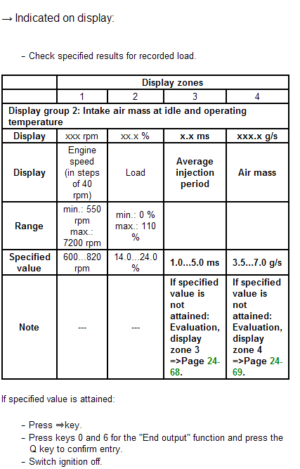

Elsa suggests 3.5g/s to 7g/s is fine, but thats for a S8.

Looking at it today the MAF was almost new in appearance and all seems to be in order.
So therefore if the MAF is OK then perhaps the torque converter fault code is correct.
Time to just drive it and if it dies then someone can have it for parts.
