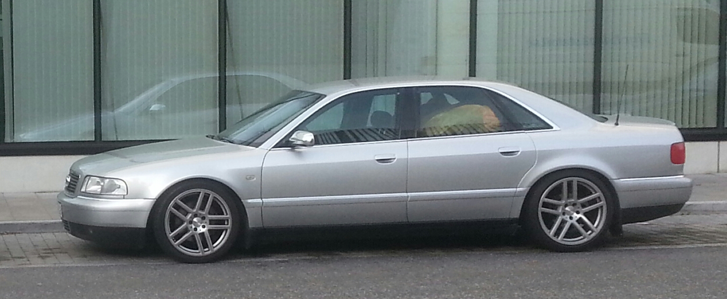

Attached pic of my car in it´s current state, wheels are Kleemann DS-5´s

Old 22nd November 2013, 06:24 AM
Cheers pal
I like the ride height on yours and wheels are nice as well, haven't seen them before.

Ride height visually looks fine But it´s harsh and scrapes on everything taller than a crumb of bread.
If it´s to high on stock springs I will problably go with some progressive lowering -25mm springs like Eibach.
By the way.. Can anyone explain the differance between Pre facelift and post Facelift suspension ? Looks like all components are the same by the "spindle" where the wheel sits is higher on FL cars ?
