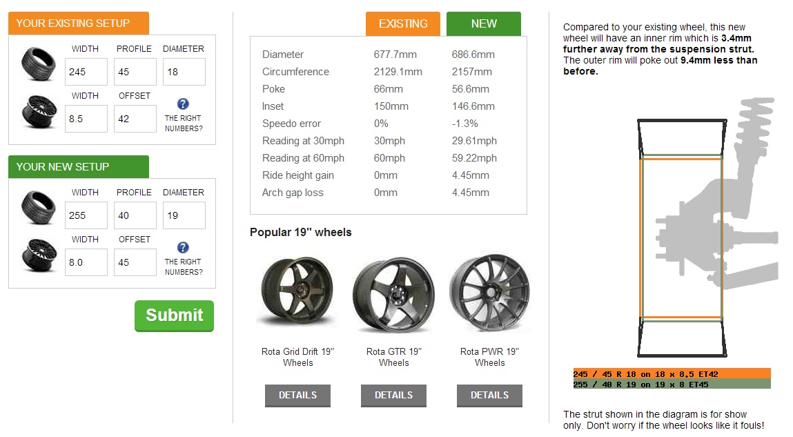

Tyres on the D3 are 255/40 19 on standard multispoke (lots) alloys 8.5J x 19 ET45
Tyres on the D2 are 245/45? 18. (the standard size) on a 18x8 ET42 wheel (5x112 PCD)
Manny

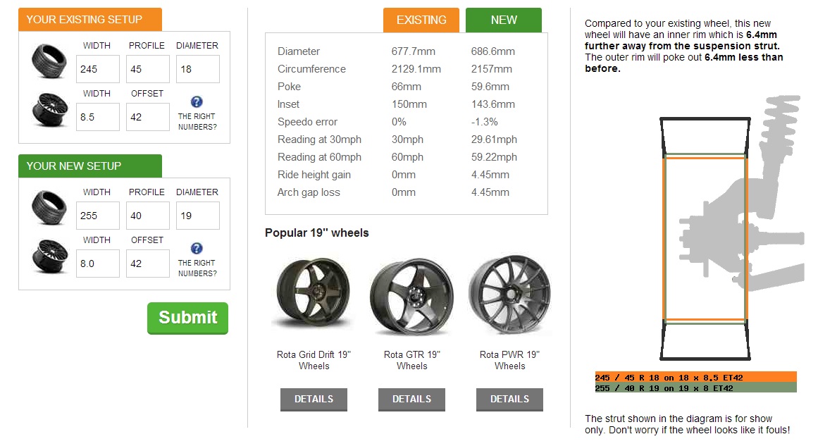

Old 2nd December 2013, 04:11 PM
Looks like they are pretty similar overall so you just need to check the internal clearance by comparing the caliper sizes on current and new cars and the current clearance to make sure they will be clear but I'd bet on them being fine Manny

Neil, the 19s are ET45 whereas the 18s are ET42. Both are ET42 in the picture above.
Manny

Old 2nd December 2013, 04:49 PM
still not made a huge difference!
