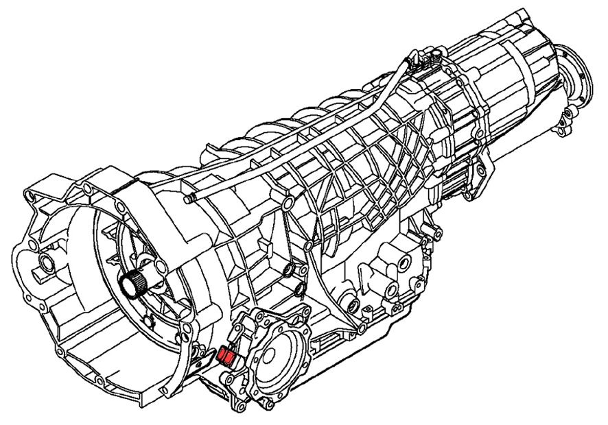

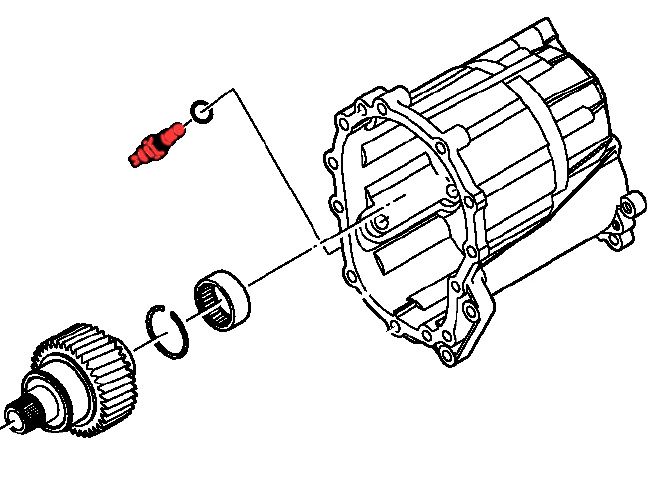

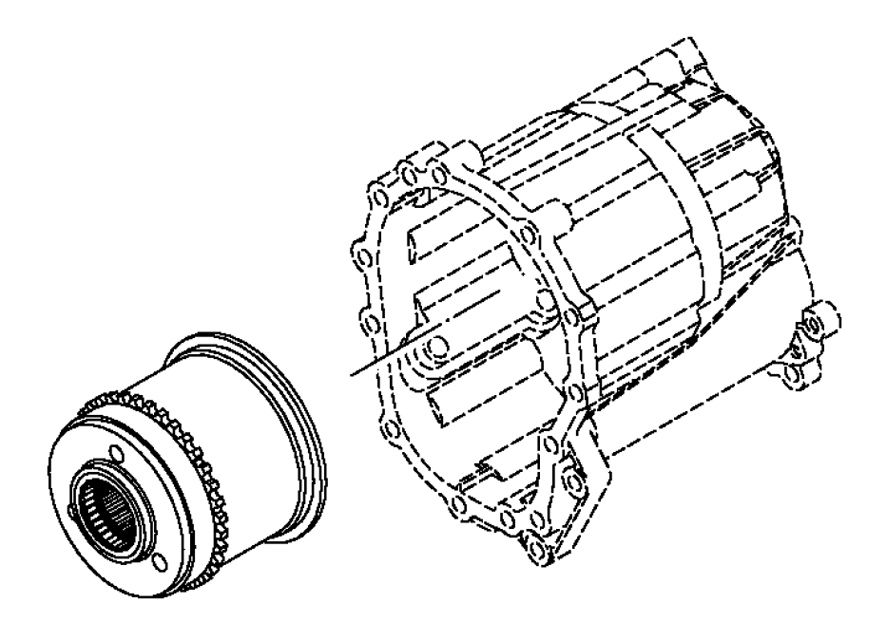

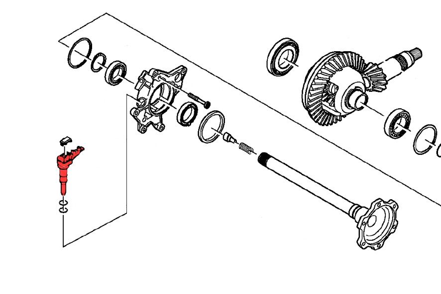

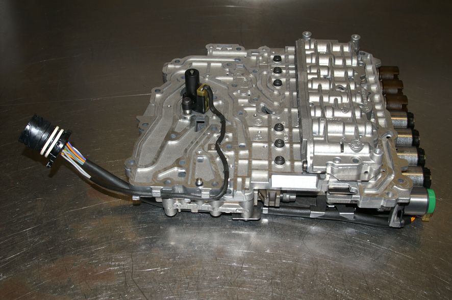

The transmission output speed is taken from a target wheel on the Torsen unit carrier by an inductive sensor.
There’s also an output speed sensor on the LH front driveshaft but I assume that’s for the speedo.
Unlike the 5HP24, the wiring for the output speed sensor of the 5HP24A is separate to the main transmission wiring loom i.e. it doesn’t pass through the 16-pin connector.
The input (turbine) speed sensor sits on top of the valve block assembly, of course.
Phil
